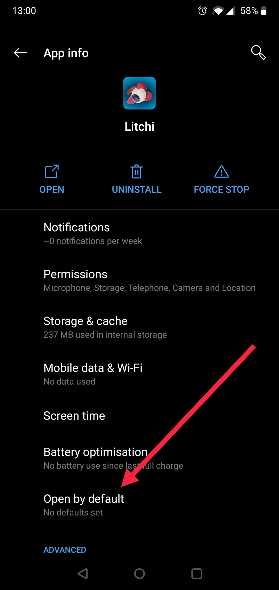

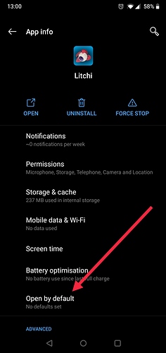

And I have never set phones or tablet to use Litchi as the default app.
Clear “Open by default” in Litchi app info.
Then, when you connect the RC, it will ask which, of all DJI RC connectable apps, you wish to use, and select “Once only”.
