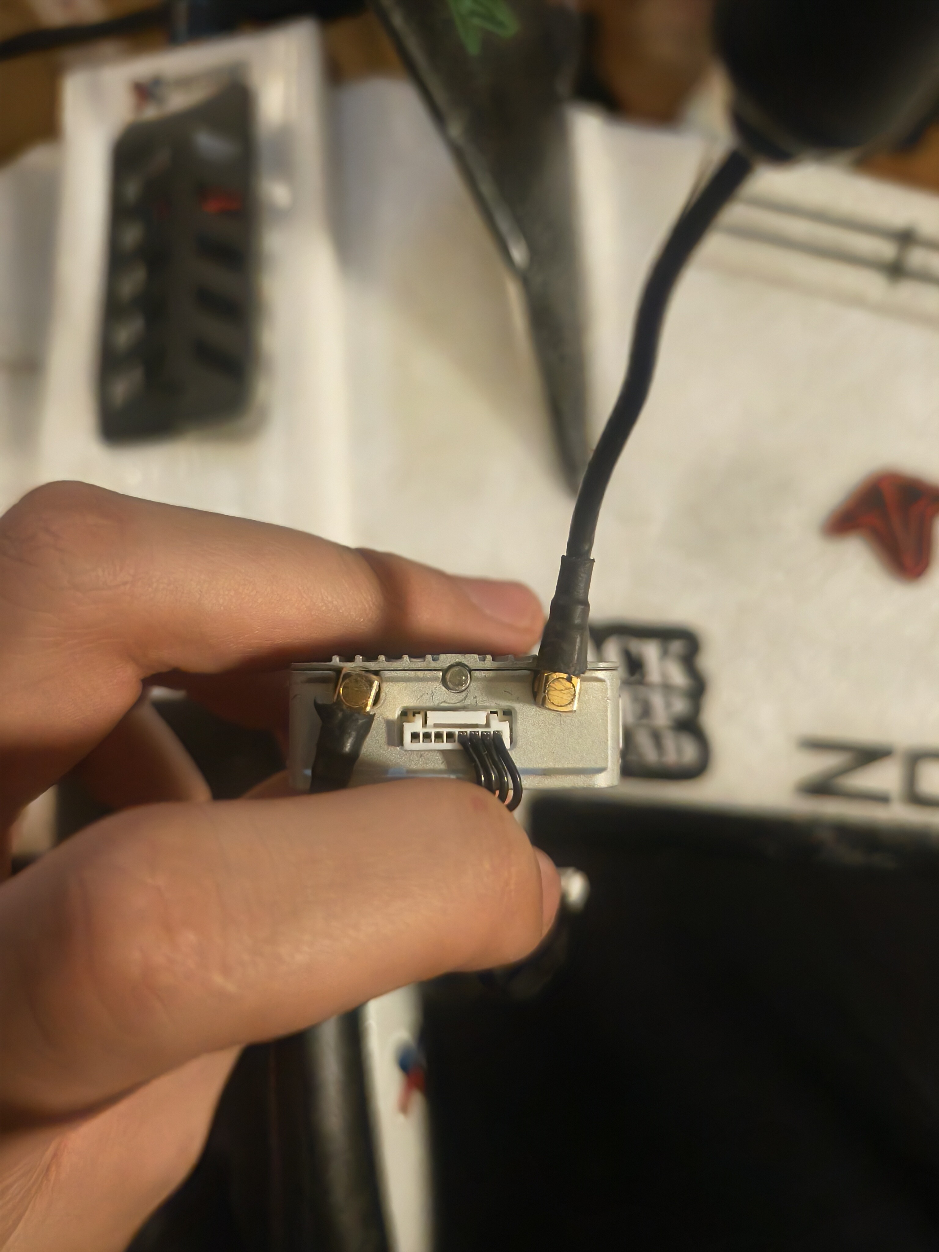

I recently got a second hand ZOHD dart 250g. Speedybee easy fly FC. Haven’t gotten it up in the air yet.
Is it compatible with the original DJI 01 air unit? The super fat bulky one. I read that it might need soldering but don’t have anything solid. I’ll attach some images.
I tried connecting it with the plastic connector but it doesn’t seem to work.

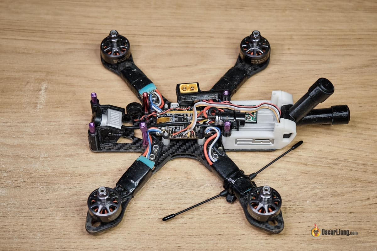

Have a look at this

I use a speedybee with the original Dji Au. 100% compatible. Use the speedybee plug and solder to the Au harness. +V Red. Grey And white are video signal to FC. Connect Tx To Rx on the uart. Yes they reverse. No damage if you do that part wrong. Just won’t work. The Yellow wire is not used. It is the control link wire if using a Dji Tx. Black and Brown to ground on FC. The Brown wire appears to make little difference if not connected, but officially it should be.
