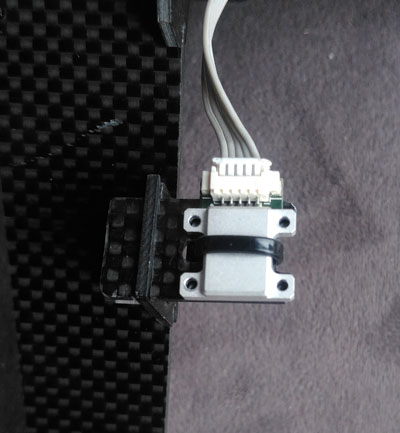

The dangling compass is marked in this frame-grab, and as it should be fixed in the other two photos that I’ve just taken.
IMG_20180613_200950
IMG_20180613_201002
