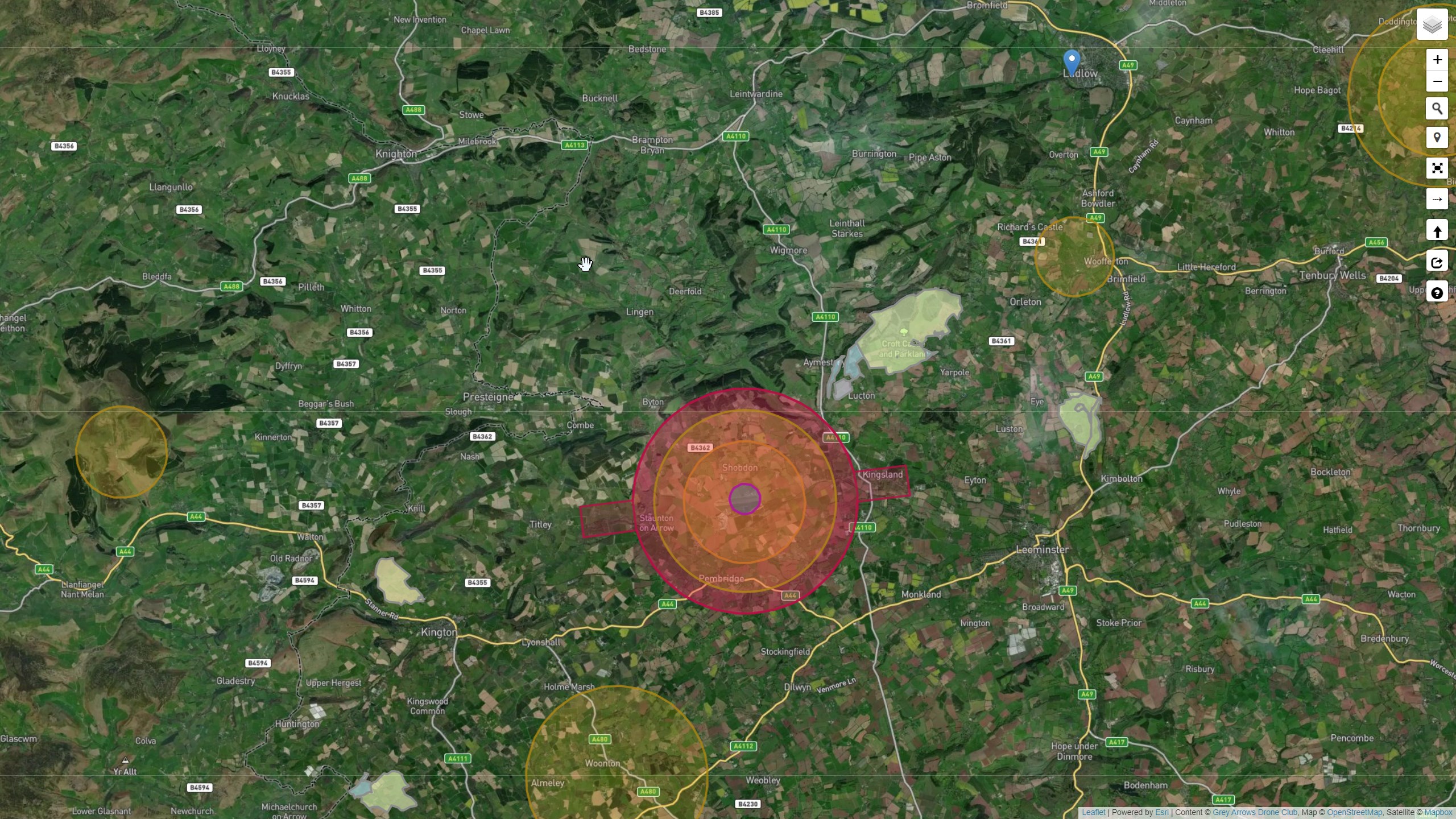

I typically try to stay away from FRZ I’ve never flown in one, or had to ask permission, however I’ve found a location & I’m wandering how I contact the airport if that’s who I need to contact / speak to,
Thanks in advance.
I am sure someone with more experience will reply.
But don’t be concerned.
They will work with drone pilots.
You just need to email in advance, maybe fill out a simple form, call the tower before take off and also when down.
They do not bite and are very friendly.
The only issue is often finding the right person!

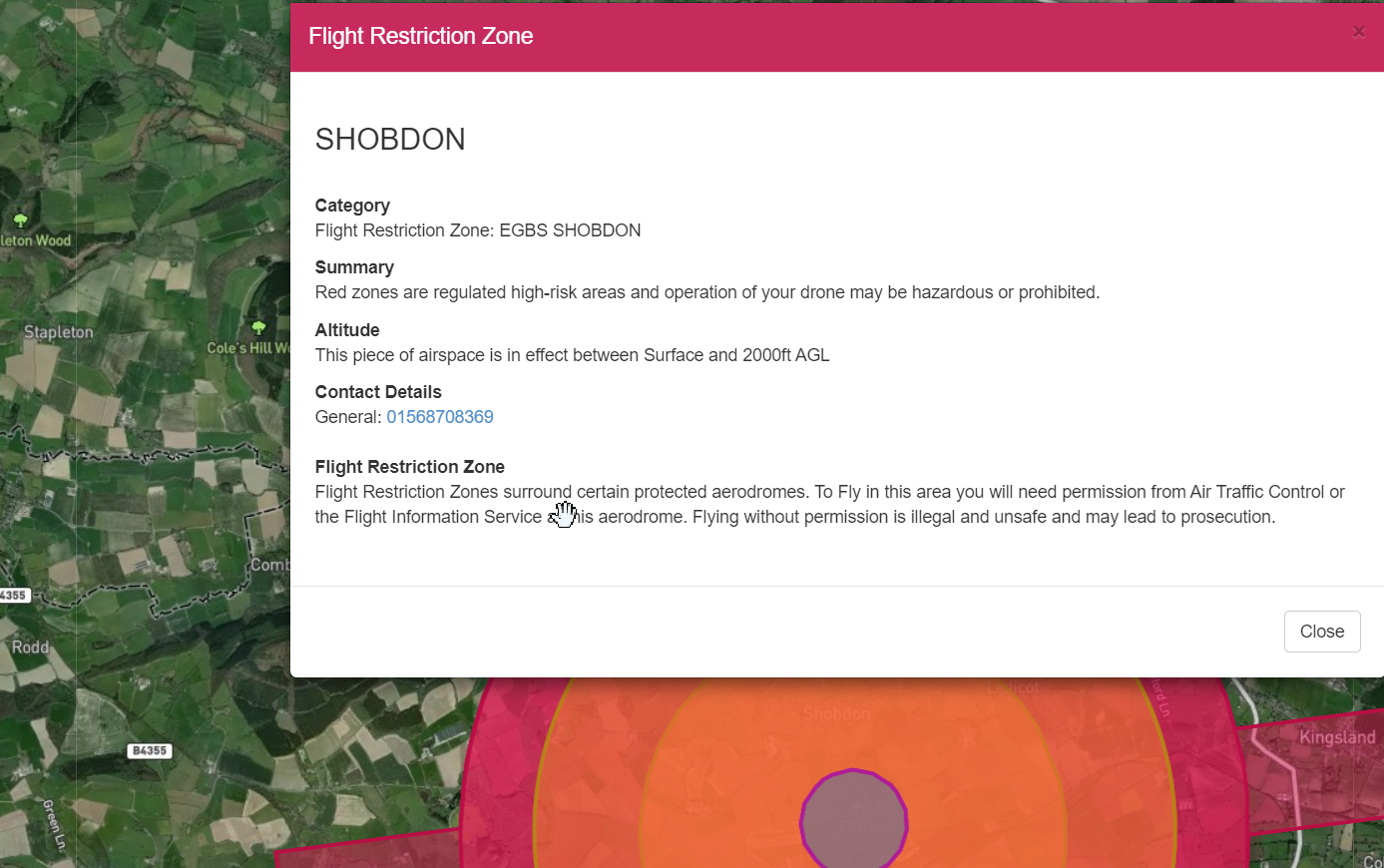

Drone Scene can be your pal here - as it should be for every flight planning need.
Here is a Shobdon airfield from the Drone Scene Map:

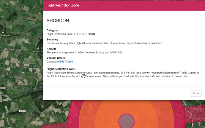

Now zoomed in and clicked on the red airfield marker. That brings up information including, in this case, a contact number for Shobdon - give them a ring and explain what you want to do. They may take details over the phone or be a bit more formal and ask you to email or to fill in a form on the web.
Things they will want to know:
Potential times and date of flight (Give yourself a four hour window)
Centre of the flight area - latitude and longitude - Drone Scene will give
you that,
Radius of flight area
Maximum altitude you intend to fly
Type of aircraft.
On the day:
Ring them on arrival and state a more accurate flight time
Keep to the agreed plan (They may well be able to see you - visual or radar!)
When finished ring them to say that the exercise is ended and make sure to thank them - that makes it easier next time you fly in their FRZ!
Thank you
I’m not sure if it’s because I’m on my mobile but can’t seem to get contact details :grimacing:
Edit it’s ok I’ve got it I had to many layers turned on, thank you

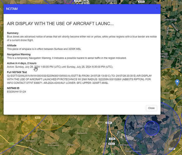

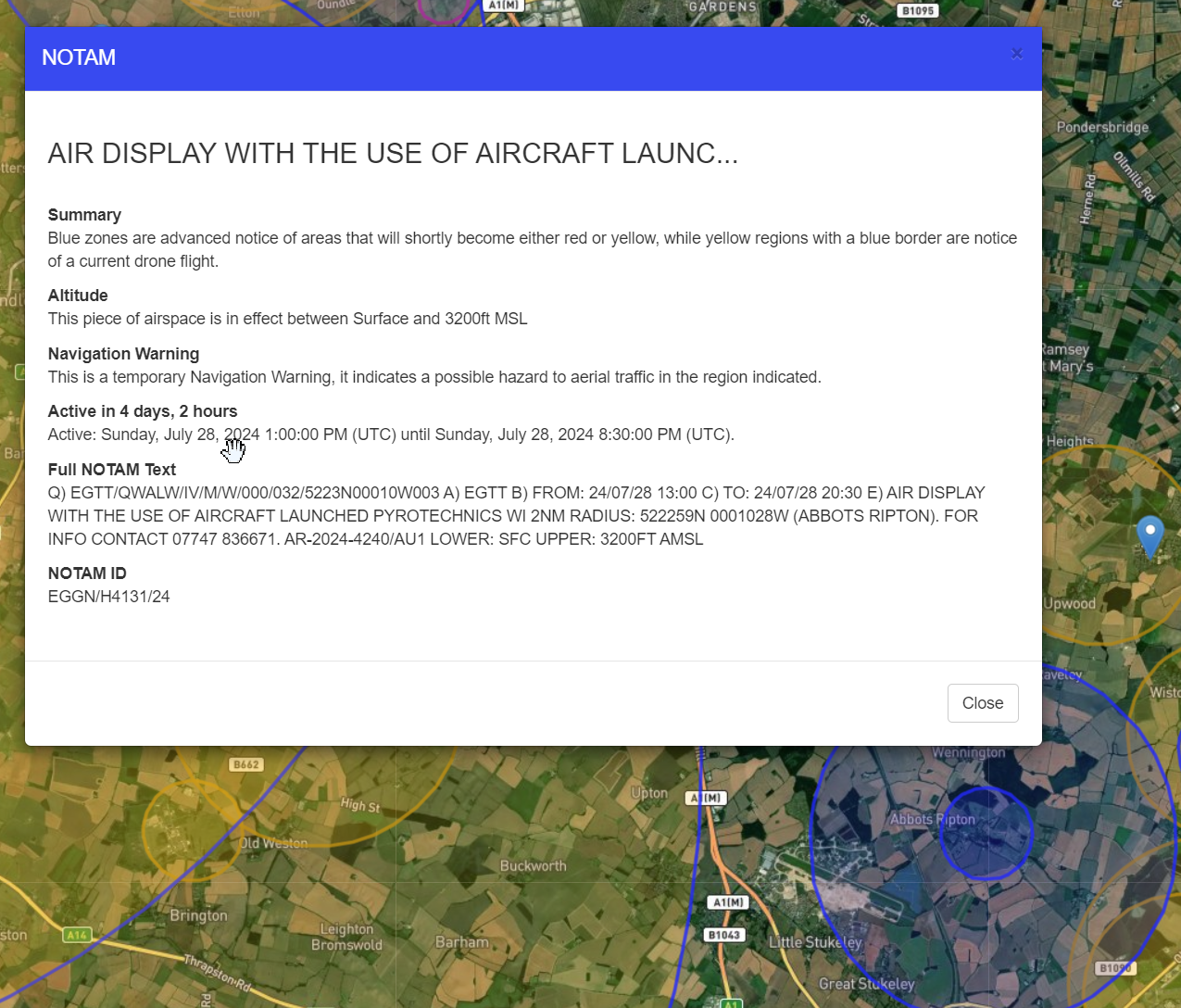

Again, Drone Scene is your pal in flight planning. NOTAMs automatically appear when they are announced, a few days before the flight restriction comes into force. Then disappear as soon as the restriction is lifted.
Why is the NOTice to AirMen in force? Click the NOTAM layer and find out!
