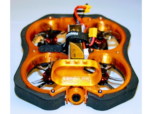

A while since this was posted. I’ve just grabbed one of these kits from UMT - looks really neat, and still a bargain atm. Would you happen to have a link to the STL file for the frame? I’d like to have a go at printing and modding a spare. Thx. :+1:

https://drive.google.com/file/d/1CqPCFexc8AU04gU8cDXZc2RR14PMDJJ3/view?usp=sharing
There’s a the STL mate
Magic - many thanks! (The link share isn’t turned on though so can’t access it atm) :grin:
Changed the sharing settings
Ah - smashing, I hadn’t searched for Cine8 on Thingiverse… seems there’s quite a few add ons for it too. Looking forward to playing with this when it all arrives :sunglasses:

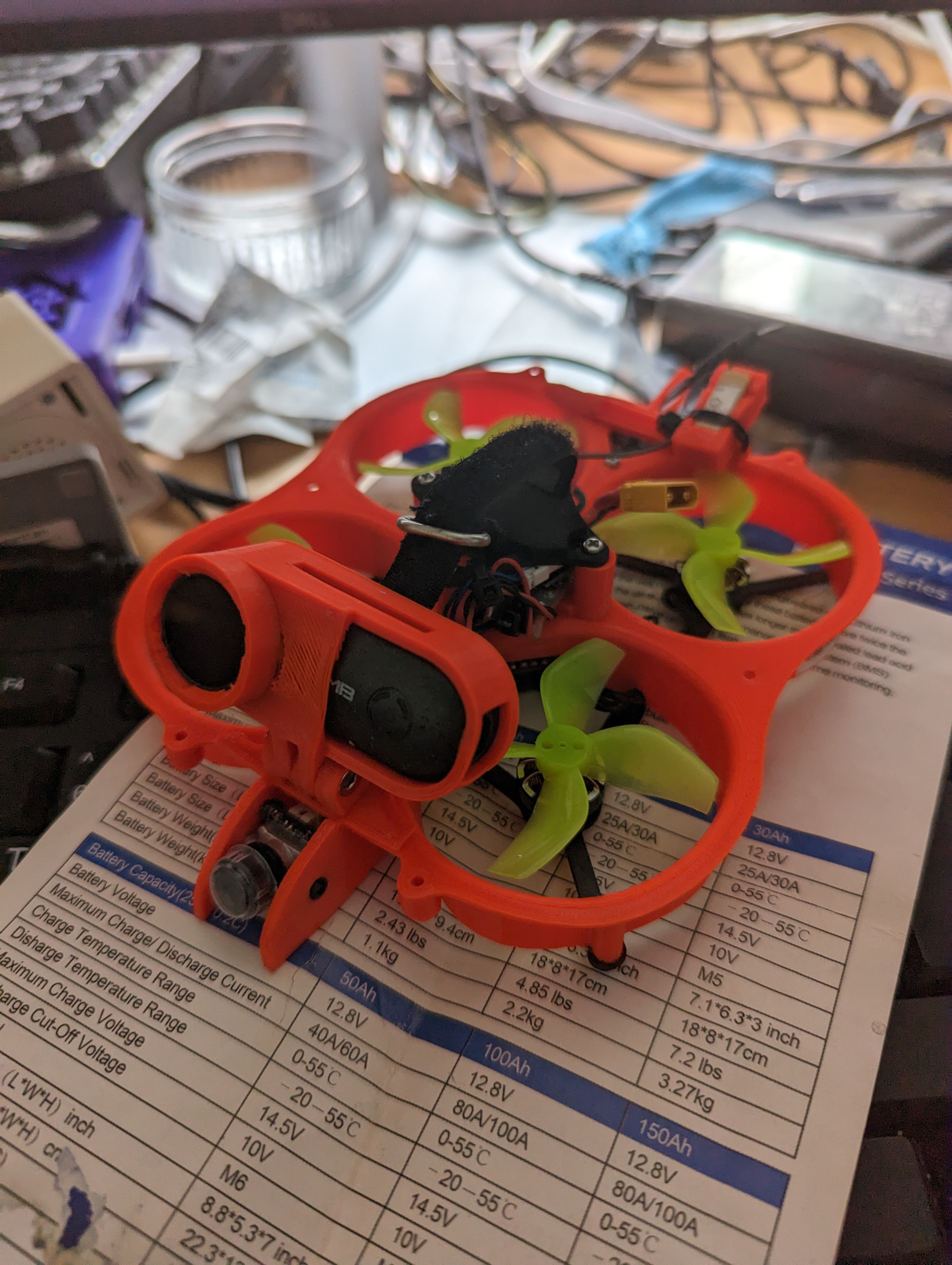

No worries, tbh it’s one I need to get back in the air. I think it’s OK tbh, just not flown or played with it for a long time. Time to make it lighter :slight_smile:
This is how she looks at the moment!
