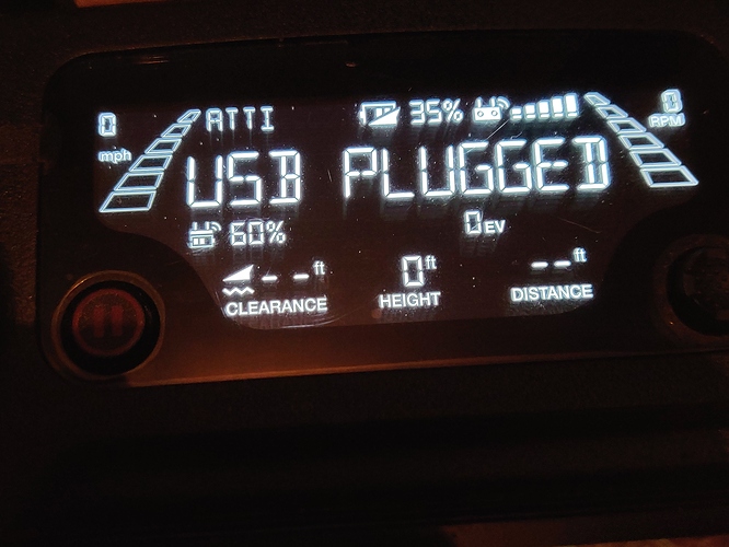

And even more baffling when, with the RC and a phone connected (in the normal sense), the MP is blatantly aware that there’s a USB connection active!
f4509a58edd734a339fada266dded8227189fa65_2_666x500
