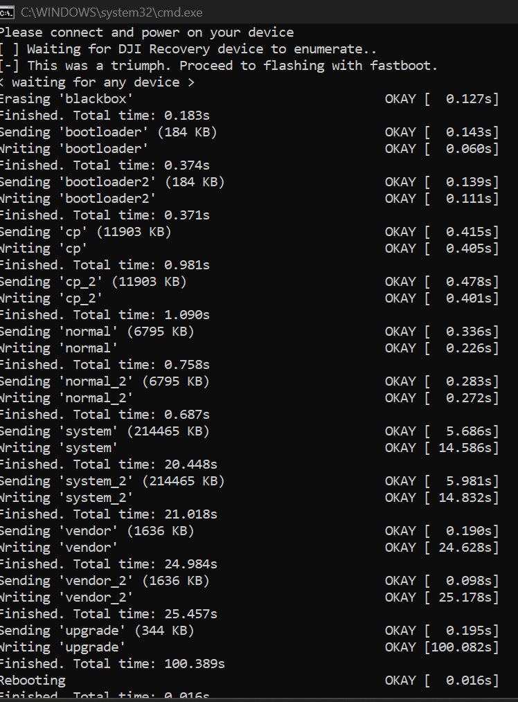

I’ve tried everything to reflash these with Butter, everything seems ok while it’s flashing but once finished it just reboots into the above. Downloaded all the drivers they recommend tried different cables and still the same.

Im starting to think these are bricked as iv ran the run me bat recovery software which seems to work but my goggles are still locked in Dji fpv mode. I think the only way forward is to find someone who has a Dji fpv and try and connect to it and hope the option to roll them back in the menu popos up..
