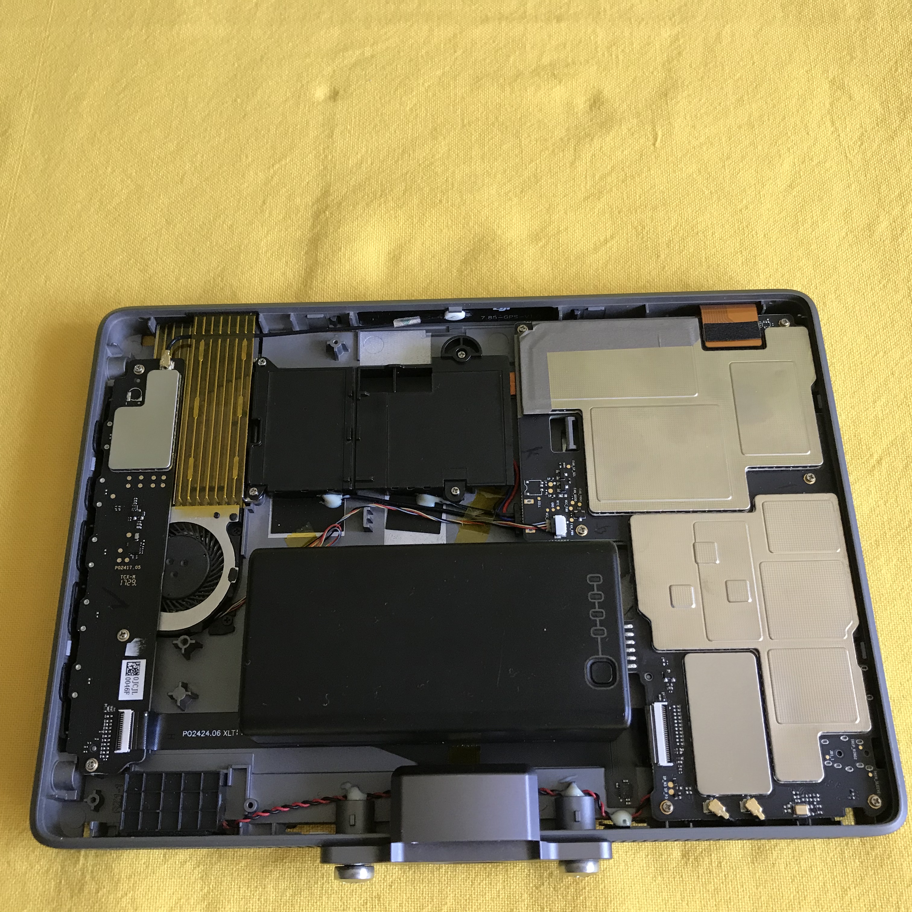

The ambient temperature was around 29C, my Crystalsky with the firmware update to stop it overheating didn’t work.
I got no video recording of the late afternoon, which :rage:
I missed this…
I got home straight to dissect the Crystalsky.
The shielded parts hit 39C which seems to shut the screen down.

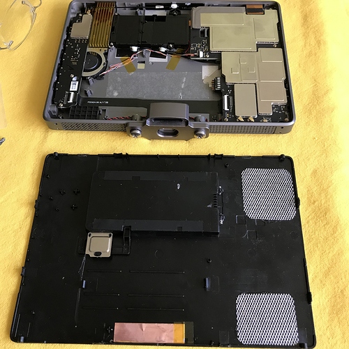

First I removed the front bezel, ‘wrong move’ replaced it and removed the rear bezel. It wasn’t too difficult to remove but I took care not to break any of the tabs.
Got the drill out…added some mesh…
Next update, mounting the cooling fan and testing.

@PingSpike at least I now know the internal fan kicks in at 28C which is still way too hot.
While it’s in bits just hard wire the internal fan permanently on.
Only masking the real issue though :confused:
The fan is at the opposite side to the shielded parts that are getting too hot and also that tiny fan just vents straight out through a heat sink fins, it doesn’t circulate air anywhere else.
I can live with this hack as long as the screen doesn’t continue to shut down every 5 seconds.
