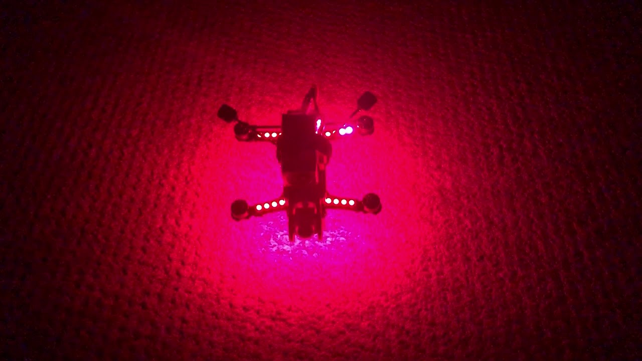

I finally got round to adding some light to the Cygnet…
32 in fact (it’s a bit bright)

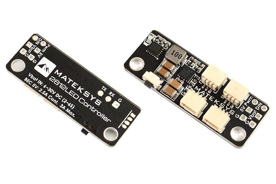

What flight controller do you have? - Betaflight has a hard limit of 32 controlled RGB LED’s
You could use one of these to go beyond that…
They don’t have the versatility of Betaflight LED control though - but can be powered direct from the Battery :+1:

Oops, maybe I got a little to close to Daves’ Cygnet… :rofl:
F@ck me! That disco flashing was mental. And now your lipo is flat lol. Nice. Love it!
Hoping it doesn’t affect it too much, (I can turn them off and on at will :wink: )
I’m charging everything up now - hopefully going to test this a bit later :+1:
Worried it may attract a bit of attention :man_facepalming: :rofl:
Well I managed to get out in between rain and wind - the Led’s didn’t affect the battery life in any noticeable way :+1:
I was struggling a bit with numb fingers - it was 1°C
Very impressive Dave, only problem is the local wildlife are now rubbing their eyes, wondering whatthefuckwasthat… :grinning:
Aye - I did the last flight LOS after the MM had landed - it was too dark to see via FPV - I did all the colour testing whilst doing punch-outs - it looked like a UFO / mad yo-yo :rofl:
