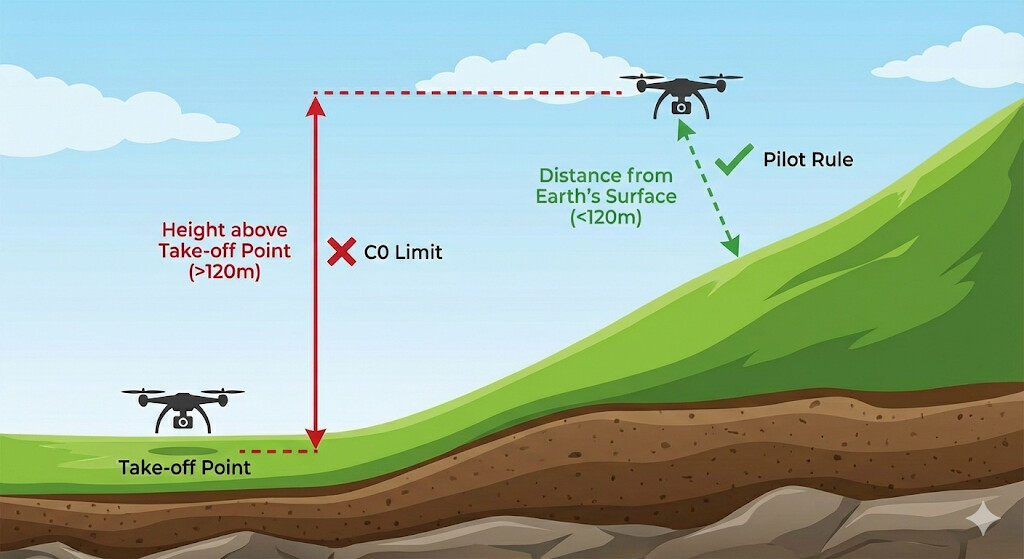

This can be useful if you are flying up a hill.
As you can see (courtesy of AI), if you flew up a hill, you might still be within 120m of the ground but you might be more than 120m above your take-off point.
Therefore, the Air 3S gives you the freedom to legally climb a slope staying within 120m of the ground, whereas a C0 drone would hit a hard limit and refuse to go any higher.
P.S. Only the image was courtesy of AI; the rest was written by me so, hopefully, it is not full of inaccuracies.
