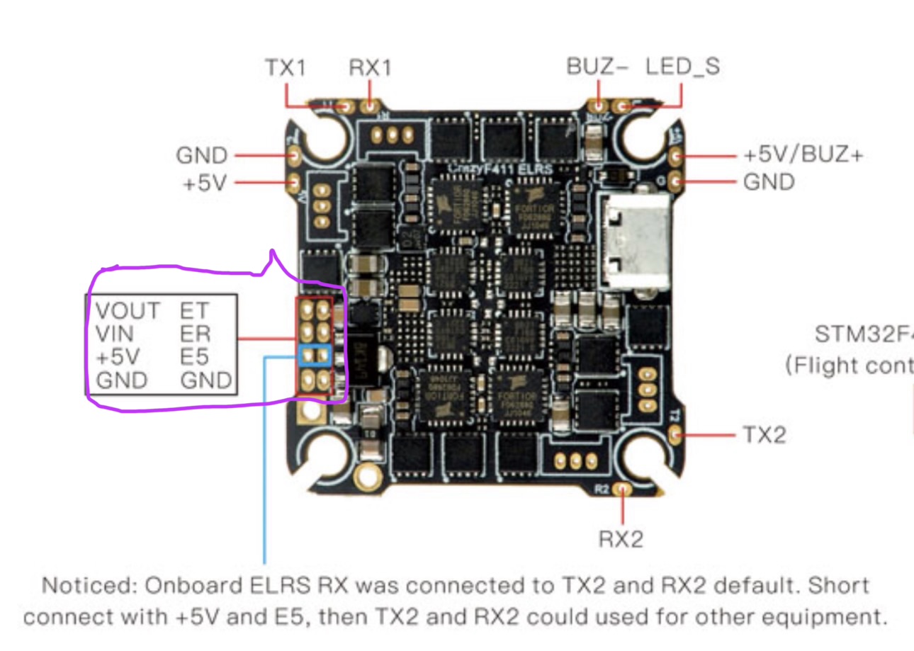

Just started my first analog build and a little stuck with the vtx. Iv soldered to the video out pad and set up in my goggles but no pic as yet..
So was thinking is the pad at the back of vid out “ET” something I have bridge?, not really understanding what the ET tab is for ???.

Which FC is it?
Hey Steve, yes to 5v and yes to same band but not sure about enabling analog in BF what’s that under???

https://www.happymodel.cn/index.php/2023/02/07/happymodel-crazyf411-elrs-aio-4in1-flight-controller-built-in-uart-2-4g-elrs-and-20a-esc-for-toothpick/

Is this any help?
The Happymodel CrazyF411 ELRS AIO integrates the flight controller, 20A 4-in-1 ESC, and UART ExpressLRS receiver, requiring minimal wiring for core components.
Power and Motors
  • Input: Connect the battery to the main power pads (VBAT+ and GND), supporting 2-4S LiPo batteries.
  • Motors: Solder the four motor wires to the angled motor pads on the 4-in-1 ESC section.
Video Transmitter (VTX) Wiring For analog VTX units, the wiring uses specific pads to utilize SoftSerial, as UART2 is reserved for the ELRS receiver:
  • Power: Connect VTX 5V to the 5V pad and GND to the GND pad.
  • Video: Connect the VTX Video Out to the VOUT pad.
  • Control: Connect the VTX SmartAudio/Ctrl wire to UART1 TX (or remap to the LED_STRIP pad via Betaflight CLI using resource SERIAL_TX 11 A00 ).
Telemetry and Peripherals
  • ELRS Antenna: Connect the 2.4GHz antenna to the onboard IPEX connector.
  • Buzzer: Connect positive to BUZ+ and negative to BUZ- (or GND) pads available on the board.
  • GPS/Other UART: Use UART1 (with inverted PX pad if available) for external devices like GPS, as UART2 is occupied by the ELRS receiver.
Configuration Note If using an analog VTX, you must enable SoftSerial in Betaflight and remap the TX pin to the LED_STRIP pad via CLI to avoid conflict with the UART-based ELRS receiver.
AI-generated answer. Please verify critical facts.
You can take all that with a pinch of salt but it does look like there may be some extra faffing to do in BF
Yah iv just been swotting up on it again and I think iv brought an FC that needs a separate VTX :weary_face:
which is a pain, this analog malarkey is proving a real learning curve :face_with_symbols_on_mouth:
