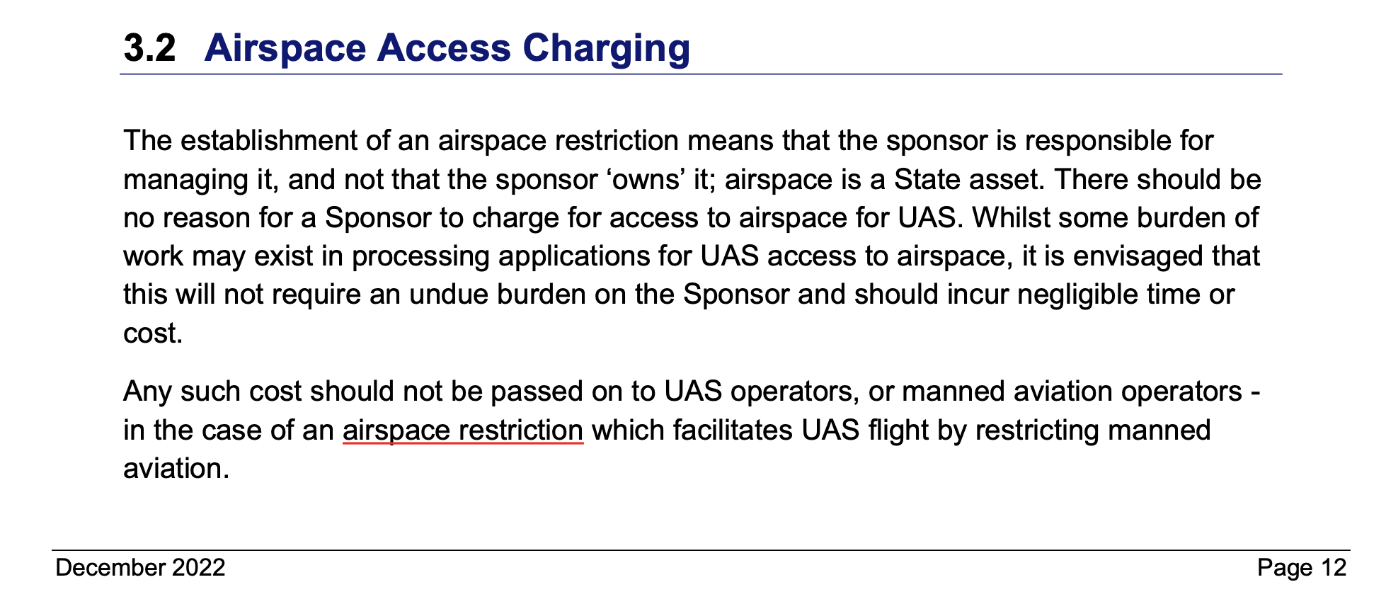

It was me!!! We had it out with Lee-on-Solent over this very issue who didn’t get a penny.
@Seadog … Quote CAP722c and if they ignore it, report them to the CAA!
+VAT…
£24 is even steeper :pensive_face:
Ta, I knew I’d seen it somewhere :smiley:
For reference:
I just rang Blackpool ATC and asked if they were aware that Air Portal are now charging £24 quid, the guy on the phone said yes, he was.
I asked him if he was aware of CAP722C and section 3.2 and that the cost should not be passed on to UAS operators (thanks @uav_hampshire :smiley: ), his response was:
Ummmm… No, that’s above my pay grade.

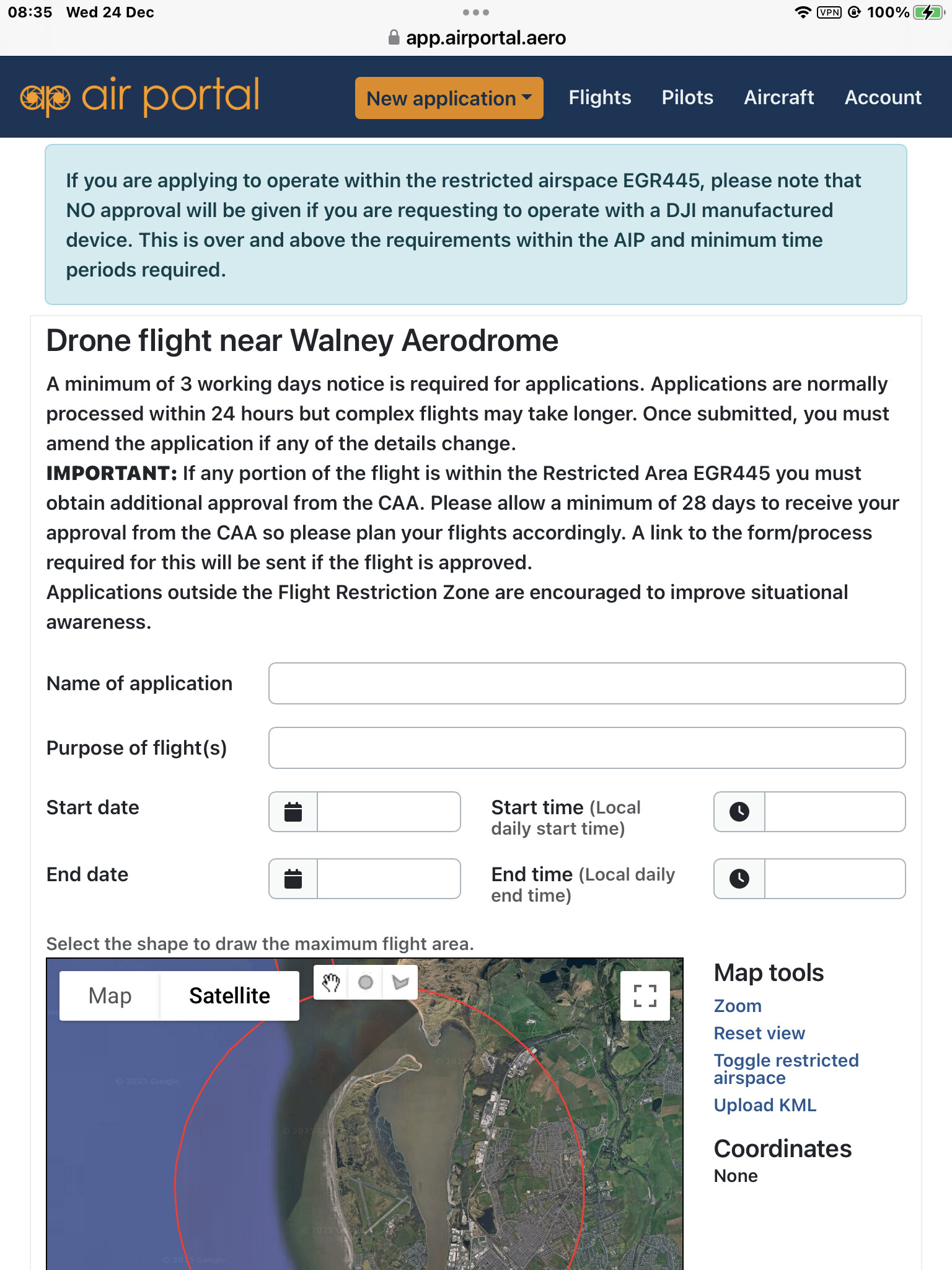

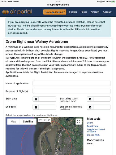

Yes you’re right I selected the different areas covered by Airportal and none of them indicated a fee payable. However I did find this interesting, and worrying statement for Walney.
EGR 445 is a small area, protecting the yard where our nuclear deterrent carrying submarines are built. Doesn’t sound terribly shocking that they’d seek to ban drones which might be of use to a foreign power from overflight? :woman_shrugging:t3:
They use multi million pound satellites instead.
Yes I understand sensitivity surrounding submarine manufacture,but Barrow as it’s own no fly zone covering that, this is mainly to the north and only just touches Barrow at its southern edge. Yet I can fly (at least no restrictions indicated on drone scene), right up peil channel, which is the navigable channel for barrow, right up to the docks and the area where they dock vessels carrying nuclear fuel, where I cannot fly over isolated areas to the north well away from Barrow. Not that I particularly want to just commenting.
My reading of the notice on the Air Portal page says that they’ll only deny applications for DJI drones if the request includes EGR445, which is a 1km radius circle. Presumably, outside of that they’ll treat applications for fly in the FRZ as normal.

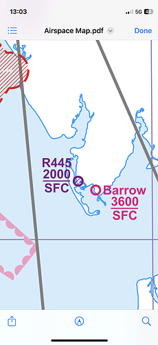

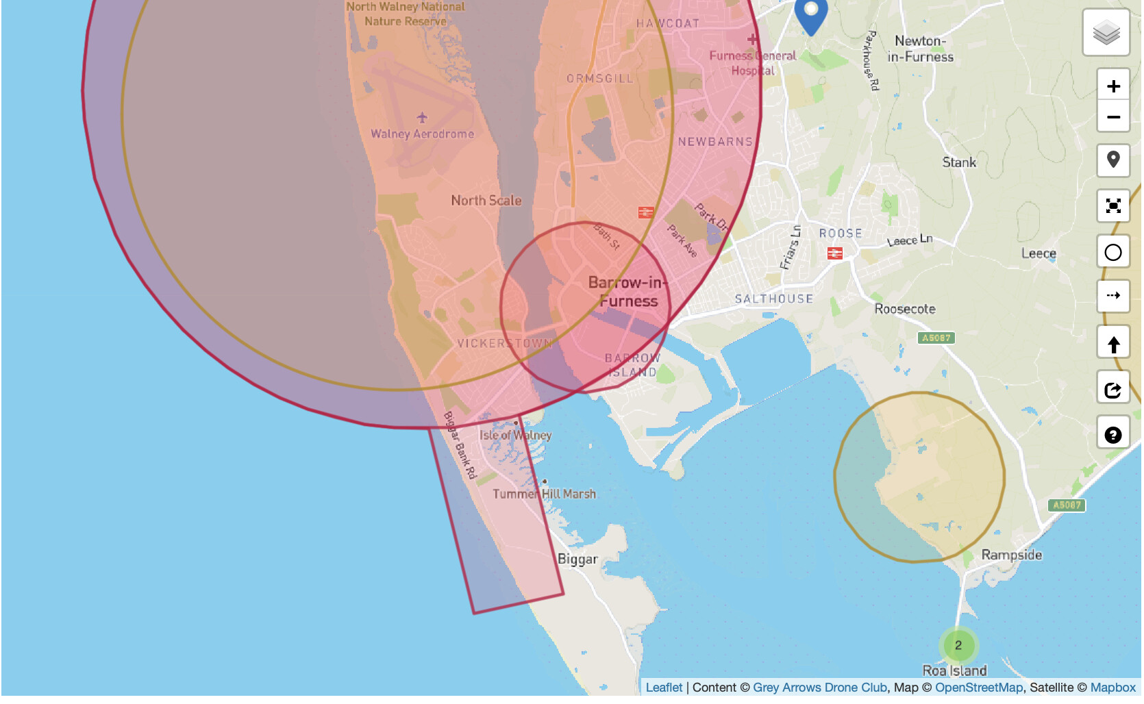

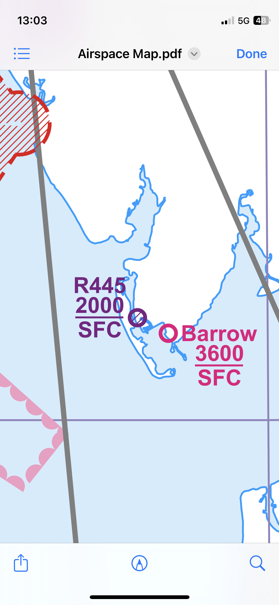

That’s curious as EGR445 is showing as a much smaller zone on the CAA’s map…
Chalk one up for Drone Scene there. NATS has it as “A circle radius 0.5 NM centred on 540635N 0031410W SFC to 2000 FT ALT”, which is 0.92km. :+1:
Edit: Wait, it’s a draw - my eyes have now adjusted to the different scales of those maps :rofl:
Hold the phone further away, we win
