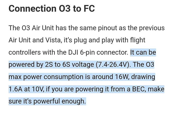

Oh! I didn’t think 9V was enough as it’s only 1.5A on the GOKU GN 475.
I did just spot this in the manual for the GEP-F722-45A AIO V2. So it would be relatively safe to use a 4S battery and plug the O3 AU without a BEC?
I.e. the 35V cap soldered to the battery pads?
that’ll do it :+1:t2:
Has the FC not got a dedicated DJI connection? :thinking:
The GOKU GN 745 40A AIO BL_32 V1.2 has a 9V /1.5A pad, which their wiring diagram shows connecting to a Caddx Vista but I thought this wasn’t enough to power the O3 AU (please correct me if I’ve misunderstood). The FAQ on the Flywoo website does say the AIO is compatible with the O3 AU and to refer to the wiring diagram, so I assume they mean to wire up the same as you would a Caddx Vista :man_shrugging:
The GEPRC GEP-F722-45A AIO V2 that I sent above has a plug, but it seems it’s just passing through Vbat.
Scratch that, The 9v bec isn’t powerful enough after a quick google search. It will need to be powered direct from the Vbat. With a cap :+1:t2:
