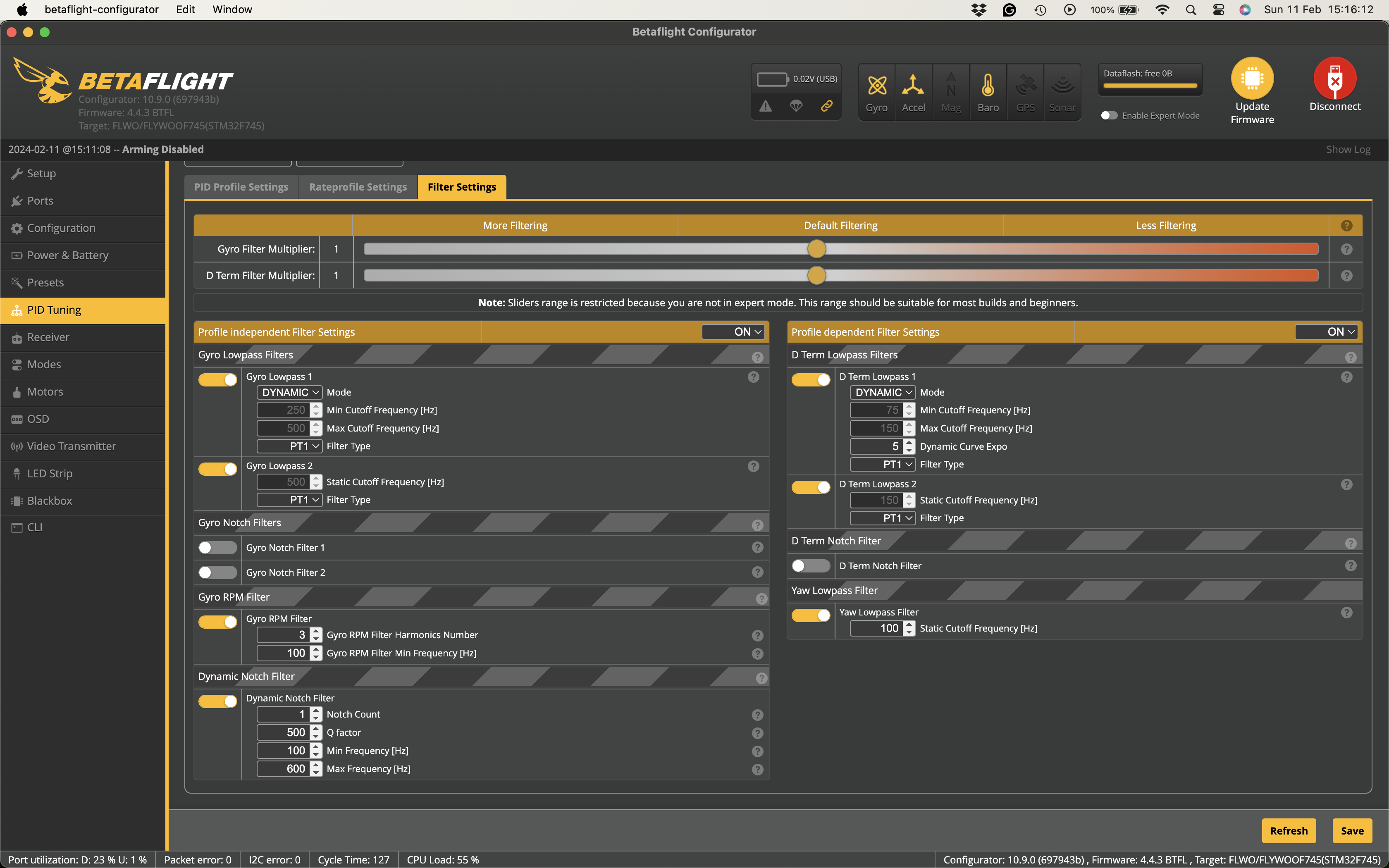

According to the Betaflight tip for motor idle (in the screen grab below), this is disregarded if Dynamic Idle is active but I can’t find that setting to check! I can do some trial and error to see if reducing it has any effect.
Screws are tight and bidirectional DDShot is on. I’ve got default filtering as follows:
