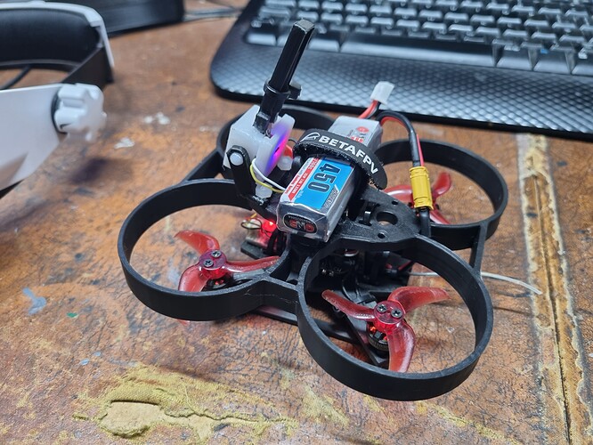

Nice work - how much does it weigh ?
Good question!
I just went and weighed it. 89g with battery etc.

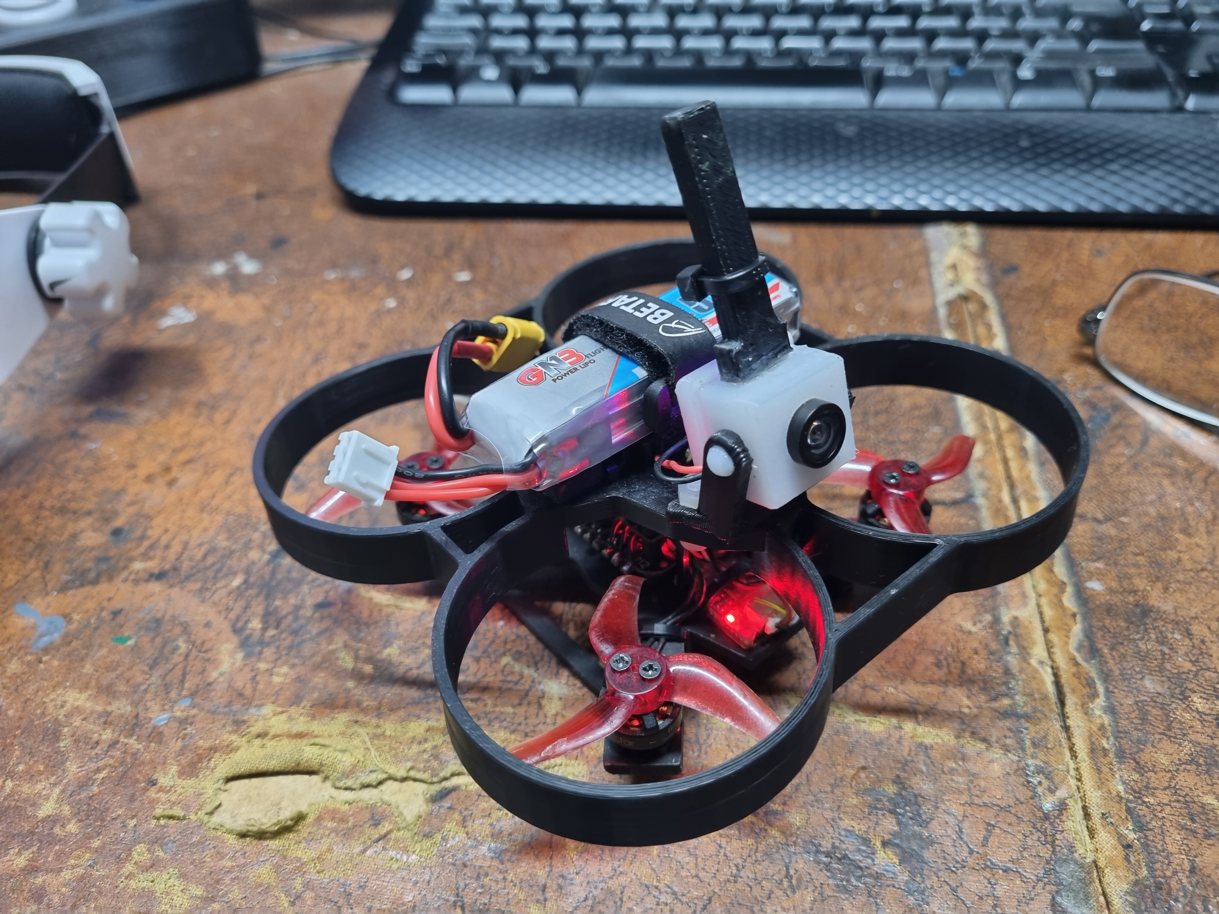

I decided I thought that antenna was a little vulnerable as it was so I printed a bit of protection for it from Polypropylene.
The rest of the body is already printed from that same stuff.
What is PP like when printed? Stiff? strong? flexible etc? Never tried it.
Strong, almost indestructible. Slightly flexible, but returns to the same position.

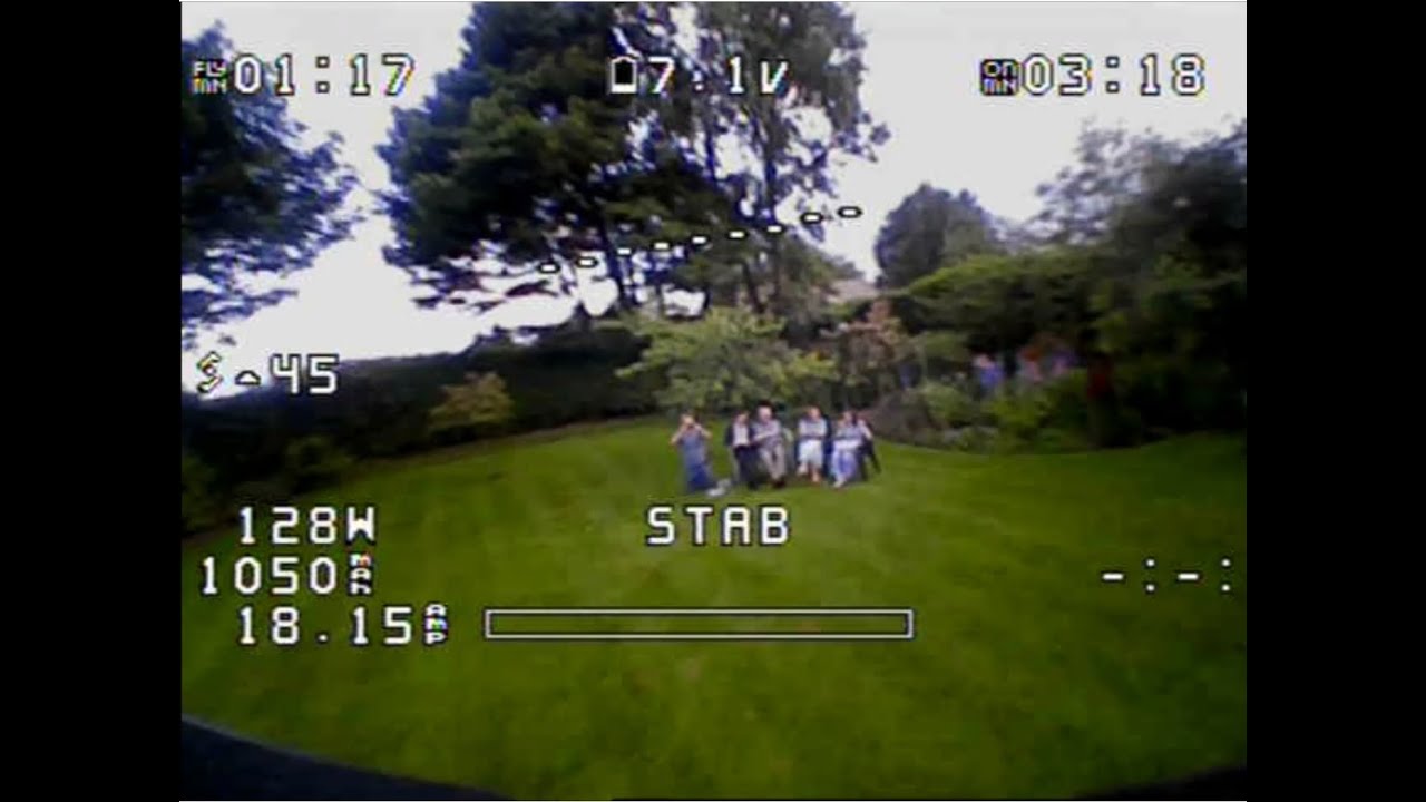

We took it out this evening for it’s first FPV flights.
I’d be interested in any comments on anything at all (drone related) you may notice in the video.

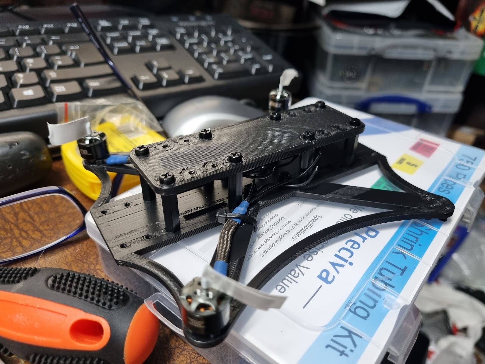

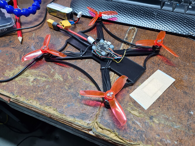

I’ve started progress on my second drone. The first prototype frame has basic components fitted and working. I’m designing the 3D printed frame myself from scratch.

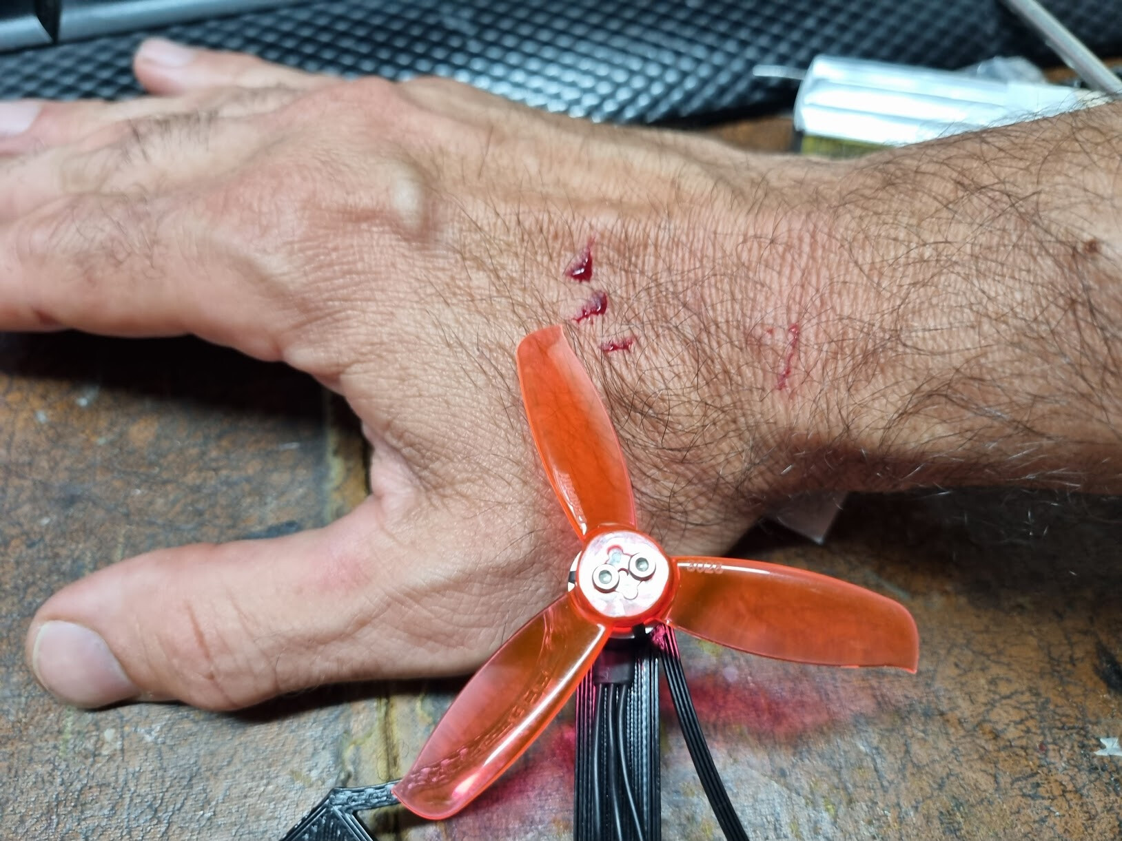

It’s up from 2" props to 3" this time. And no prop guards. I decided I knew the risks and ran up the props on the bench, clicking the “I accept the risks” button and then receiving my first drone prop injury… I now have a nice big plaster.
Anyway, it’s working… now to design a second prototype with places to mount the other components. I might also reduce the frame in size as it could probably handle 4" props with the size it is right now.
Hope the prop is still ok :grin:
lol… not a mark on it.
It’s not going right unless there is some claret flowing :smiley: :smiley:

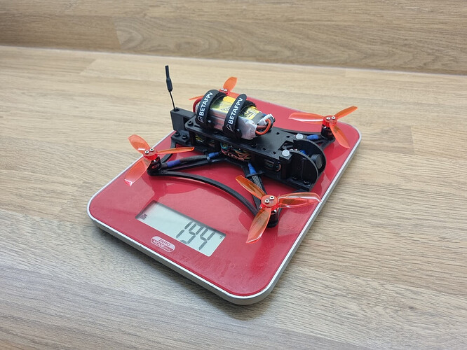

Everything seems good, but I need to have a quick test flight…
It flies!
Looks solid and stable :+1:
It feels it… a lot more to it than the 2"
