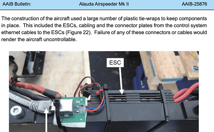

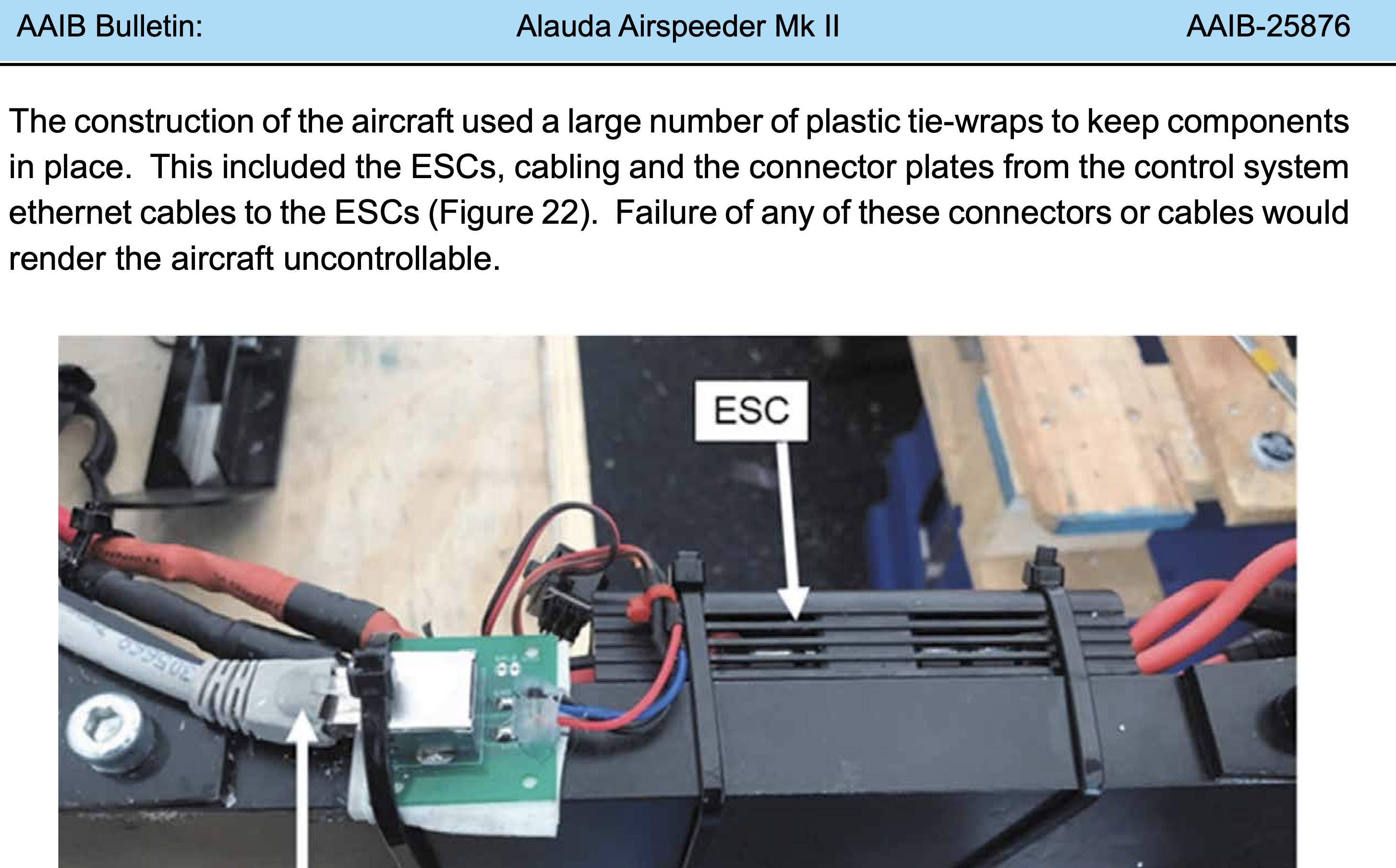

Agreed but It’s in the name “cable-ties” not component-ties and this was by a “commercial enterprise”, they were lucky to get off so lightly.
They are used in just about every aircraft in service but they are not from Amazon/Ebay etc. There are many different grades not just sizes.
Judging by what looks to be a white stress-mark on one of those, these weren’t of the highest grade.
In my younger days, when working on Polaris missile launch panels we only used Thomas & Betts (T&B Ansley) ties, nylon with a stainless steel tang to lock them, not the cheap one piece moulded rubbishy plastic you get these days
What surprises me is that no examination of the aircraft was carried out by an authorised body. In the UK a model aircraft with a takeoff weight of 25kg or more needs an operational authorisation. The application for this OA should be accompanied with a certificate of air worthiness issued by the Large Model Association (LMA). After seeing how the electronics were constructed, and the type of components used in the construction, if this thing had been officially inspected it would not have been permitted to fly. Personally I would be ashamed of myself if my soldering was as poor as that shown in the pictures. And don’t get me started about using prototyping breadboard in something as large as this, especially when it’s so easy to get proper circuit boards made by a proper circuit board manufacturer relatively cheaply. Add to this the lack of any redundancy in the Flight Control system. At the bare minimum I would have thought they’d have installed a backup to the FrSky R9 receiver. I think due to the lack of vibration dampening the receiver they used probably shook loose, as did the wires for the kill switch.

“The AAIB found that the Alauda Airspeeder Mk II was not designed, built or tested to any recognisable standards and that its design and build quality were of a poor standard. “
