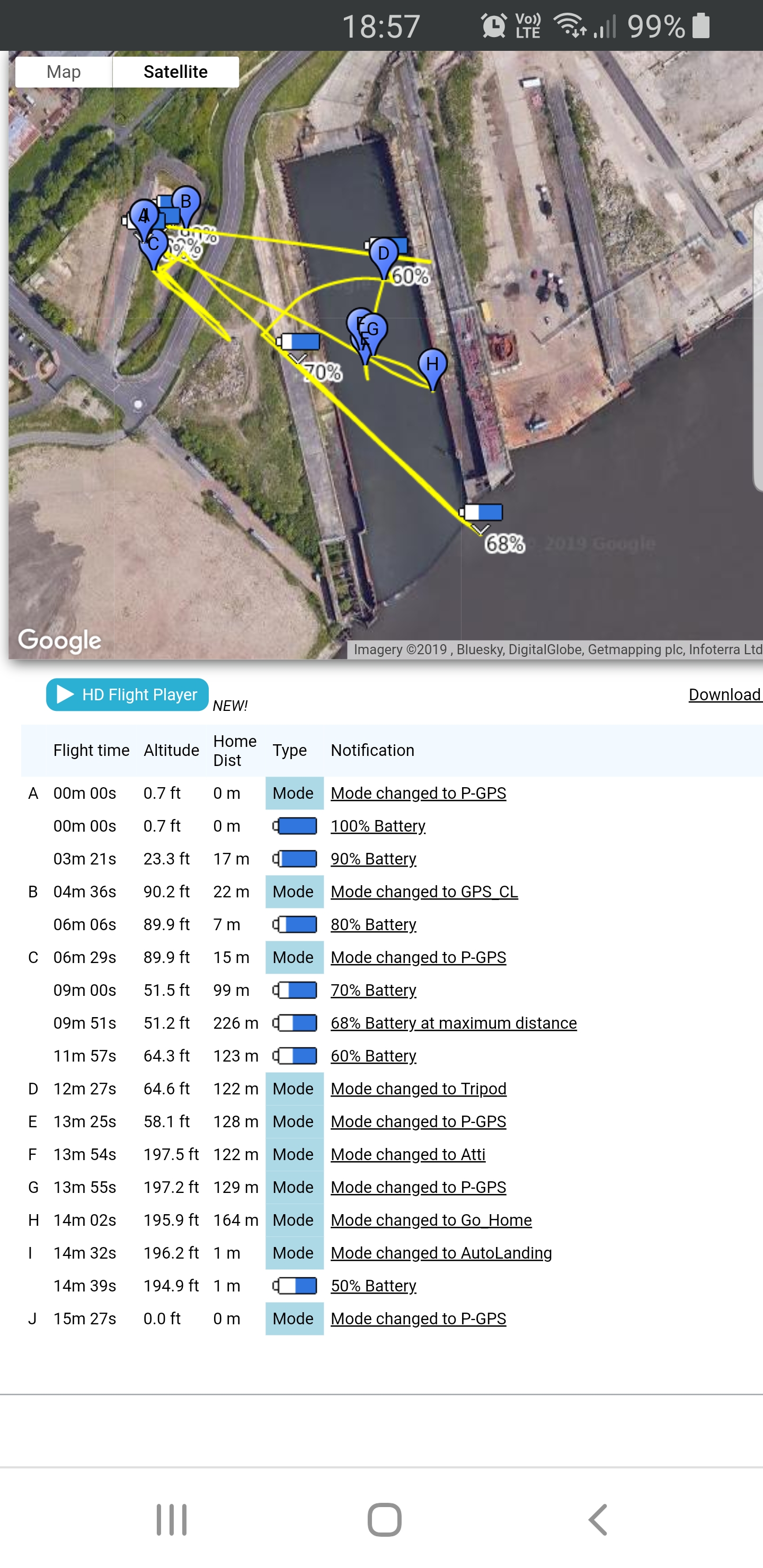

Sh*t the bed… Almost lost the drone outside Vilamoura harbour. Didn’t like the wind and started complaining about magnetic interference. Perhaps from the hotels? Although was nowhere near and within VLOS out over the sea. It then temporarily ‘fell’ out of the sky and then corrected itself but was also flying on the piss due to wind… Looked really weird… Landed and decided to drink instead… Any ideas guys?

What will the flight records tell me about the interference? Can I share with you guys to see if you can help me figure it out?
If you have not already got “Airdata” or “Hdsync” Apps installed on your Phone/Tablet, then you are not going to be able to tell what the problem was/is.
They monitor all the data from your flights, and allow it to be uploaded (via Hdsync) to “Airdata” .
This then allows you to replay any flight you may undertake, and gives a shit load of data on batteries, direction of flight, warnings, etc,etc.
I suggest if you have not already installed them, do so.
Was there by any chance a load of boats with radar in the harbour, it’s a long shot but I recall filming an ocean going boat from nearby it and getting some weird interference. In the interim until you can get airdata app, download the flight log from the Dji app and it’ll show you the track and any warnings received. If you took off from concrete, (harbour??) the metal bars in the concrete will upset the compass to the point that when it becomes airborne and away from the interference, the compasses will disagree with each other and give you a magnetic interference warning.
That’s a really good shout @Brian. Was on the edge of the marina and took off from concrete… Interesting… The flight data I have is on an older Droid but will take a look and try to report and findings

As @Brian has said, the combo of big chunks of metal (boats) and the radar equipment coupled with the probability of (very) reinforced concrete is your problem.

I had an arse clenching moment yesterday when flying near a ship, all of a sudden remote changes to ATTI and it looked like the drone started dropping over water
I looked over to the drone and pressed RTH then thought “shit if its got no gps it cant return home”. It did come home but I was a bit apprehensive about flying it over water again.
When I looked at Airdata it was in ATTI for all of 1.3 seconds before changing back to gps but it was the longest 1.3 seconds of my life and it never dropped in height it just looked like it had.
Interesting what Brian said cause I was about the same height as the ships bridge
