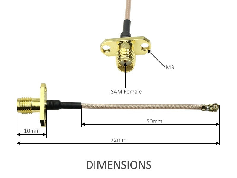

Just a quick ask if anyone knows if you can buy the coax cable for pig tales as Iv just repaired one and discovered I have a couple more Id like to have a go at :+1:t3:
Ive seen people recommend rg316 alot for pigtails and antenna repairs

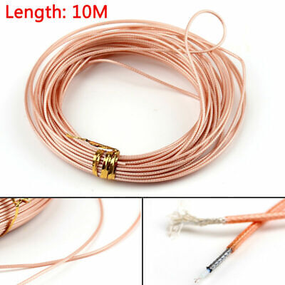

Is this a common thing, i.e would I find it in my local electronics store ???
Pass. Steve @SirGunner is your man (not physically :wink: )
You can buy it online, just google it and a million options will pop up. You might be able to buy it from an RF specialist but you wont find it in your local Currys :smiley:
Yah just been doing that and found these, very interesting
Ah I thought you were looking for the coax cable to make/repeair your own pigtails
If I were to choose between rg178 and rg316 I would go for the latter as it has the least loss

The small difference in loss between the two over a 6inch length at 5GHz might not appear to be much, but when you add connectors and an antenna which isn’t a 1:1 load then this can add up and impact the 25mW of power we all use :wink:
To do that you would need the connectors and a crimping tool
https://www.amazon.co.uk/connectors-coaxial-crimping-antenna-extension/dp/B082SV9LP1/ref=psdc_1338420031_t1_B08YNTPZ5T
LoL I am but its always good to find barging, that said Nidge comment has given me food for thought :thinking:
I like the thought of crimping them, just pop a blob of solder in the hole you could pop a bit of heat shrink over the end…
