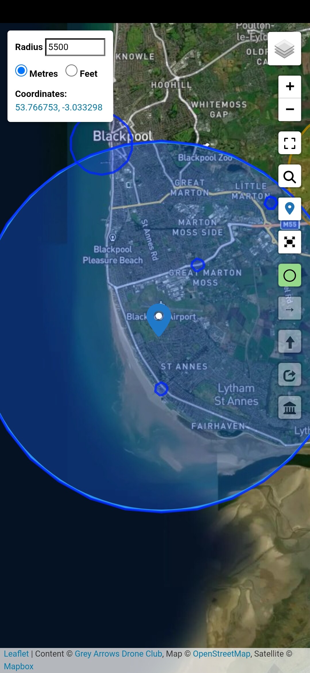

Just spotted on drone scene (Blackpool area), not seen it before.

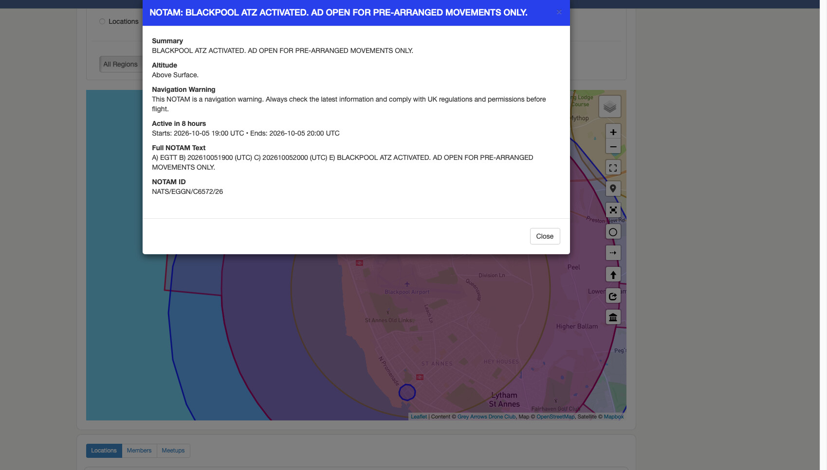

@Seadog Yes, this is an official UK aviation alert called a NOTAM (Notice to Aviation), which states that the Blackpool Airport Aerodrome Traffic Zone (ATZ) is being activated outside of its standard operational hours specifically for pre-arranged flight movements only on October 5, 2026.
In simple terms, Blackpool Airport is temporarily “waking up” its official controlled airspace for exactly one hour on the evening of October 5th.
Normally, when a smaller airport closes its air traffic control tower for the night, its surrounding strict airspace zone (the ATZ) is no longer active, meaning the airspace effectively reverts to standard open rules. However, because a specific plane has booked a late flight (a “pre-arranged movement”), the airport is keeping the lights on and the airspace active between 7:00 PM and 8:00 PM UTC.
What this means for Drone Pilots is that one cannot fly a drone inside an active Aerodrome Traffic Zone (ATZ) without explicit permission from the airport’s Air Traffic Control. The impact of this is that even if one usually flies in this area after normal daytime airport hours, one must keep one’s drone grounded inside this zone during this specific 19:00 to 20:00 window, unless one has booked a flight clearance directly with Blackpool Air Traffic Control.

Odd that, seeing as the ‘window’ is within the airports normal operating hours (as per their (website)

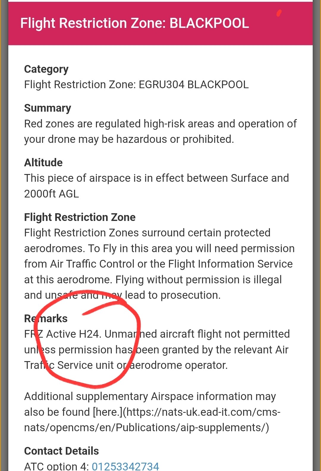

pretty sure Blackpools FRZ is active 24/7 anyway in respect of drone flights.

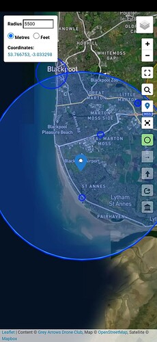

As@stevesb points out it is active 24/7, but this blue zone extends beyond the normal FRZ quite significantly.
it also looks to be centered in the back garden of 8 Benbow Close. :thinking::thinking::thinking::thinking::thinking:
