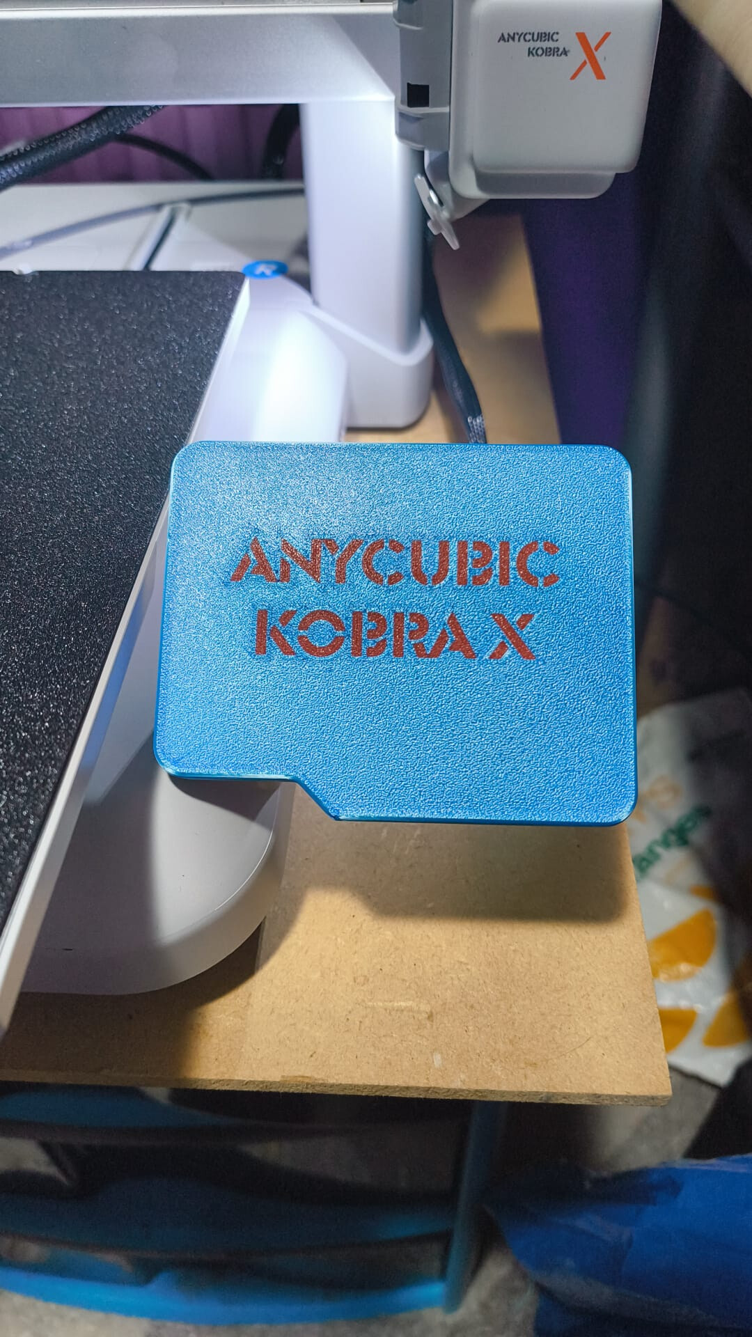

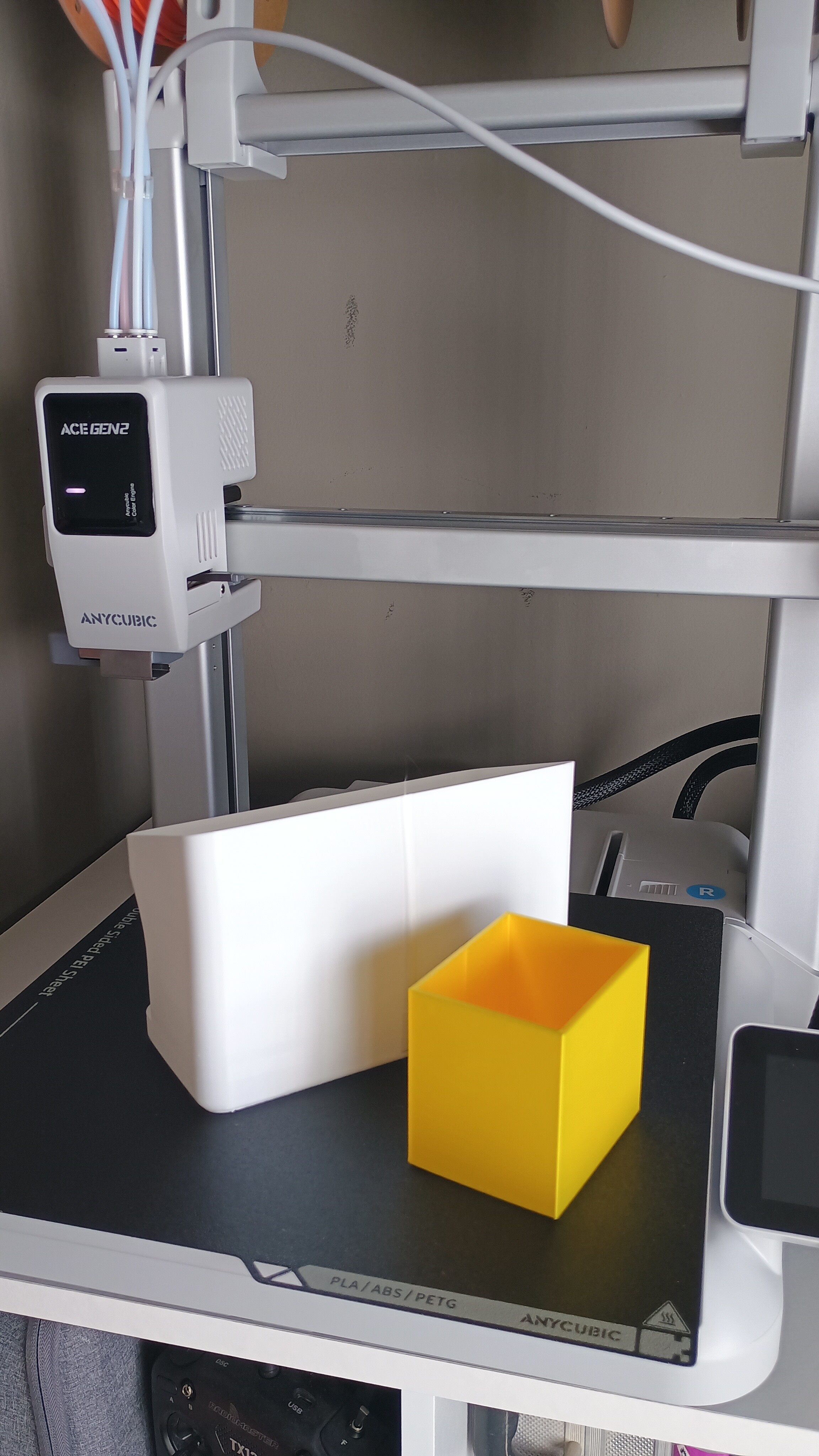

First print. The inevitable “poop bin”(white). 1hr 10min.
In the foreground, a straightforward box (yellow) which I seem to recall taking around 3hr on the Ender 3.
It’s fast.

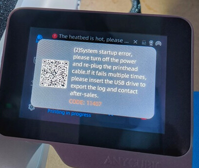

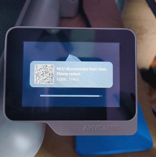

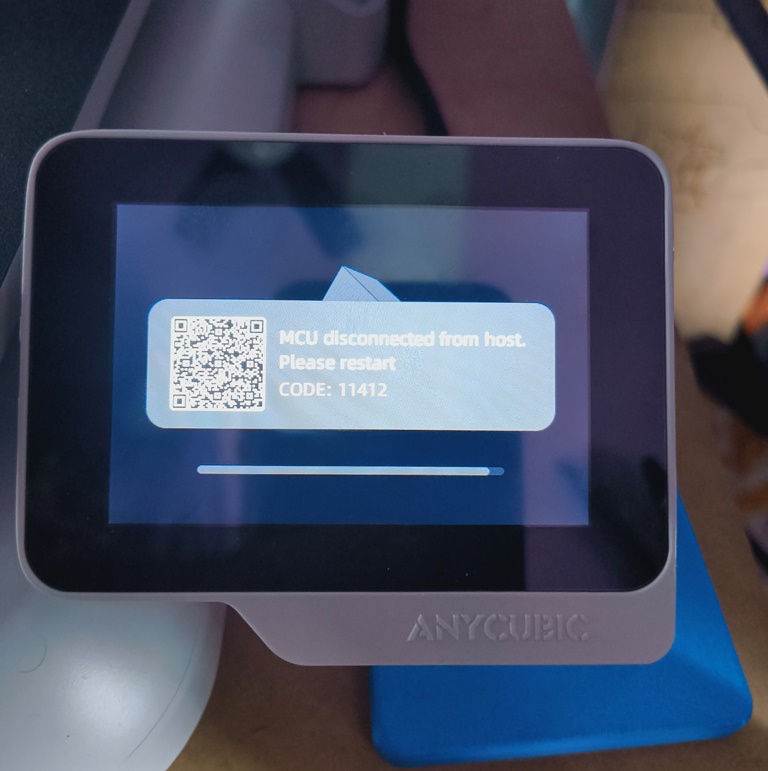

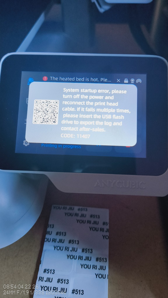

So after 2 days light use it stopped mid print showing this
so after checking wires and re booting
several re boots and a system restore and I have a paperweight.
Polite but firm ticket raised with Anycubic.
Any news?
a quick reply asking me to check connections, install attached firmware (how firmware is going to fix a connection issue!!!) and export log file.
to which I replied,
Hello Bell and team,
Thank you for your prompt reply, I have been trying to get all the information for you but the printer will not show the main screen, all I get it now is the error 11412, so I am unable to check firmware or export logs.
I did check and re seat the cables at both ends, but no change from above. I have attached photos showing the cables in place.
The printer is faulty and as under a week old I require a replacement, I will package this printer up into its original box awaiting your instruction.
Thank you.

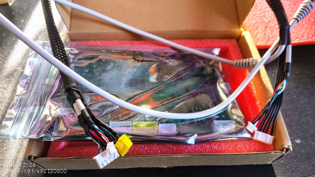

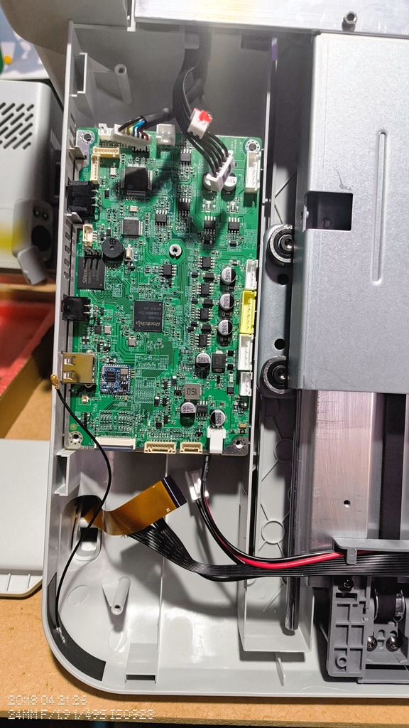

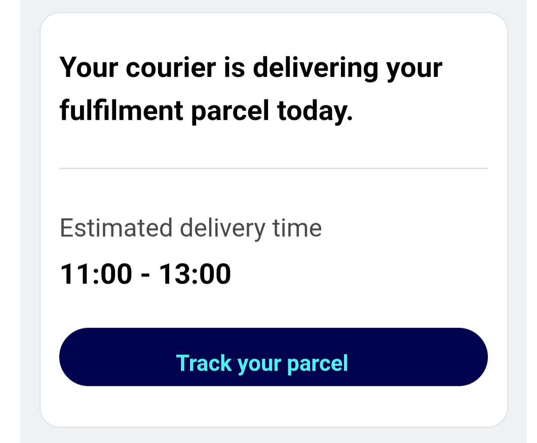

Today I got a new motherboard and print cable.
Just fitted the cable as that’s the easy one, don’t like swapping 2 parts at once so I know what the problem component is.
Test print just started, finger crossed.

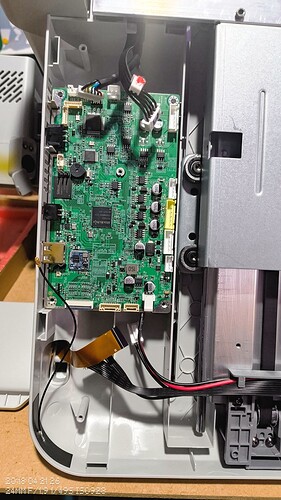

The bastard motherboard waited until I hit “reply” before throwing the error.
Open heart surgery now.

Well its working now, I did notice the touch screen is a lot more responsive, before I needed to press quite firm.
Will give it a few test prints before I confirm to Anycubic.

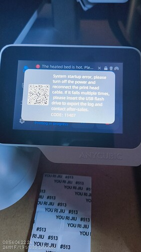

Guess what, this morning got this
So, after double checking all connections and getting same message, they got this by email.
"Hello Support team.
I fitted both the new cable and motherboard as your instructions.
Updated the firmware when the printer connected to network, did a full reset from the start allowing all tests to complete.
The printer is again showing similar error messages, after each one I have checked all connections, I enclose a photo with time stamp of several of these messages along with a photo showing the motherboard with firm connections.
*I am not going through any more checks or repairs, I want either a replacement or a full refund as I have lost all faith in this unit. *
I will wait 1 week, if I have not had either full refund or replacement I will be raising a chargeback for faulty goods.
This is my final say in the matter.
R Bright."
