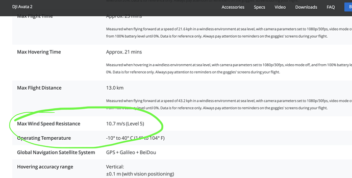

If it helps, all DJI drones list their wind speed resistance on the Specs section of the relevant product page on their web site:
Its the same
This gets me back to my original question if both the Mini 3 Pro and the Avata 2 have the same wind resistance 10.7 m/s the Avata 2 is more susceptible to cross wind. I think it is as the Avata 2 cannot maintain a heading in similar wind conditions than the Mini 3 Pro. Actually at a lower wind strength than the Max quoted. I’ve come to the conclusion that it’s the shape and design of the Avata 2 is the major factor. I used to fly light aircraft years ago and the Chipmunk being a tailwheel was far more affected by crosswind than the Beagle Pup, a nosewheel design.
