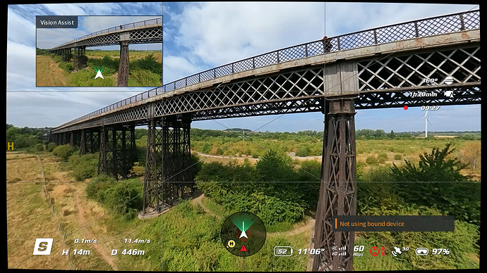

Not sure what has happened here and really really anoyed too by this
Flying the Avata 360 at Bennerly Viaduct and I flew under it - TWICE and as you can see from the screen grab from the goggles it was recording but for some reason there is zero trace of the recording both on the drone’s internal memory and the SD card that was in the drone ( it was set to record to internal for some reason too - missed that bit too
Anyone had this happened before - the time stamp for the google recording is 3 mins after the last recording on the drone

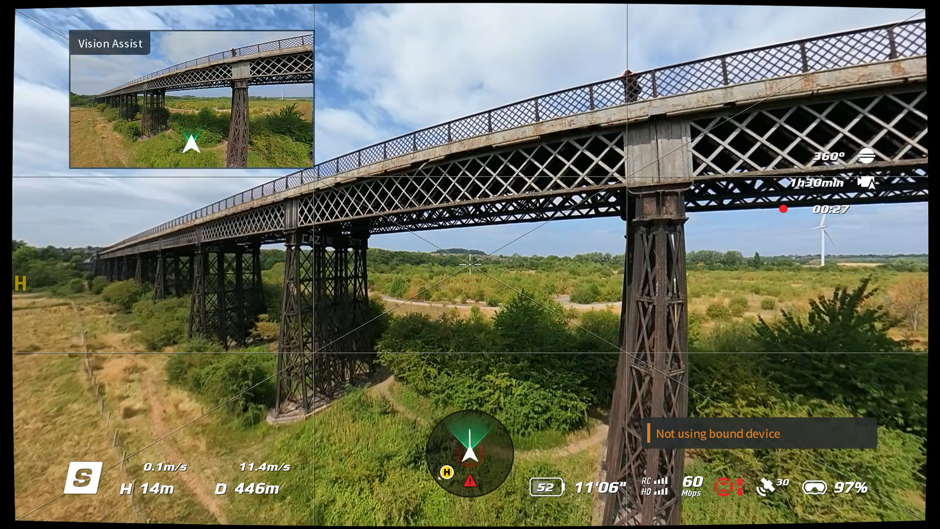

I have the google recording but its only like the screen shot above - the googles record the screen not what the drone camera captures so I can’t use the 360 footage as it does not exist for some reason - got other footage and photos just not the epic stuff of me going under the bridge in sports mode :man_shrugging:

Just checked the goggle settings and here is the odd one - it is set to record to SD ( but it did not ) its set to record both and it is set to record on take off - but I know I did stop recording before the fly though to take some pano photos and then as you can see by the red dot on the screen shot it was recording as I have the goggle recording just not on the drone
Only thing I can think of is maybe I did not stop the recording when I landed and powered off - that might be the only reason - the end of the goggle video for the flight does not seem to show a power down and loss of signal sort of thing - it just stops when I has landed I guess - oh well - just a reason to go back here and do it again I guess haha

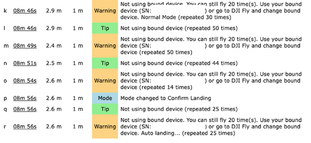

Not sure if it will be the setup of choice for this as man I have just looked at the AirData logs to see if anything stand out and other than the constant moan about the bonding to the account
