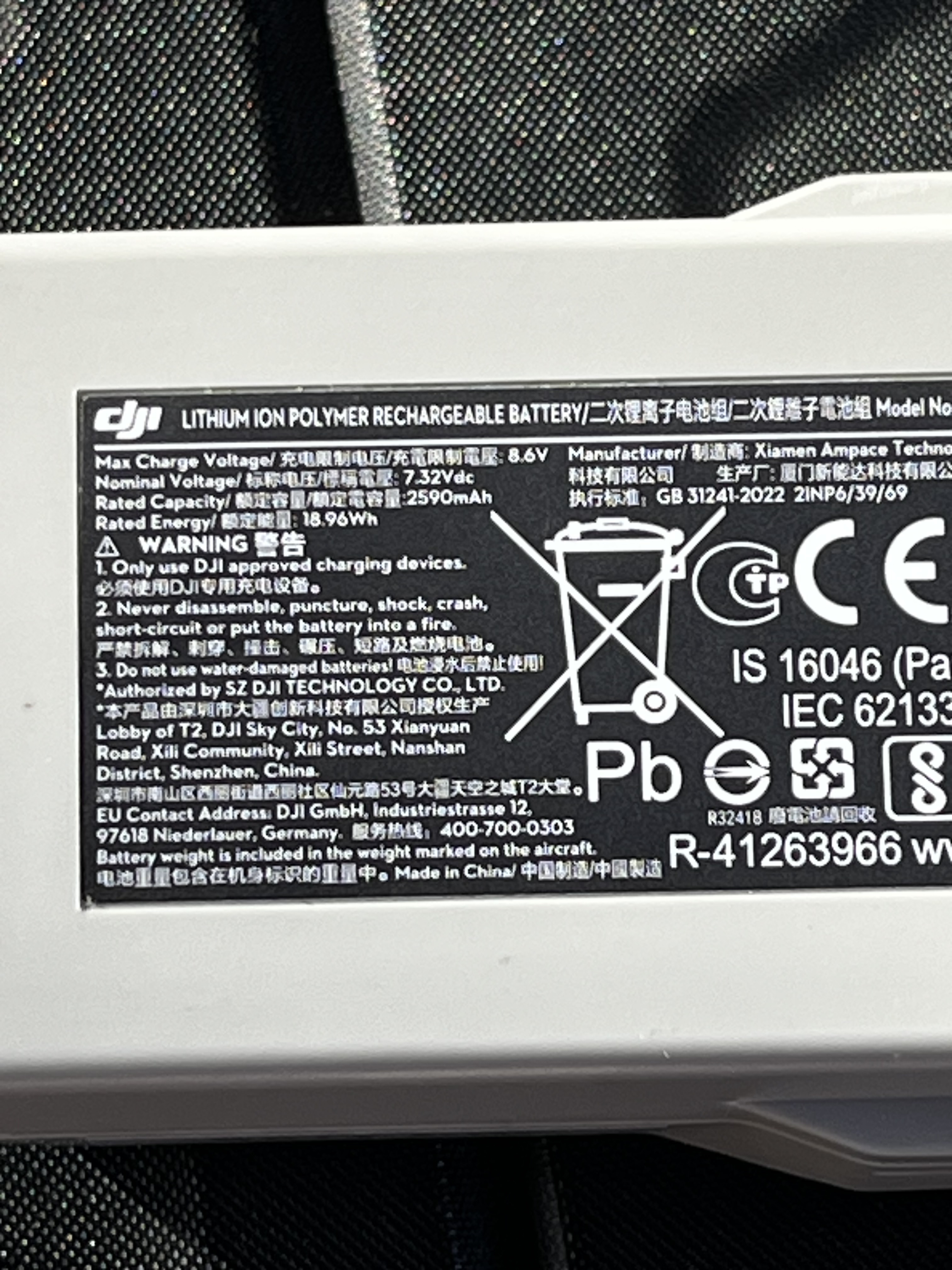

DJI batts are LiPo chemistry, not Li-ion. - I use the LiPos in RC Planes. They’ll charge to a nominal 4.2v / cell and I use telemetry to land when the capacity has been depleted to 20% remaining. LiPos ‘can’ be charged and left charged but most RC plane flyers use a ‘storage’ charge which drops them to around 3.8V/Cell if they’re not going to be used for a few days - this is a)safe and b) generally recommended which is why our RC hobby chargers have a ‘storage’ mode. DJI charging bays are ‘intelligent’ but simplified … and therefore they will discharge the batts to storage voltage for your drone to something like the above - it saves most ‘consumers’ from having to learn about LiPo batt management and from buying what can be expensive chargers from say iSDT or Tookit RC. Drone racers will do similar to the above too. Nothing to be worried about here at all - just charge up before you go flying the drone and land before they’re depleted. iPhone batts are Li-Ion which really don’t ‘care’ about the charge state they’re in…and aren’t relevant to the discussion thread here

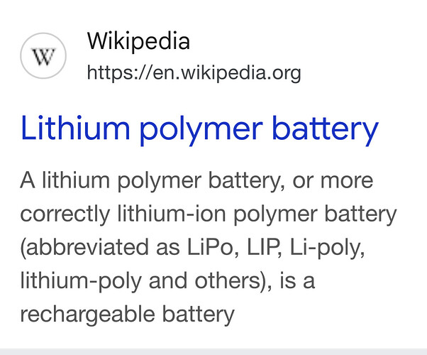

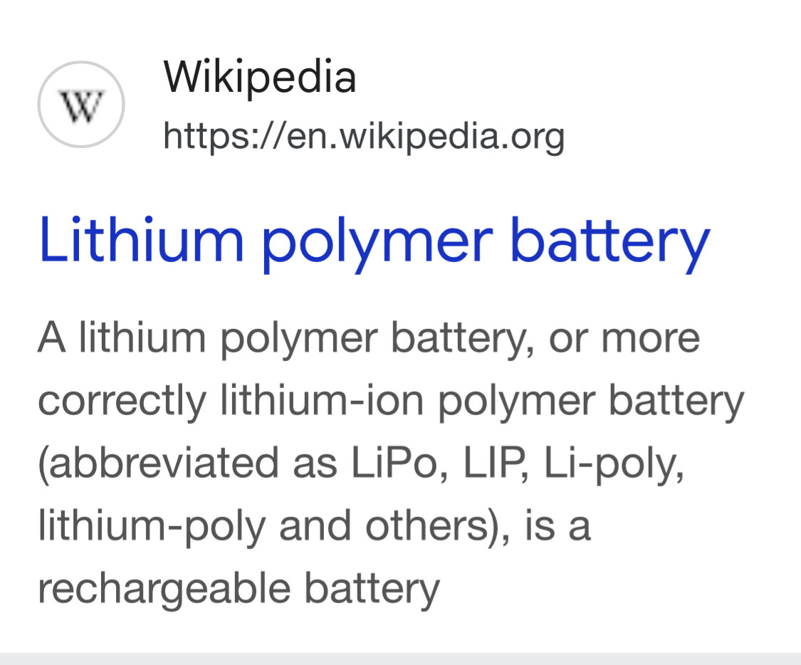

The full name of a LiPo batt (the management of which I described above) is a Lithium-Ion Polymer - usually shortened to LiPo. Here’s a couple of screen shots for your perusal. A LiPo is absolutely NOT a lithium ion chemistry which is what you get in an iphone or laptop…
Basic Lithium Ion batts cannot provide the discharge current needed by multi-rotor UAS nor XA RC models) and Li-ion whilst somewhat less caring about storage and management are way too heavy to be of any use in our airborne performance powetrains and systems. The energy density of both is quite different. No one flies fpv using Li-Ion chemistry…they’re too heavy, too big and cannot discharge anything like the current required for the performance needed. Without going off piste, the reason e-bikes and scooters go on fire is often because Li-Ion is being charged as the same C or 2C rating as a LiPo. A LiPo can handle that sort of charge current but a Li-ion battery is probably going to get very hot the blow up!! As I mentioned above, DJI charging bays manage the LiPo very well and they will discharge the flight batts after around 72 hours.
The sheet is of interest but inaccurate in places - it does indeed say the mini4 pro has a Li-Ion battery but it’s in fact a LiPo - there’s a photo of mine above!!. DJI have been inconsistent in how they’re describing or shortening the chemistry name of the batteries listed
