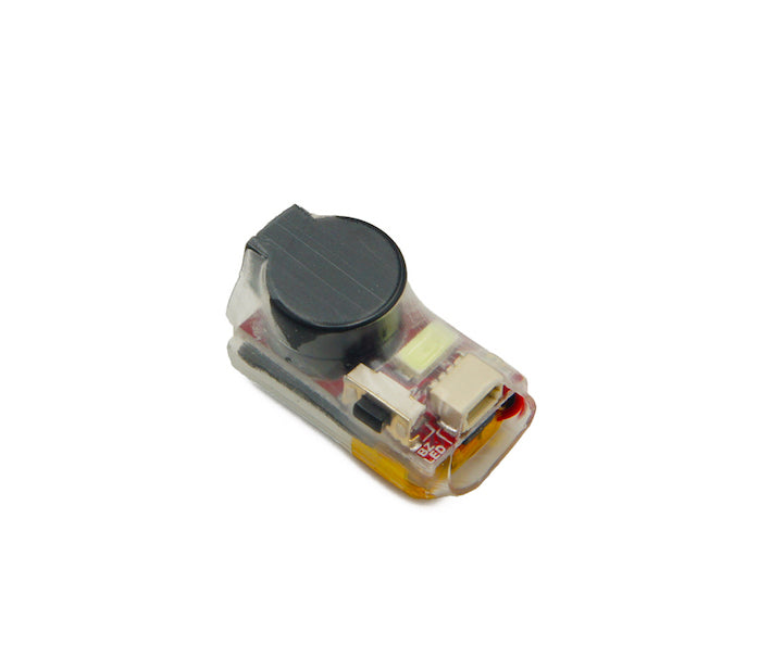

Top Tip for your Build:
pick one of these up :+1:t2: Believe me, I wish I had :man_facepalming:t2:
Well the ironic part of it is I have 4 of them in my parts box but I didn’t fit one to the wing because I figured it’s huge I won’t lose that! Well how wrong was I :rofl:

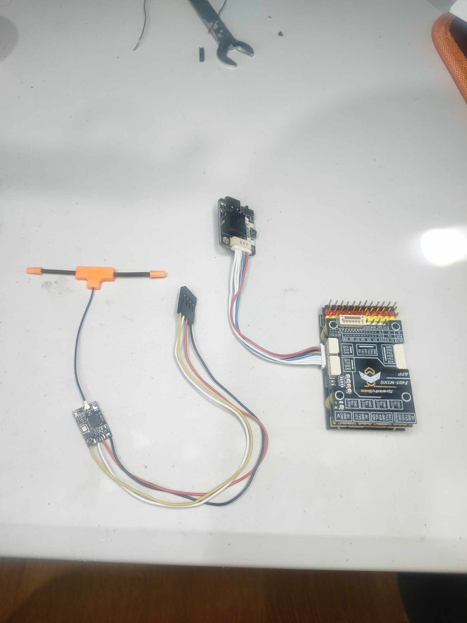

i got one just need to work out how to fit .Today i had a go at soldering the pins to the board and put the lead on for the receiver.

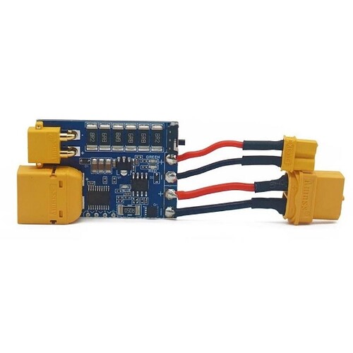

Another worthy investment for ya:
Ā£8 odd quid is well worth it to stop you frying your electronics :ok_hand:t2:
I’m not sponsored by ViFLY by the way they just make good products :rofl:

I think it will be the Eric and Nicola build, I built the board this afternoon for him :joy:
Looks like a decent job at the soldering, i got red and yellow rows mixed on mine but it doesn’t matter.
Mine’s a Heewing T1 Pro, SpeedBee 405Wing and O3 unit.
There’s a 6 wire cable that comes with the Flight Controller for fitting the O3 (it’s the longest one) much longer then the one that comes with the O3 unit. I cut the yellow SBUS cable as you don’t need that and less wires the better.

There is a buzzer on the FC but it relies on the battery staying connected, as Deano said a separate buzzer is a good idea.

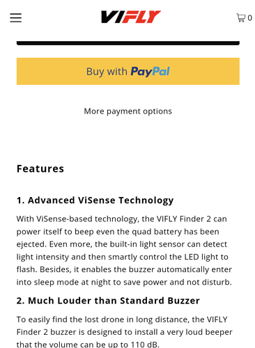

Careful with viflys inside wings and wings. I ā€œthinkā€ they have a light sensor which means it won’t beep at night… it’ll just flash… Which on a quad is ok (unless night flying) but on a wing inside the compartments… I think this is the case but would need more testing/checking.
I’ve bought cheaper alternatives from Amazon which work fine.

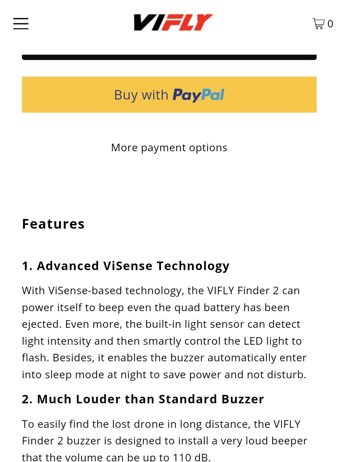

From their site (thought better backup my comments lol)
Possibly why I thought some were duff in the past
ā€œSleep mode at nightā€ā€¦ Ummm no thanks
That is a very good point @GunjaFPV maybe the ViFLY mini might be a better option?
Still the same 100db just smaller with no sleep mode?
Yep, but the flashy light can be so useful when searching an area with another quad to find the downed plane
