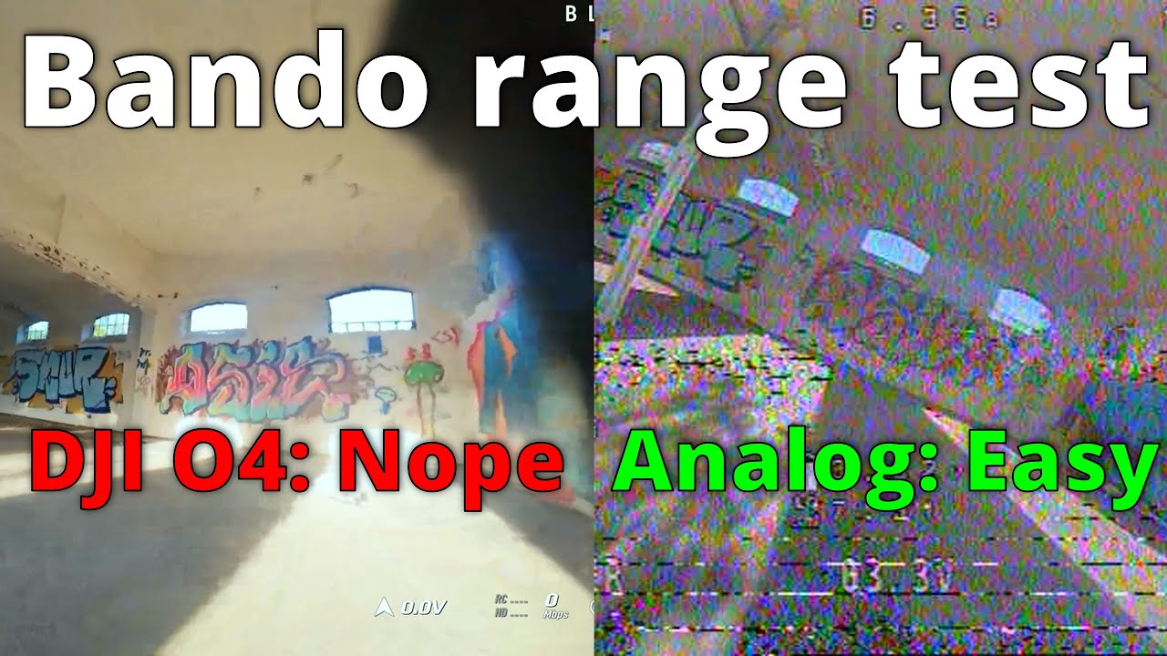

When I first started this hobby a few months ago I went for the old analogue video system as I figured this was the cheapest video system to implement and should be fairly fault tolerant to interference, and will not fail catastrophically when my drone goes out of range. In other words the picture will start to go fuzzy as the drone goes out of signal range rather than just cut out completely.
