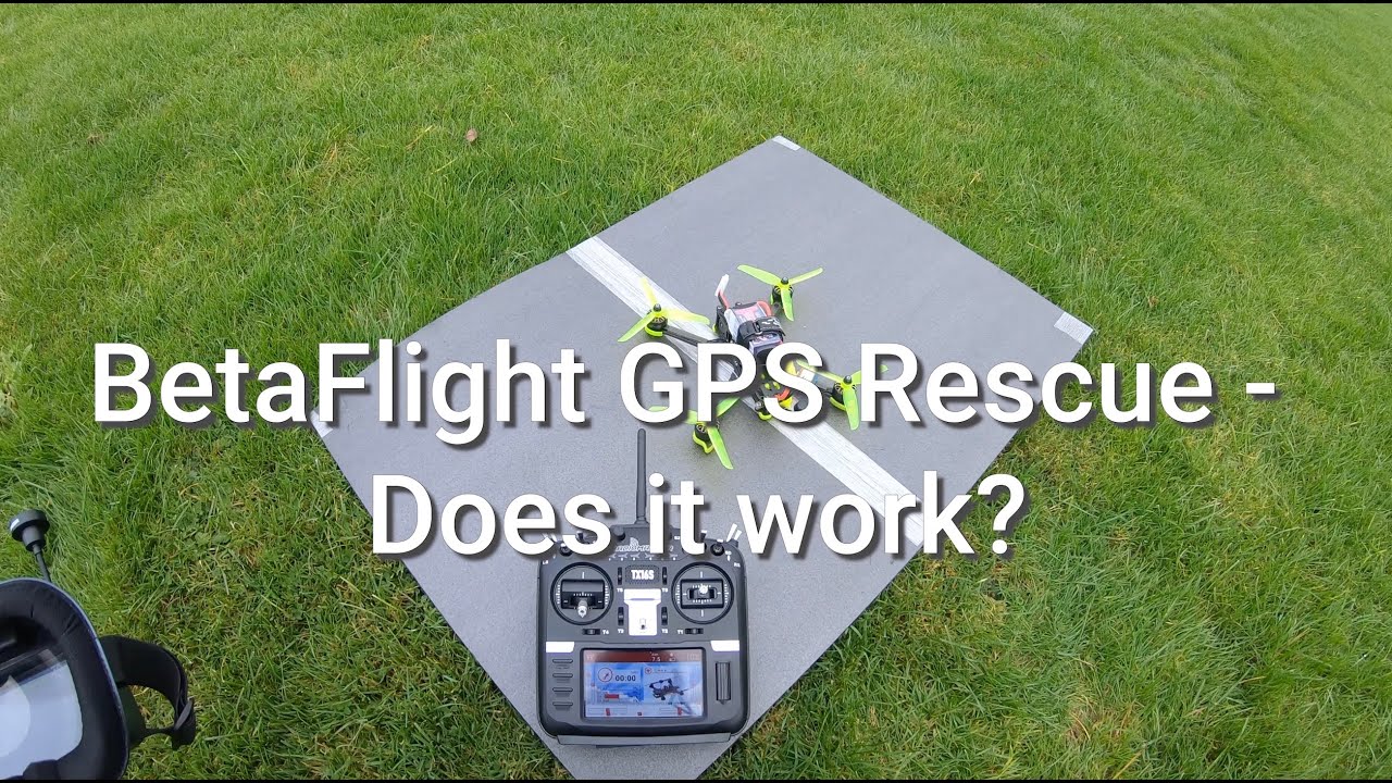

Betaflight rescue works
With @Steviegeek trying out Betaflight gps rescue.
This mode is a failsafe or emergency procedure (when your vtx craps out) to bring your quad home. In general terms.
It worked real well 3 times.
Please do not try this at home. Go to a large field.
