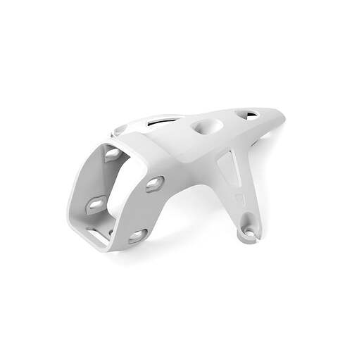

BetaFPV sells them it seems - even comes with the fancy grommets and an antenna :open_mouth:

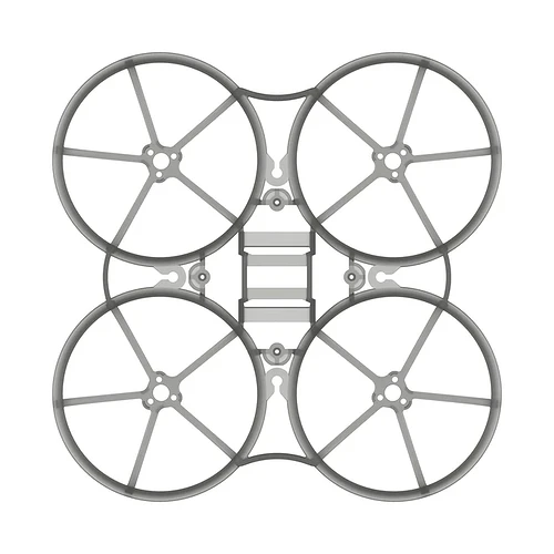

@Playtripper frame
@Playtripper

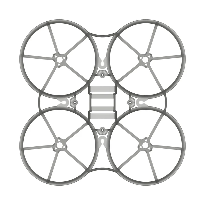

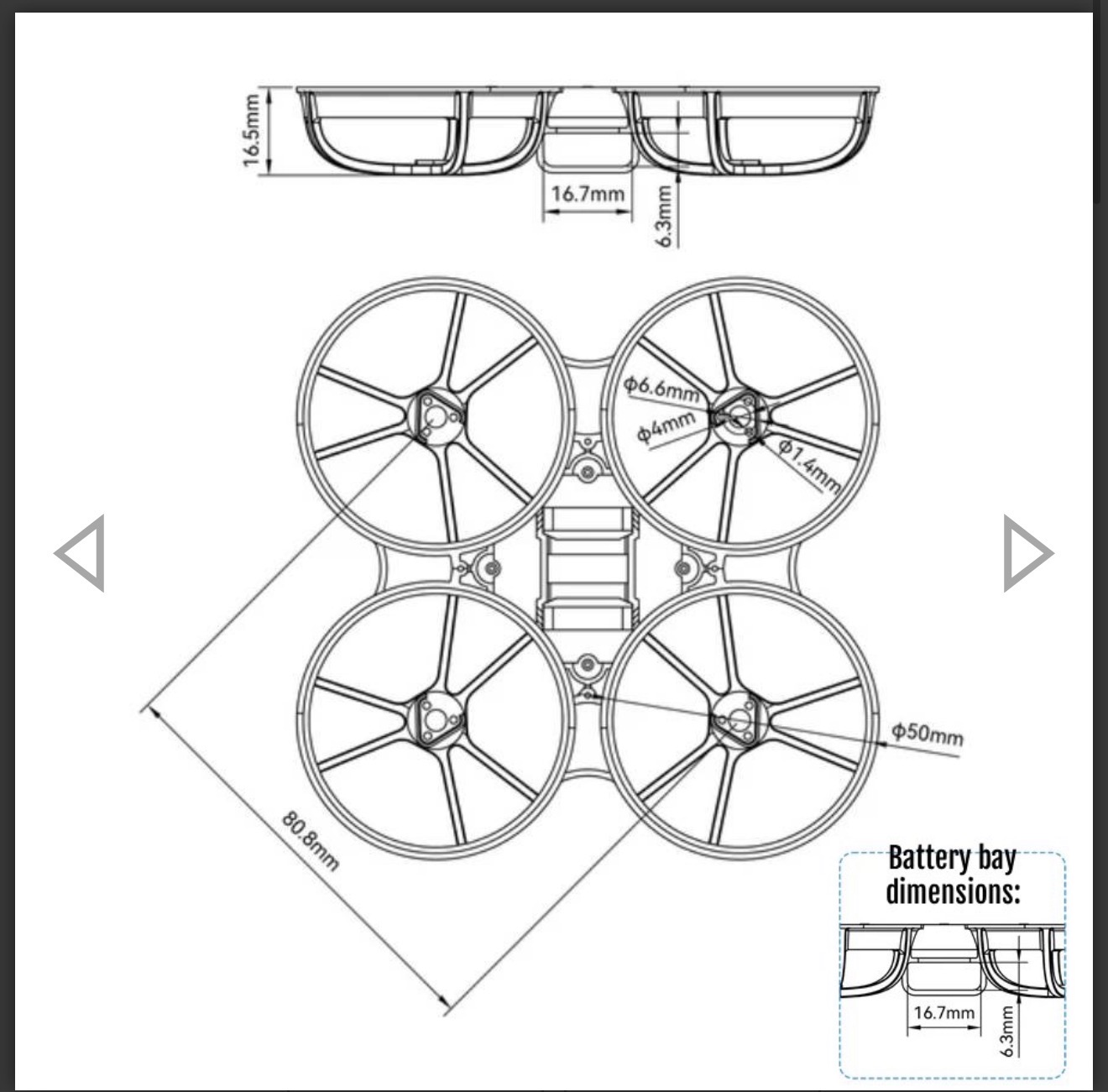

The Meteor 75 Pro II frame is considerably different to version one, unfortunately.
I’d hazard a guess that the new camera mount won’t fit, there’s nothing to cut into, on version one for the silicone grommets :enraged_face:
The Meteor 75 Pro II frame is less than a £5​:grin:, but you will need the ipgraded motors too, it’s fitted with the Upgraded More Efficient 1102 Freestyle Motors (2026) 21,000kv compared to the regular 1102 Brushless Motors 22,000kv. Which will set you back another £35.

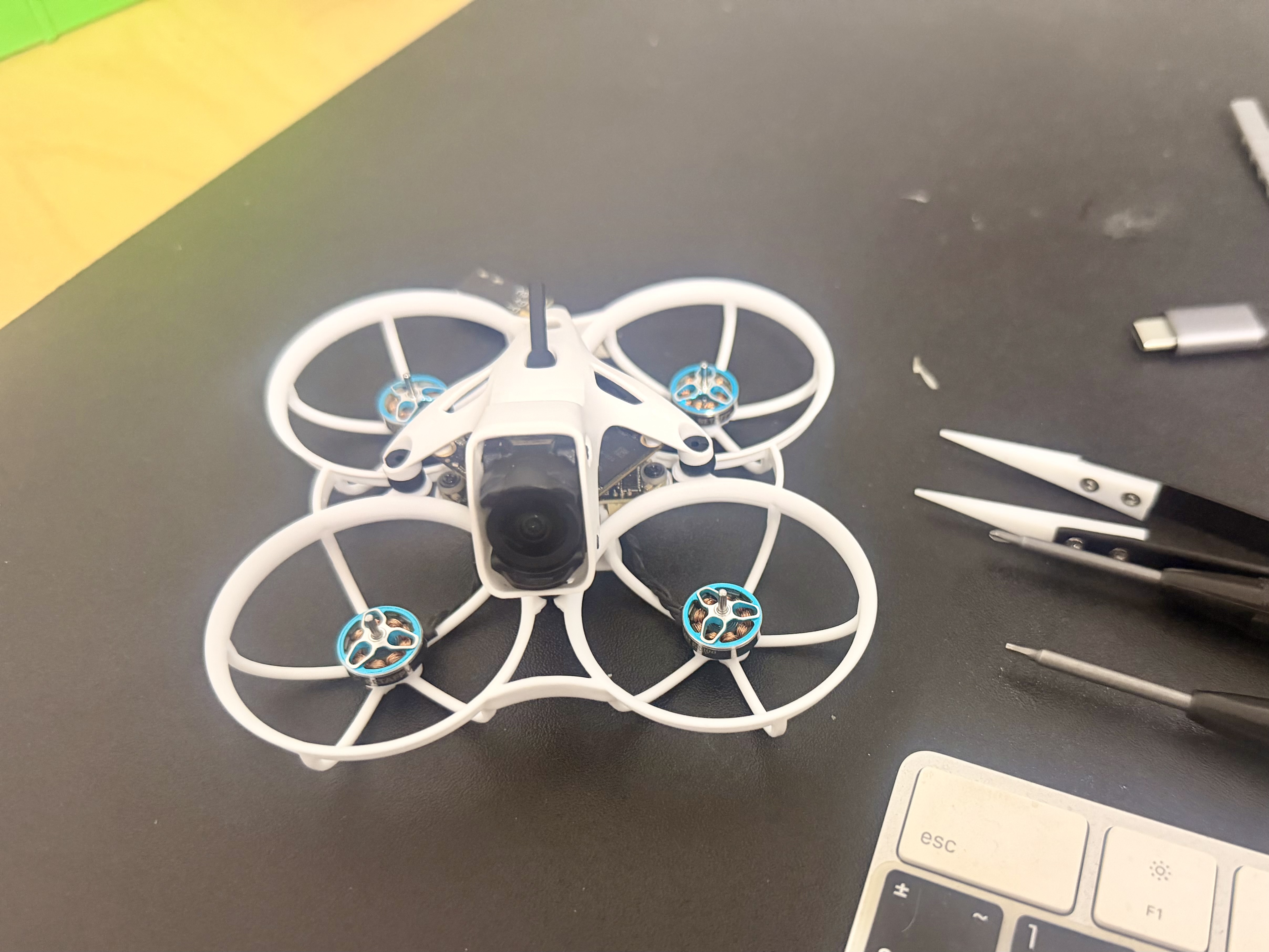

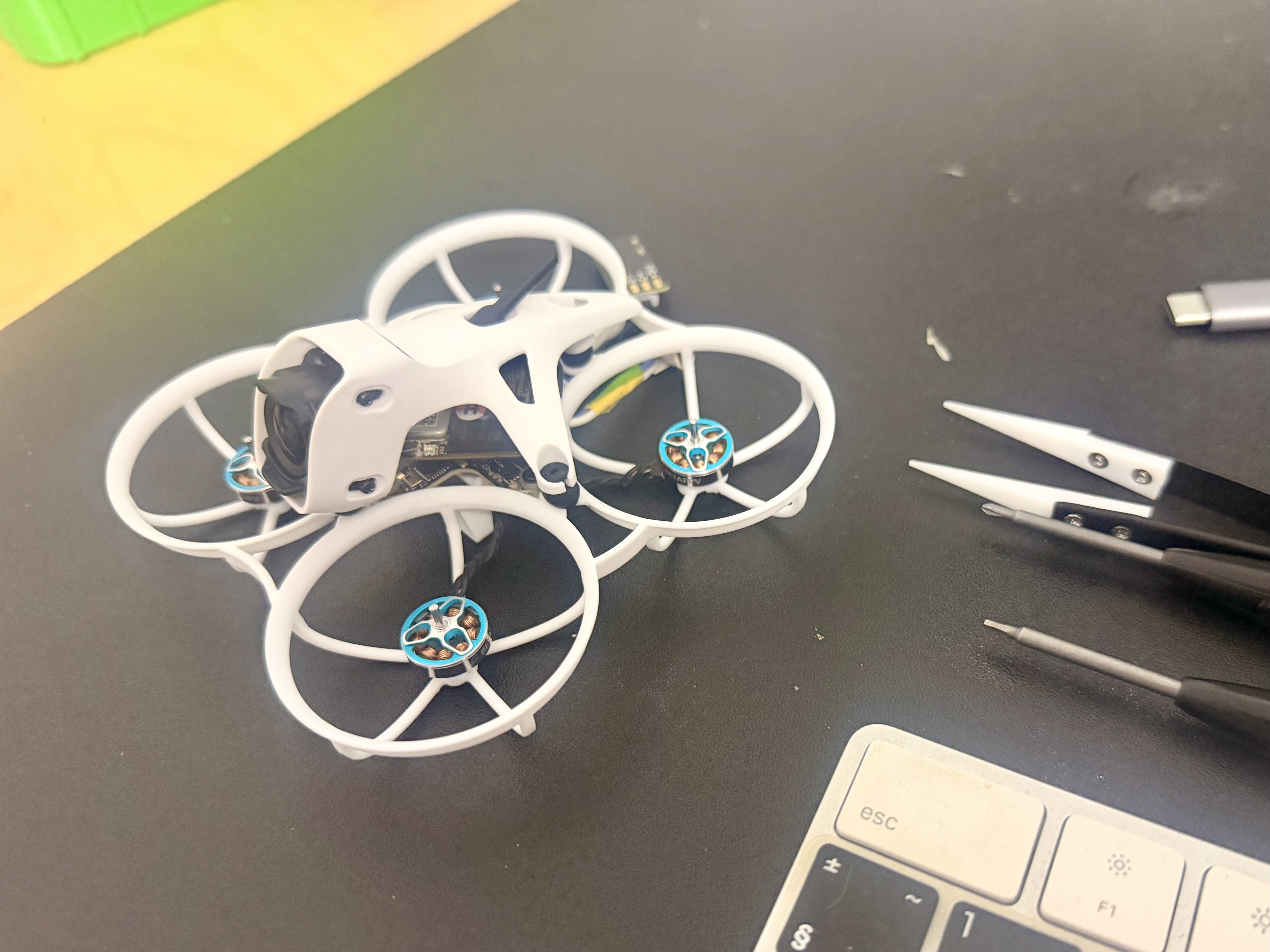

Quick update on transplanting my Meteor Pro 1 into a Pro 2 frame/canopy.
The good news is that everything fits fine. Even the little carbon fibre “X” brace that I had below the main frame fitted on fine, which surprised me as the Pro 2 frame is supposed to be a touch larger.
I am also adding a Flywoo o4 Wide camera. You have to remove the mounting case that Flywoo add (too wide), and instead just use the main camera case. You can attach to the canopy using the smaller screws that attach the Flywoo mount to the main camera case. To be fair those screws (3mm) are slightly too long (the Betafpv canopy is thinner than the Flywoo mount), but they hold reasonably firmly and I will probably replace with some 2mm screws to really lock it tight.
The new canopy looks badass!

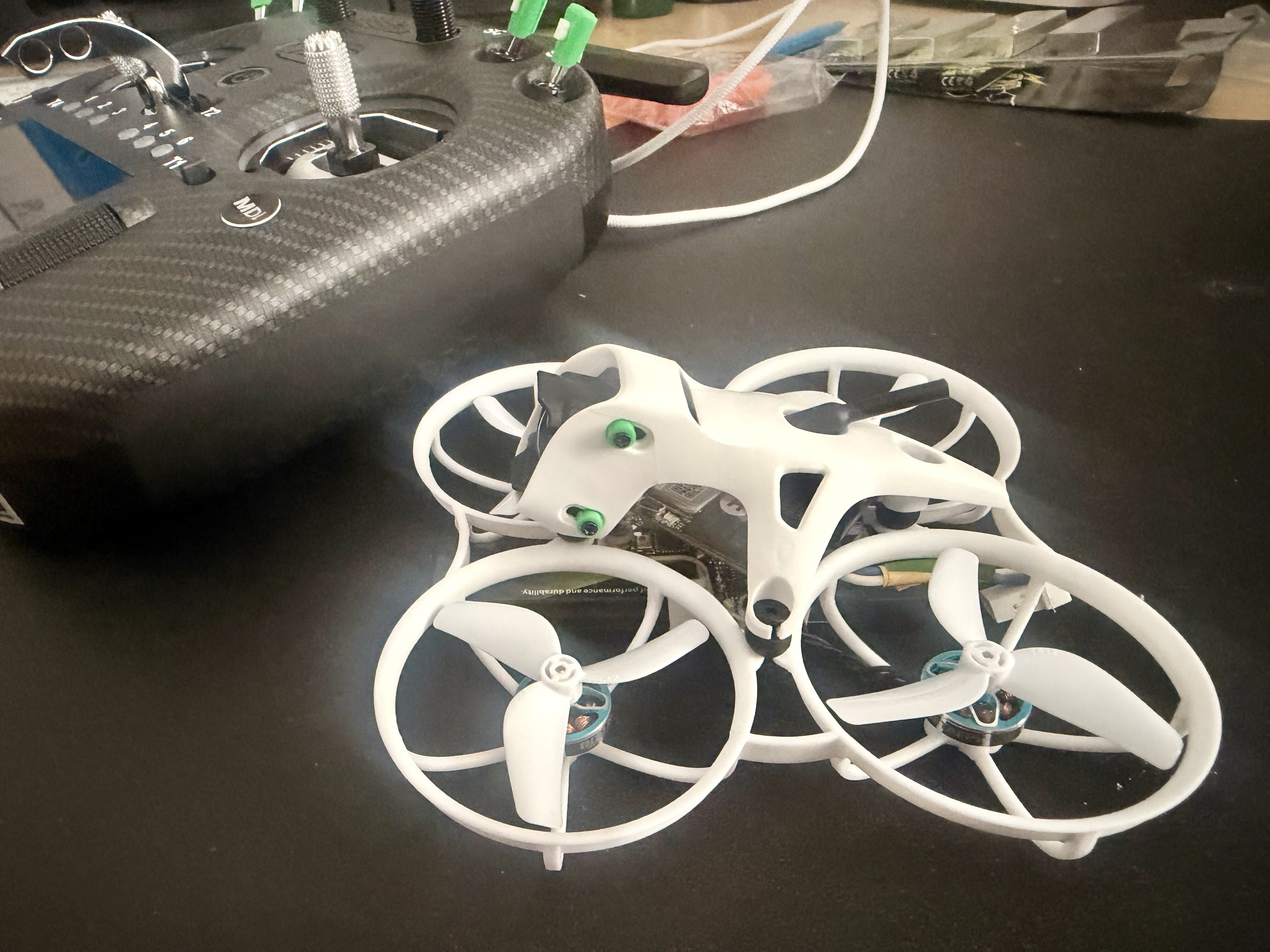

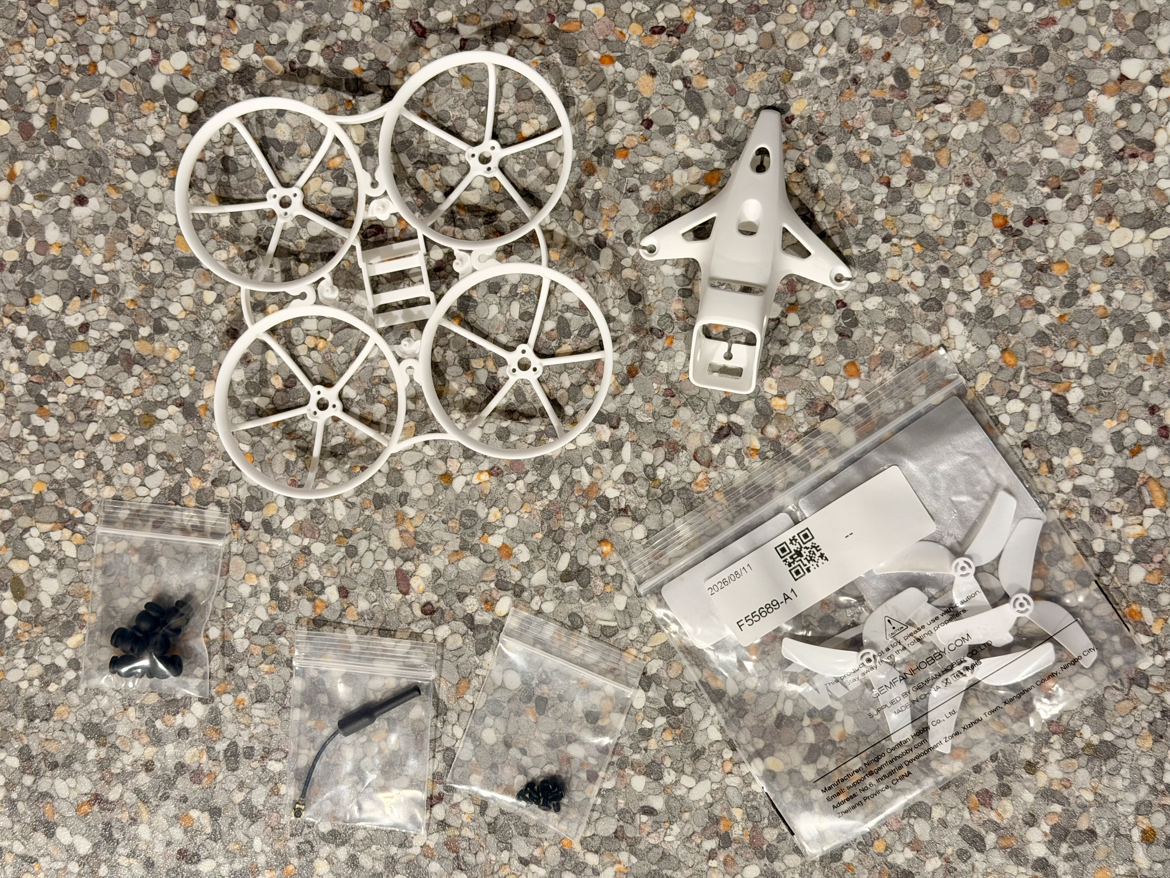

My Frame and Canopy Kit arrived today.
Transplant of FC, Motors & VTX complete.
I’ve just got to check the motor directions, fit the props and test fly it. :crossed_fingers:t2::crossed_fingers:t2:

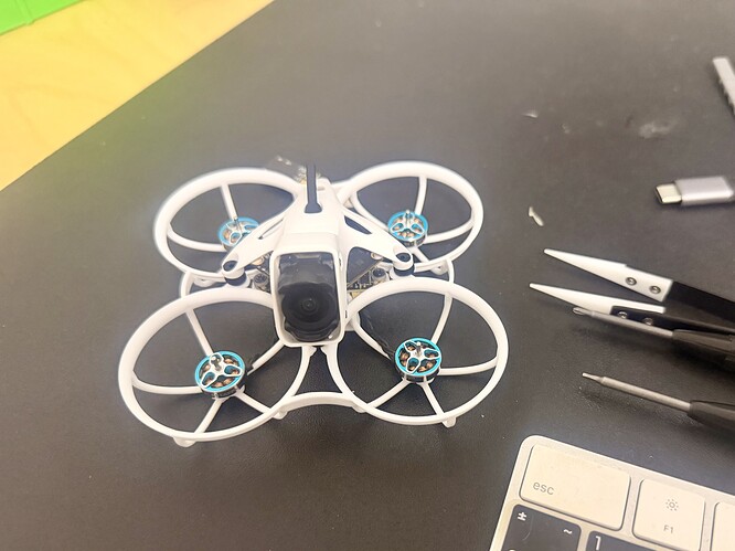

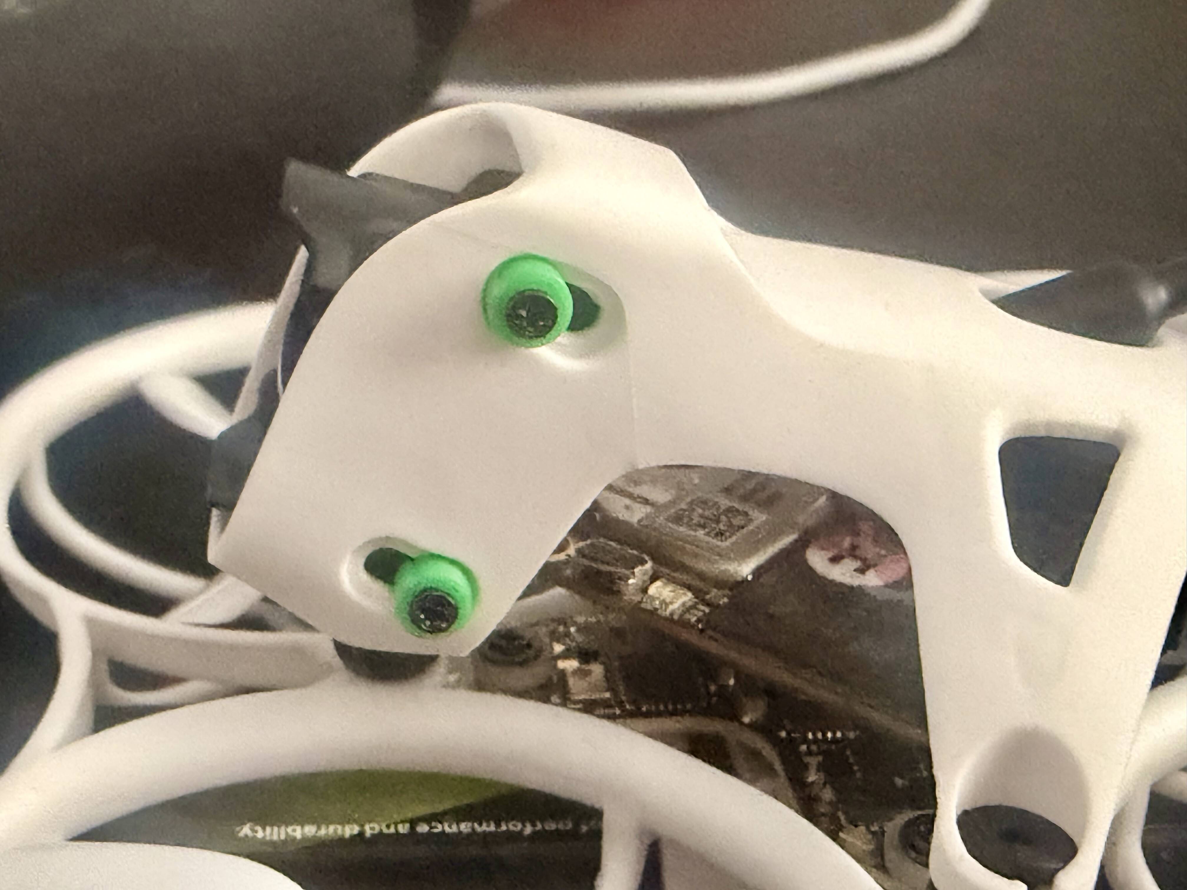

I had a similar problem, after buying another box of various length mini screws, the heads of the M1.4x2mm were too small and passed straight through the slot within the new camera canopy.
So I 3D printed some small washers using PLA. 4mm diameter, 2mm thick with a 1.5mm hole In the centre.
Photos of washers fitted, the camera is now held firmly, using M1.4x4mm screws
Does the camera require M1.4? (I would expect M-two tbh)
Because I’m using the Flywoo Wide Camera conversion kit, it needs M1.4. Original Flywoo kit comes with 3mm but their too long.
