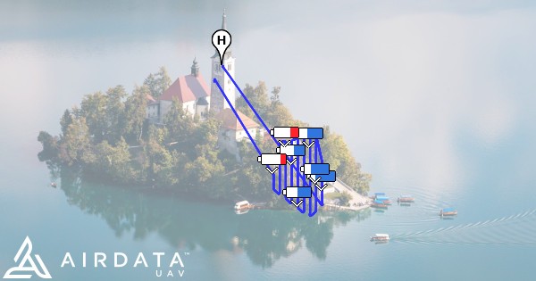

You can get a free account with air data, then you can share it here. Someone might pick up on something that could help your case with DJI and getting a replacement/repair
I’m not great with all this stuff, but I can’t find anything that would suggest a bird strike?
One of the other more cleverer people will be along shorlty, but I can’t see any errors or faults

Strange that the logs just terminate without any error messages of any type.
So - probably not bird strike.
It’s as if it just switched off. But the battery was at 15% … :man_shrugging:
It was in RTH … and the only thing of the slightest note was the the last entry in the log had the largest pitch of the flight … at 51°
