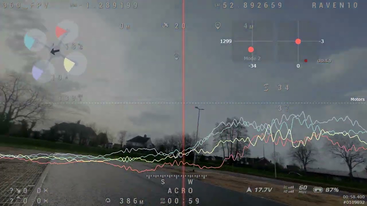

Log 1 – you can see that the gyro tries to correct very quickly - and to do so lowers Motor 1 (while the others are working)
Log 2 – same thing but this time with Motor 3…
As lowered motor is different between the logs - it would suggest you have a wrong config confusing the gyro

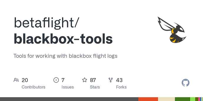

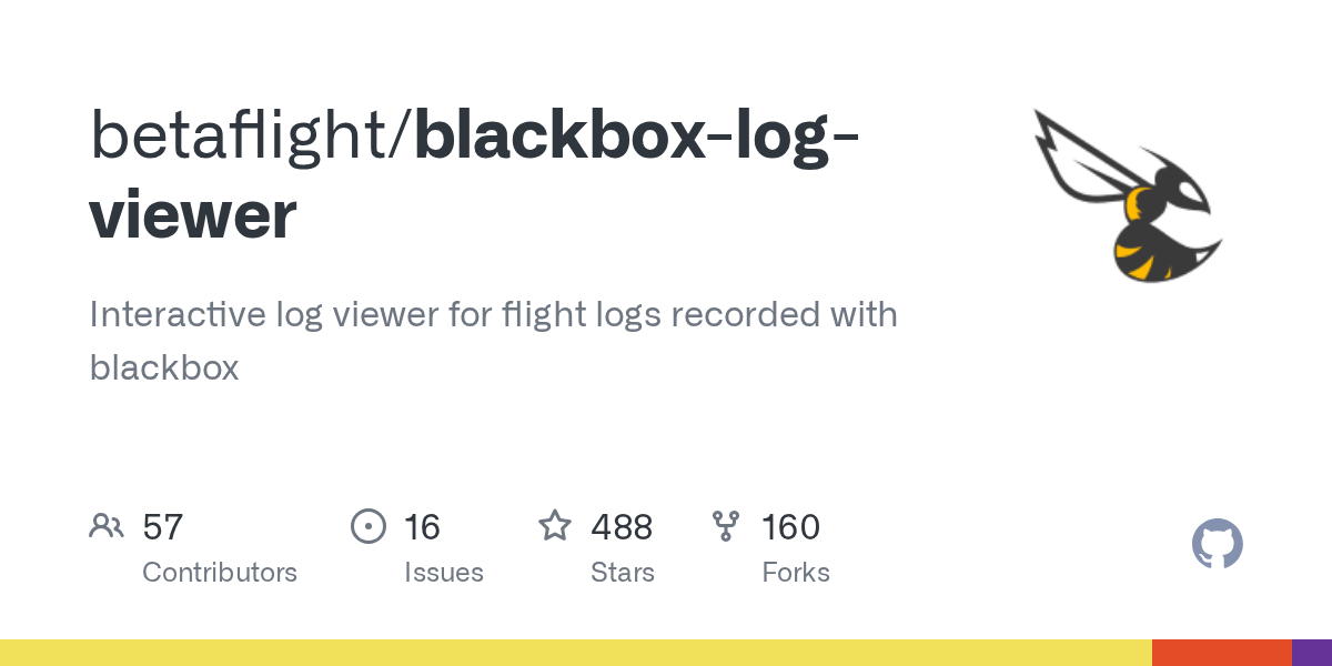

Lots of free analysing tools

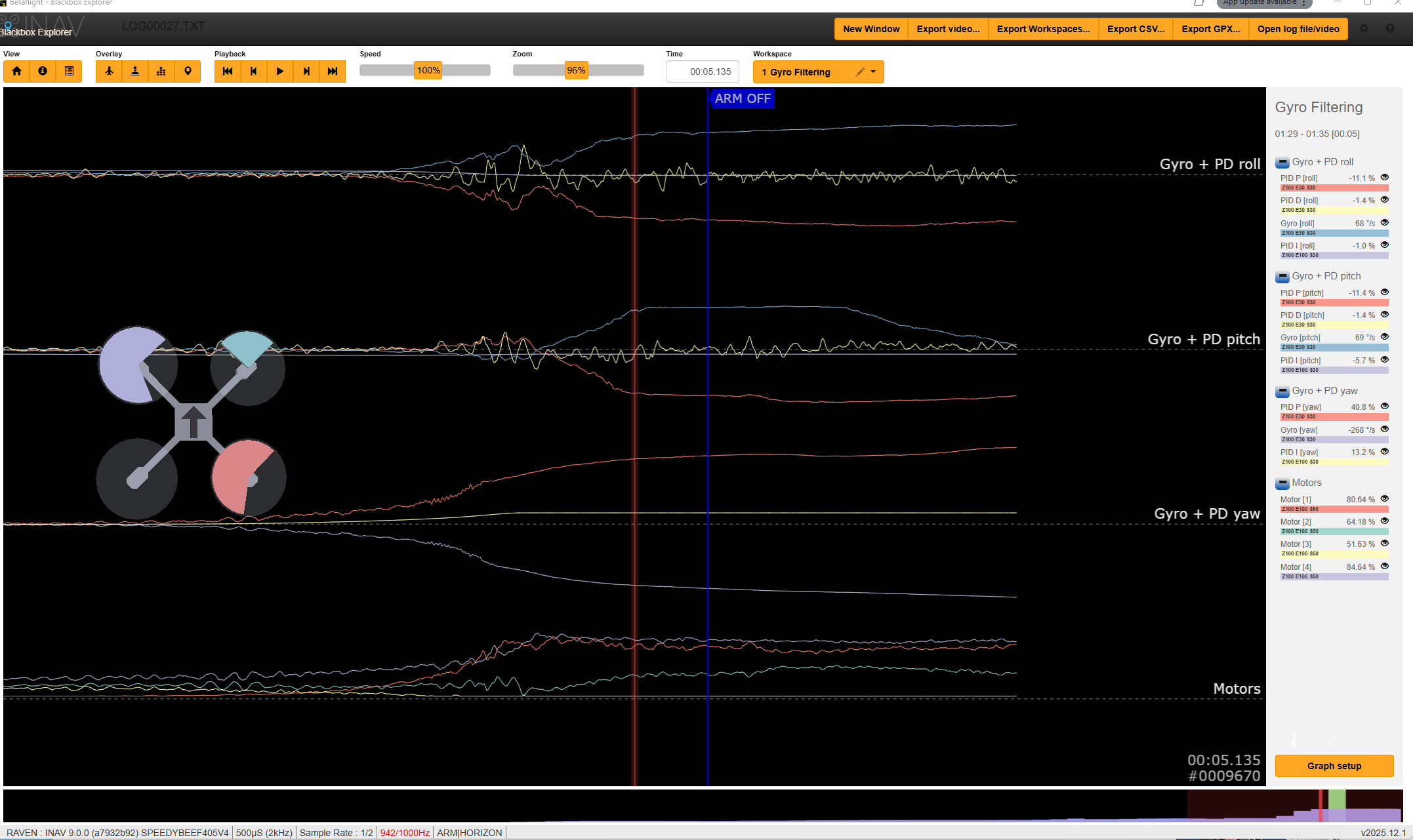

You have some low freq vibrations (seems down to 60Hz-ish) - but I do not believe they are the source of the flyaway’s - you can see in the logs the P-term is maxing out and creating the flyaway (without oscillation) - which is quite odd tbh
If the fly away was the result of the vibrations - you would expect D-term to oscillate wildly and some P-term oscillations.

You can see from the link how much oscillation i have.
