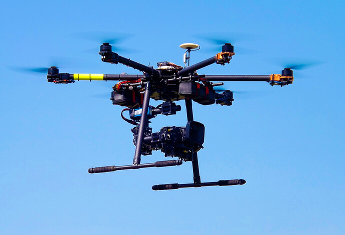

Here is one I built a few years ago.
We’d very much welcome seeing your build thread too @jj2018 :smiley:

The first version of my F550 was fairly vanilla. It had a DJI Naza V2, the ubiquitous DJI 2212 red motors, and the DJI 30Amp ESC’s. Underneath was slung a Zenmuse two axis gimbal carrying a GP3 Black. The build was modular so that I could swap arms/motors/ESC’s out in the field by just unbolting the arm and replacing with another pre-assembled arm. Over the years I have added components to it, including longer aluminium arms, an all-in-one DJI propulsion system, swapped out the gimbal for a three axis Zenmuse one, replaced the analog video system with a digital one, a second RF system for waypoints and mission setup, a telemetry converter changing the Naza protocol to FrSky protocol, and a substantial GF and CF adjustable undercarriage so I could retain a central point of balance with different battery configurations. To be honest it won’t win any points on sophistication compared to what can be built today or bought off the shelf. I recently acquired a Yuneec Typhoon H which cost me significantly less than it did to build my F550 and has greater capabilities, but I learned a lot by building my drone before bought my first off the shelf drone.
