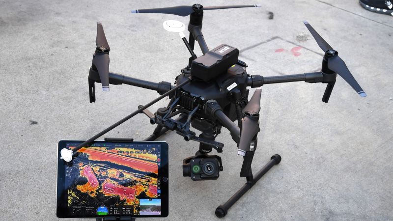

It is a Matrice 210 as used by HM Constabulary who had a habit of crashing them in wet conditions:
