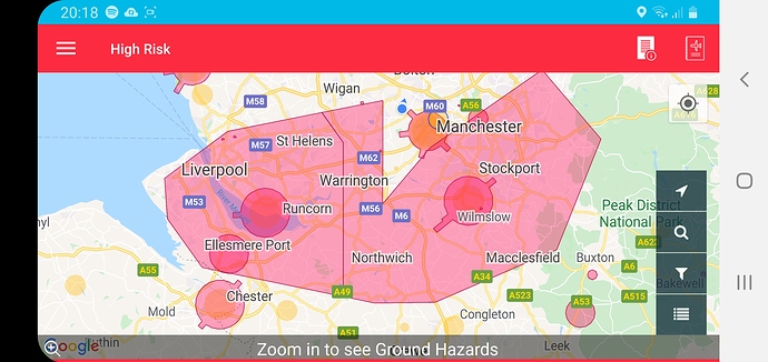

Good evening all
Could anyone please
shed some light on to whether or not we can legally fly in the pink ‘blocky’ zone around Manchester and Liverpool?
Nats Drone Assist obviously says no to the red zones around the airports and runways but does that include all the large ‘pink’ areas?
I wondered if we were to see a cross section through the whole area would it be ‘T’ shaped with the pink areas maybe being a higher altitude NFZ?
Or am I talking out of my arse and unfortunately we can’t fly in the whole pink area without traffic control permission?
It takes a whole load of great flying opportunities out of my grasp that are local to me if it’s a no no.

Moved your post over to this thread that has discussed these issues before.
Tis is the map with Class D airspace removed:
Can you fly in Class D airspace?
" There are no separate regulations in place regarding the flight of small unmanned aircraft in controlled airspace below 400 ft (Class A,B,C,D,E). Restrictions involving the flight of UAS within Aerodrome Traffic Zones are described in Flight restrictions around aerodromes. UAS pilots are reminded of all other responsibilities, including the Air Navigation Order requirements, that any person in charge of a small UAS:
  • may only fly the aircraft if reasonably satisfied that the flight can safely be made and;
  • must maintain direct, unaided visual contact with the aircraft …for the purpose of avoiding collisions. Note: The use of normal corrective spectacles is acceptable within the term ‘unaided’
If operating above 400ft within controlled airspace, the permission to do so granted by the CAA will state that appropriate permission from the relevant Air Traffic Service Unit (ATSU) must also be obtained."
(From CAA publication)
https://www.caa.co.uk/Consumers/Unmanned-aircraft/Our-role/Airspace-restrictions-for-unmanned-aircraft-and-drones/
Yes you can, subject to local restrictions, but stay vigilant.
Here is a zoomed in view of the class D airspace that surrounds LBA, the little yellow blob in the pink area is actually the site of my local model flying club.
Nidgeimage
