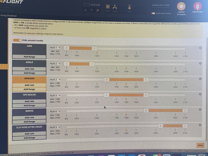

Have you setup an arming switch in your modes tab Howard?
Yes, all modes are set up and work when connected with the tango 2.
Unconnected from betaflight and nothing
@Howard78 can you share the screen in discord and i couldhelp i use only crossfire
Er. the little tag on the arm row is not in the orange slider bit. You may have to resize it.
thanks, mate - that’s what I get for trying to do this when tired :man_facepalming:t3:
Sadly this didn’t work either
Will do that now mate - thank you
Odd… did you save the page?
Another screen shot?
Is it waiting sats? Or have you disabled this
Did you check both ends of the Arm switch as that left end is for disarming?
Very good point probably this
