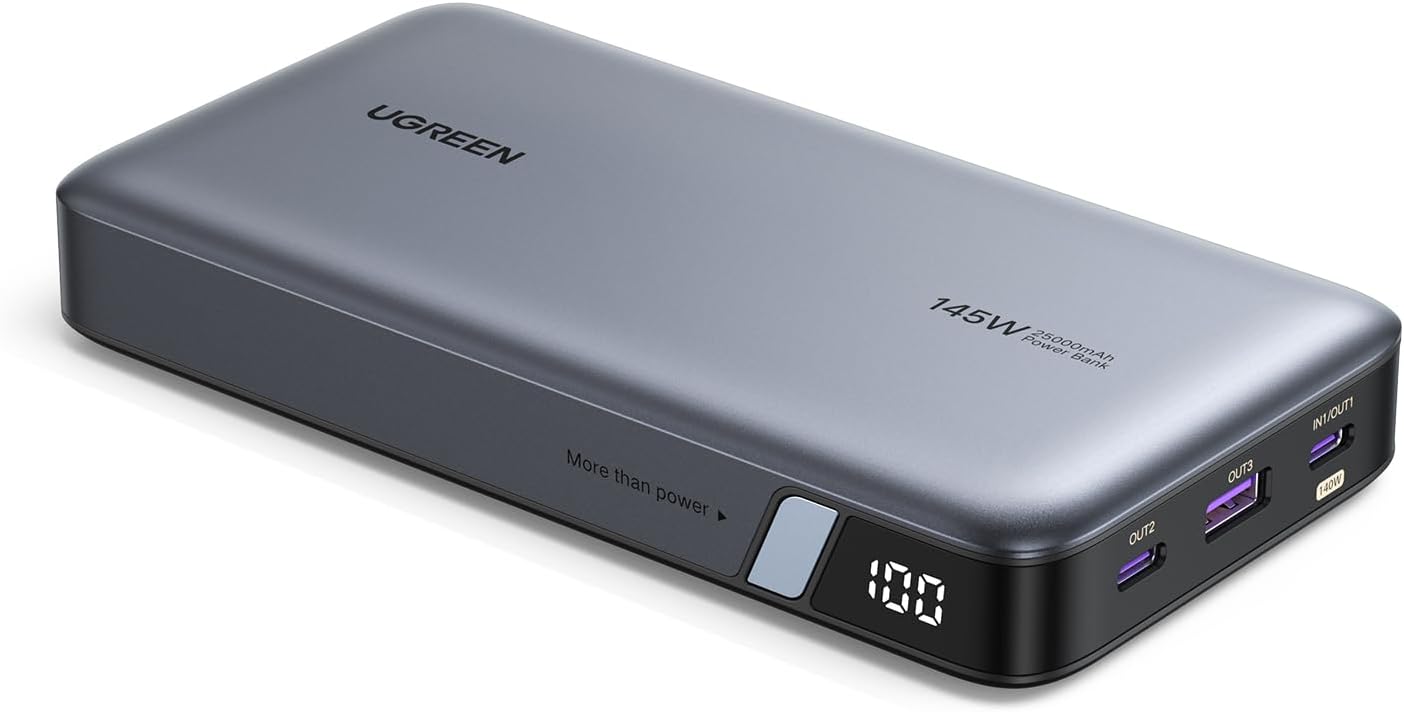

What about something like the ‘UGREEN Nexode 140W 25000mAh Laptop Power Bank’. Ugreen is a very good trusted company. Having 140W is way more than required, but not a bad thing. The 25,000mAh battery is nice and large. You should expect between 15% - 30% energy loss from a battery pack, so at worst this will have 17,500mAh or 21,250mAh at best. This should then be able to charge a Neo 2 battery between 10 & 13 times. This could be a perfect solution for under £50. Any thoughts?
Yes they are ideal, will charge 3 batteries easily enough
I have this one, it was only £40 when I bought it last year
Hmm… I’m not sure that’s right? :thinking:
You may be just dividing 21250 by 1606 watt-hours to get to 10-13 charges, but that won’t take in to account the voltage differences between the power bank and the DJI battery.
I’d realistically expect 6-7 charges.
But £50 quid is still cheaper than buying DJI batteries at £35 a pop :smiley:
You are very right, I did just do that. I didn’t think about the voltage difference at all.
Thank you for pointing that out. As you said though, is still cheaper than buying extra drone batteries, and takes up less space. I think I will get one, but will see if the price comes down in a few months.

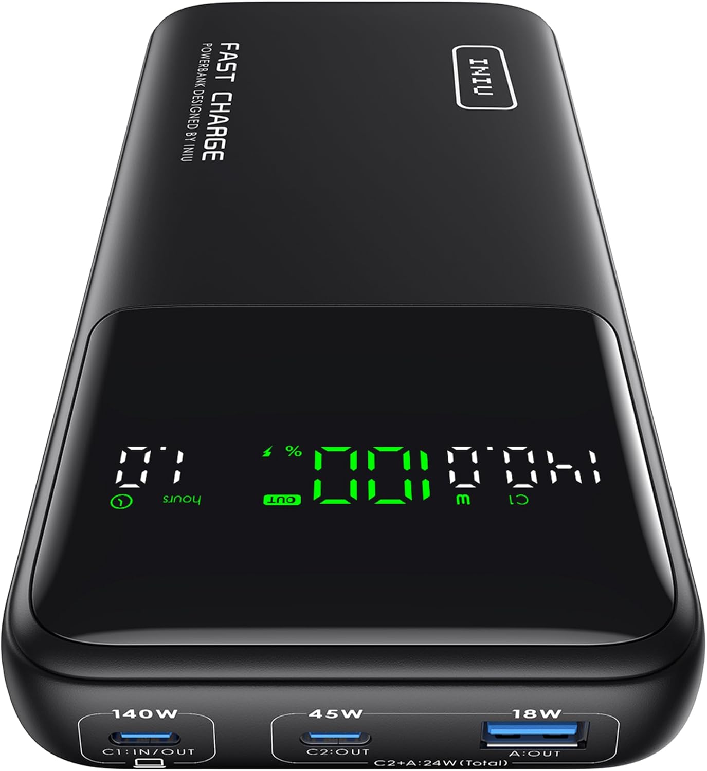

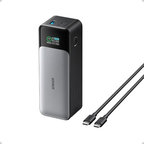

I have have these 2 and happy with them, they each will charge a full battery hub of 3 batteries twice.
Thanks @Seadog, I do like Anker so will add this to my short list.

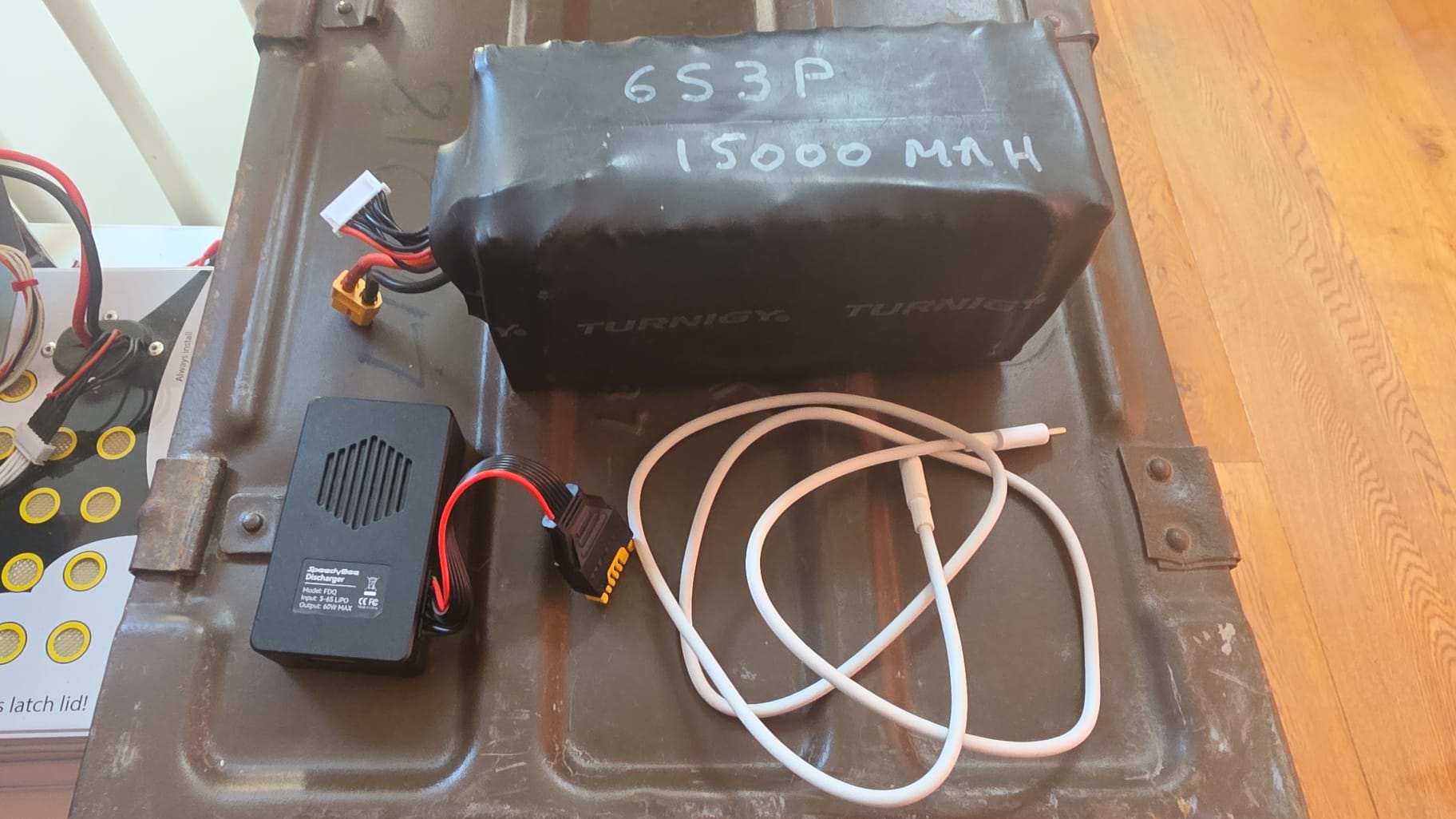

if you build your packs yourself, or can do simple soldering / spot welding - a 15 AH (based on 21700 cells) pack 6S with a simple transformer can provide you 45w via USB:
