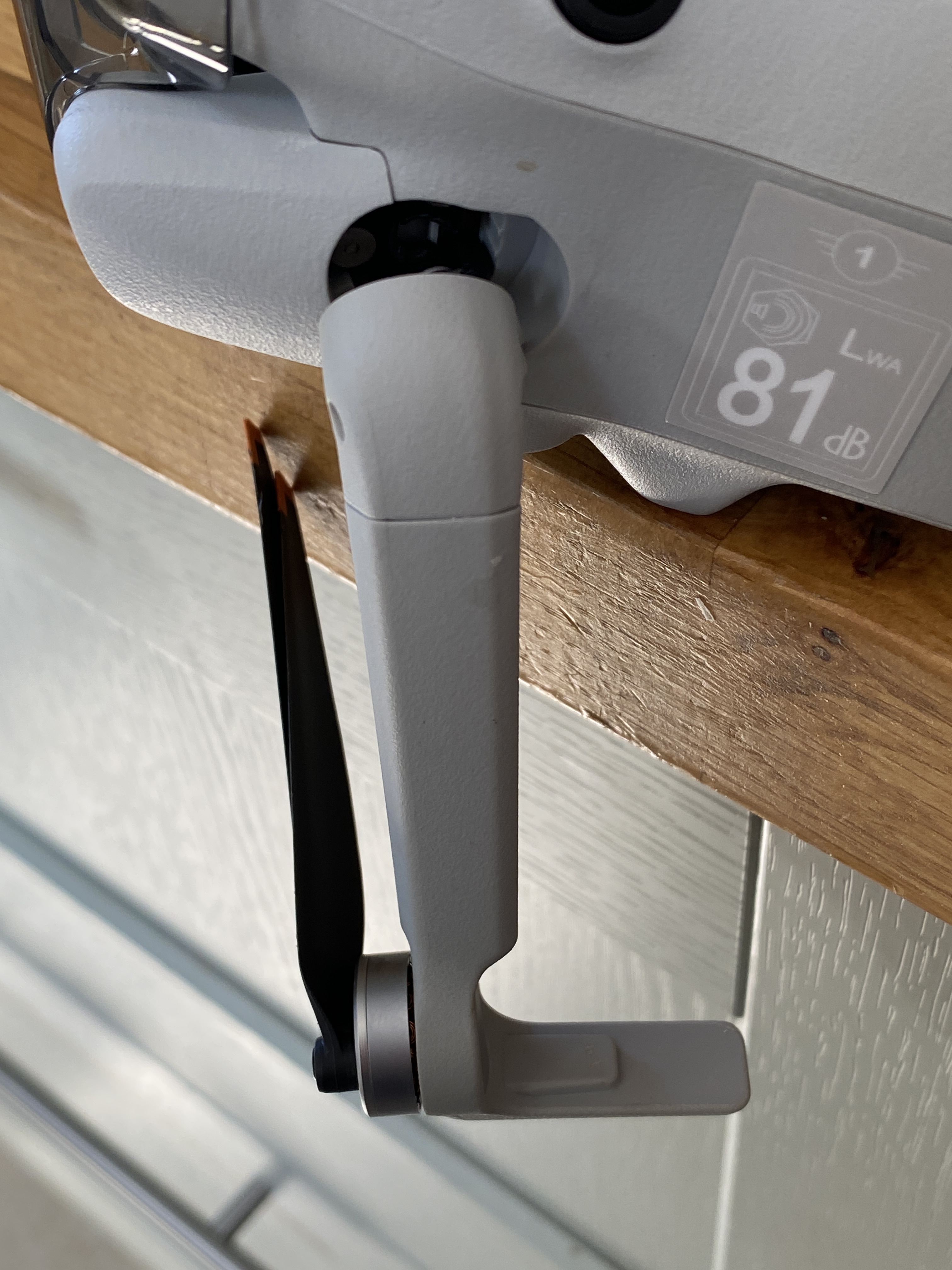

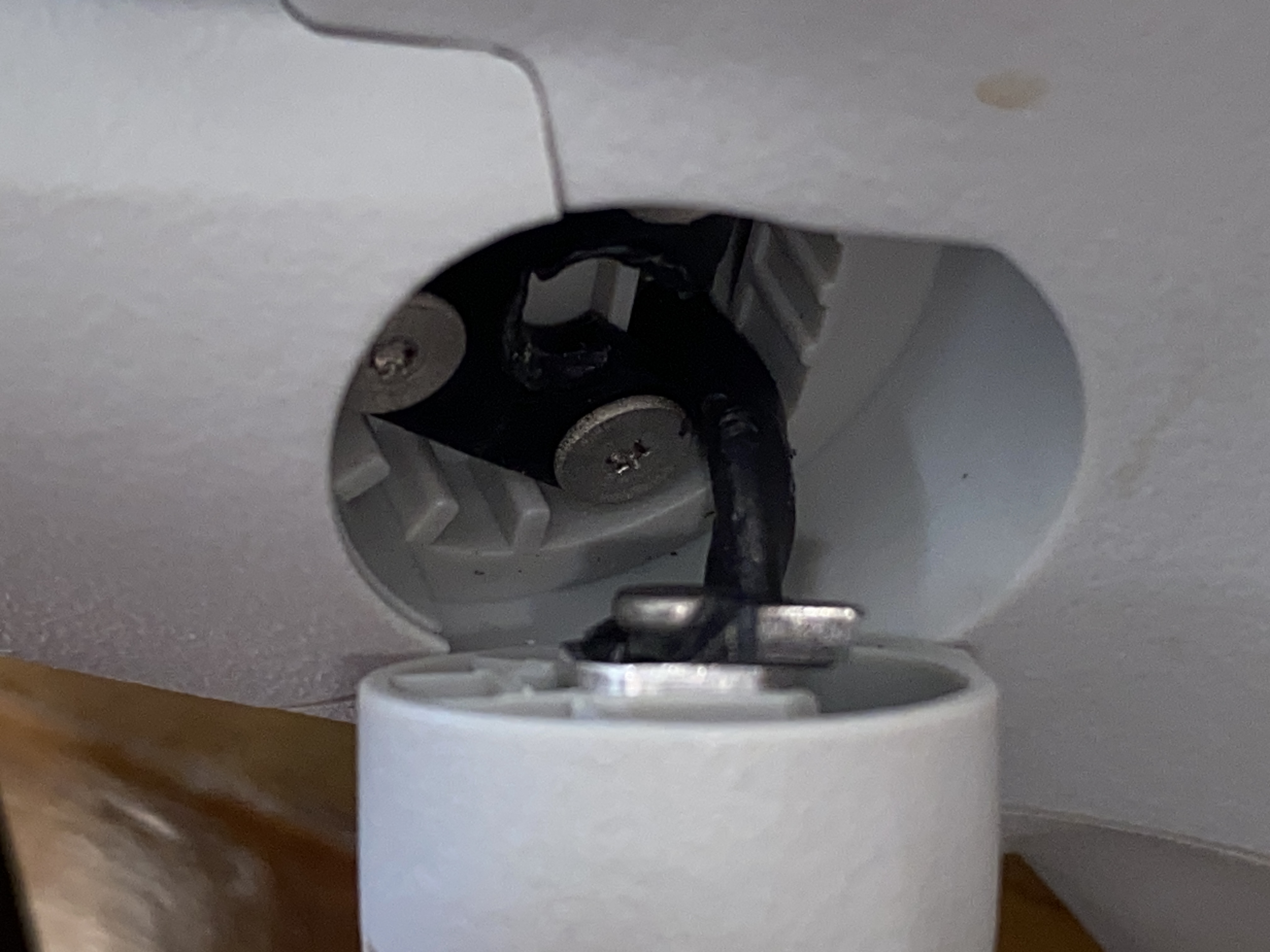

I would happily, but I broke my new Mini 4 Pro this morning filming a crop circle!!! Drone decided, with 12% battery still left, to land with no warning in a barley field and one of the front rotor arms caught a barley stalk. :roll_eyes: :enraged_face:
Not sure it’s an easy fix or a job for the Drone clinic. Any thoughts?

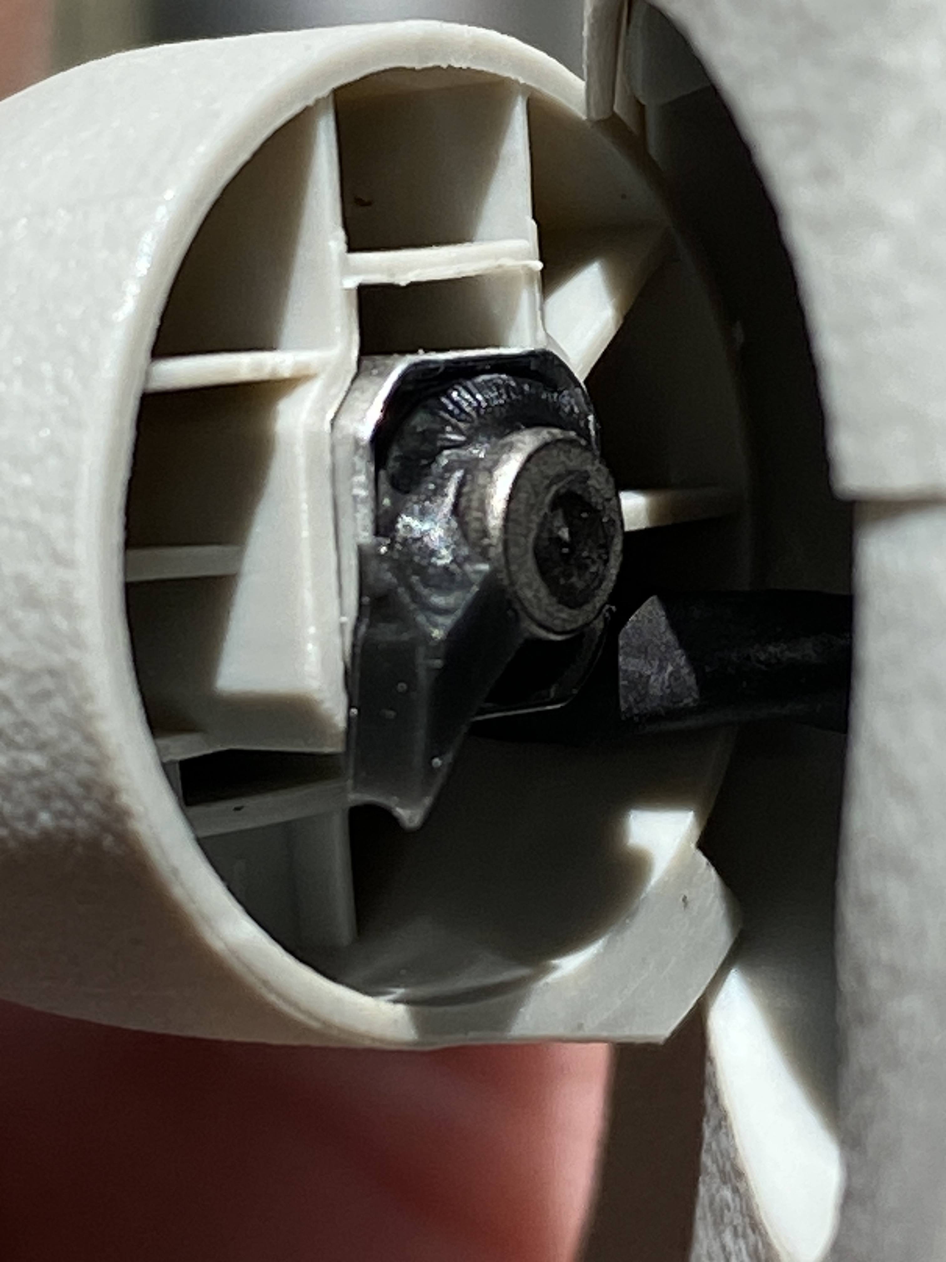

It’s difficult to see precisely which component is broken .. but it must be part of what retains the arm in the body.
None of the plastic of the arm looks to be damaged.

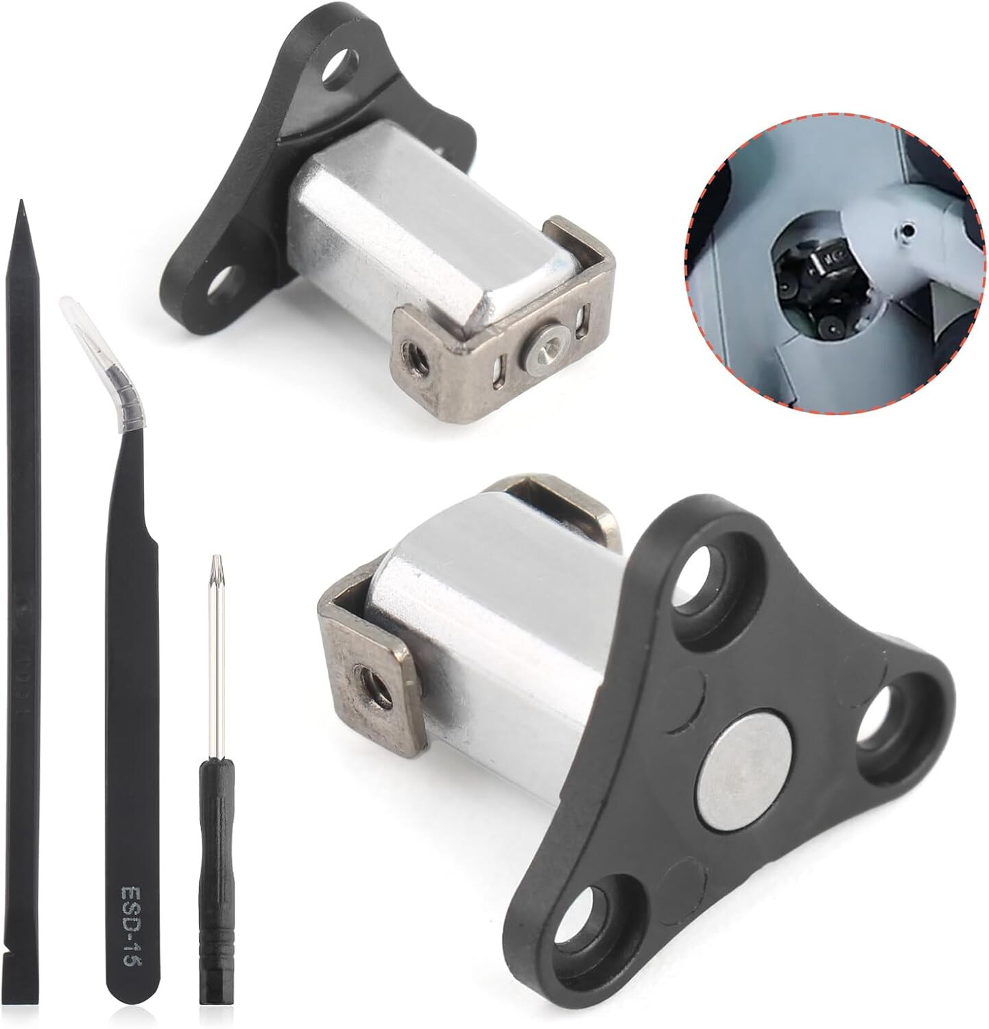

Chances are this kit might be all you need …

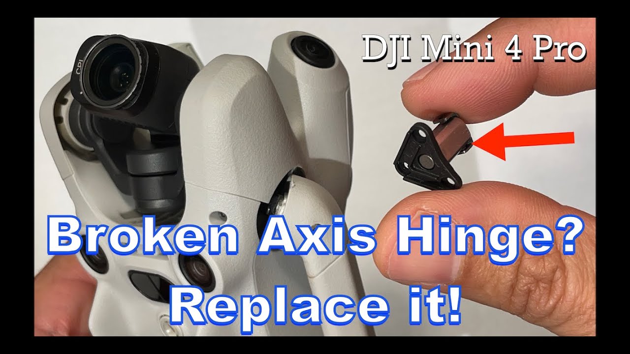

.. and then a few hours of watching YT how-tos and some tinkering. :wink:
Watching the YTs might even help you identify precisely what’s broken.
I would have said the same only looks like the axis needs changing to me :face_with_monocle::crossed_fingers:

You’re right, this does look like all I need! Thanks so much Dave, thats an enormous help and gives me confidence, that I might be able to fix it myself!!
