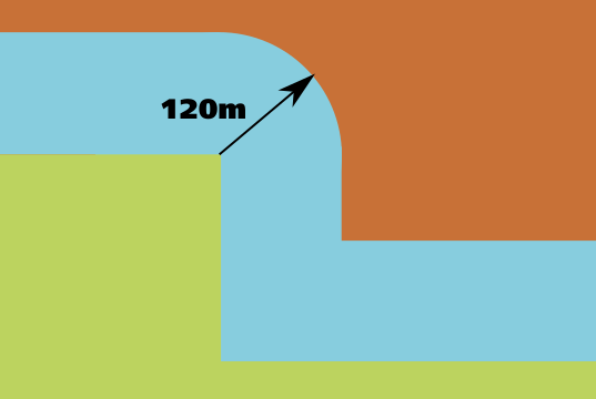

The exact wording is, “Your drone or model aircraft must never be more than 120m (400ft) from the closest point of the earth’s surface” (my emphasis). The 120m limit “above” ground level is actually “away from” ground. If we take the helpful diagram from the CAA and apply it to a cliff, you’ll get this.
So you’d need to be 120m away from the cliff face as well to be in breach.
