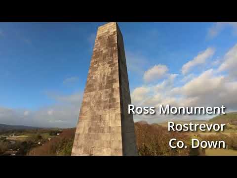

Got out for a couple of flights in 2 different locations near me yesterday, was supposed to be maidening a fixed wing mini sloper but the wind didn’t cooperate so I got the quads out instead.
Looking good! A couple of bits of advice…
The first location had a load of “jello” in the image. This could be fixed by more ND (I see you had ND8, maybe ND16 or higher (Edit: ah, in the description you mention you forgot it… doh!)). It’s quite dark already, so maybe you need to look for the source of the vibration. It’s usually a bad motor in my experience. BF Config motor tab can help find out if that’s the case. The second one had a bit of “Jello” as well, but not as bad as the first.
I think the video would probably look nicer with Horizon Levelling turned off. You loose the swoopy feel of FPV flights with it on.
Anyway, some nice locations to fly there!

Watch the first section. Especially around 2:07.
You can see the whole image is distorted a bit like looking through Jelly. It’s caused by vibrations faster than the refresh rate of the camera. They’re making the camera shake mid-frame. An ND filter will slow the exposure time down sufficiently that the jello is reduced.
I’ve linked to a part where it is particularly noticable.
BTW, normally Jello goes from top to bottom… but in this video it goes left to right… this is probably because the camera is mounted 90 degrees out from normal…
