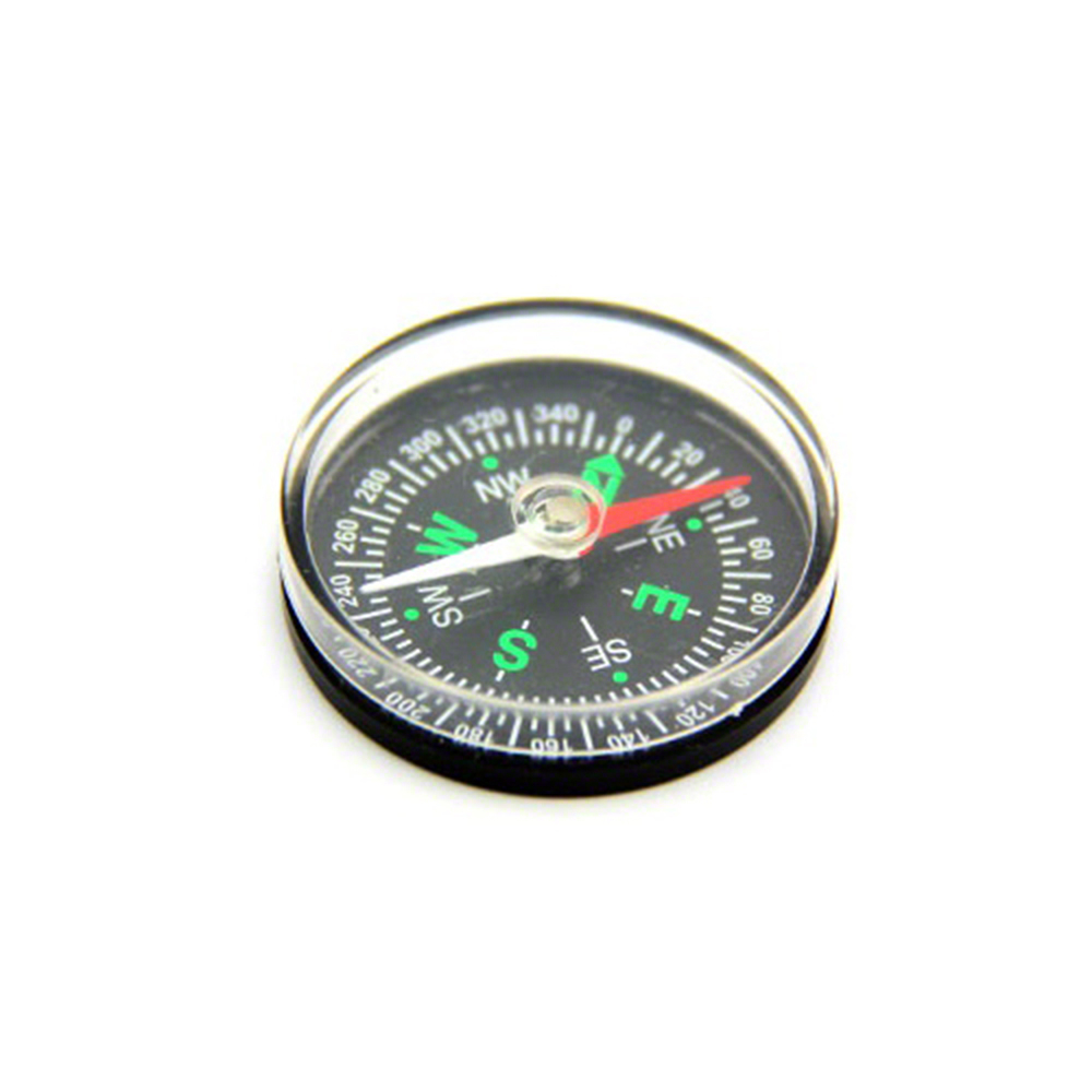

Just glue one of these on it, then … and you’ll have two, like the MP. :+1:
Might as well go all out and stick half a dozen on it.
At least they don’t need calibrating! #Bonus! :+1:
