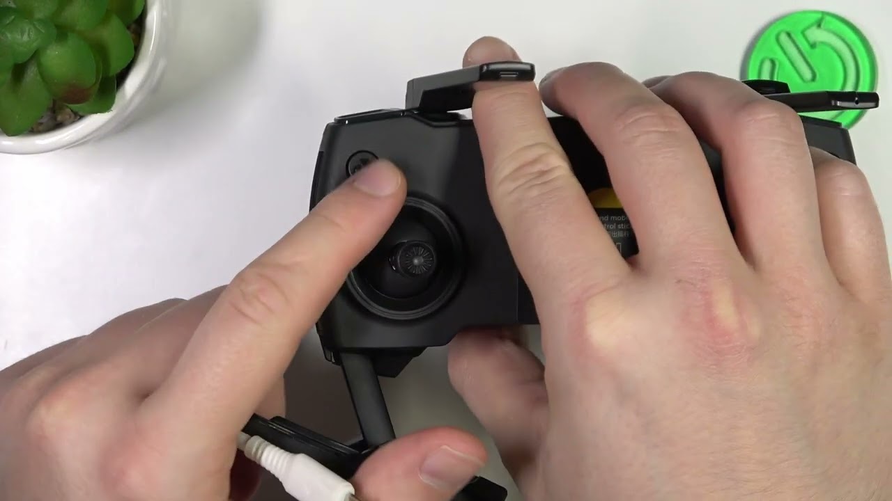

Yes, you charge from the same port your phone would plug into:

The RC can be charged using a standard micro-USB plug … even though the RC socket is more rectangular.
My RCs for my Mavic Pros have the same connector, been using micro-USB to charge them for almost 8 years without a problem.
But, caution. They work perfectly in only one orientation. The wrong way can damage the little tab on the socket. The micro-USB will go in really easily the correct way.

Thanks guys, it makes more sense now. Battery charging is sequential, one battery at a time not three simultaneously, and takes a long time, and the mystery of the DJI micro-usbs is solved; they’re just ordinary micro-usbs that are a funny shape. I will RTFM!
