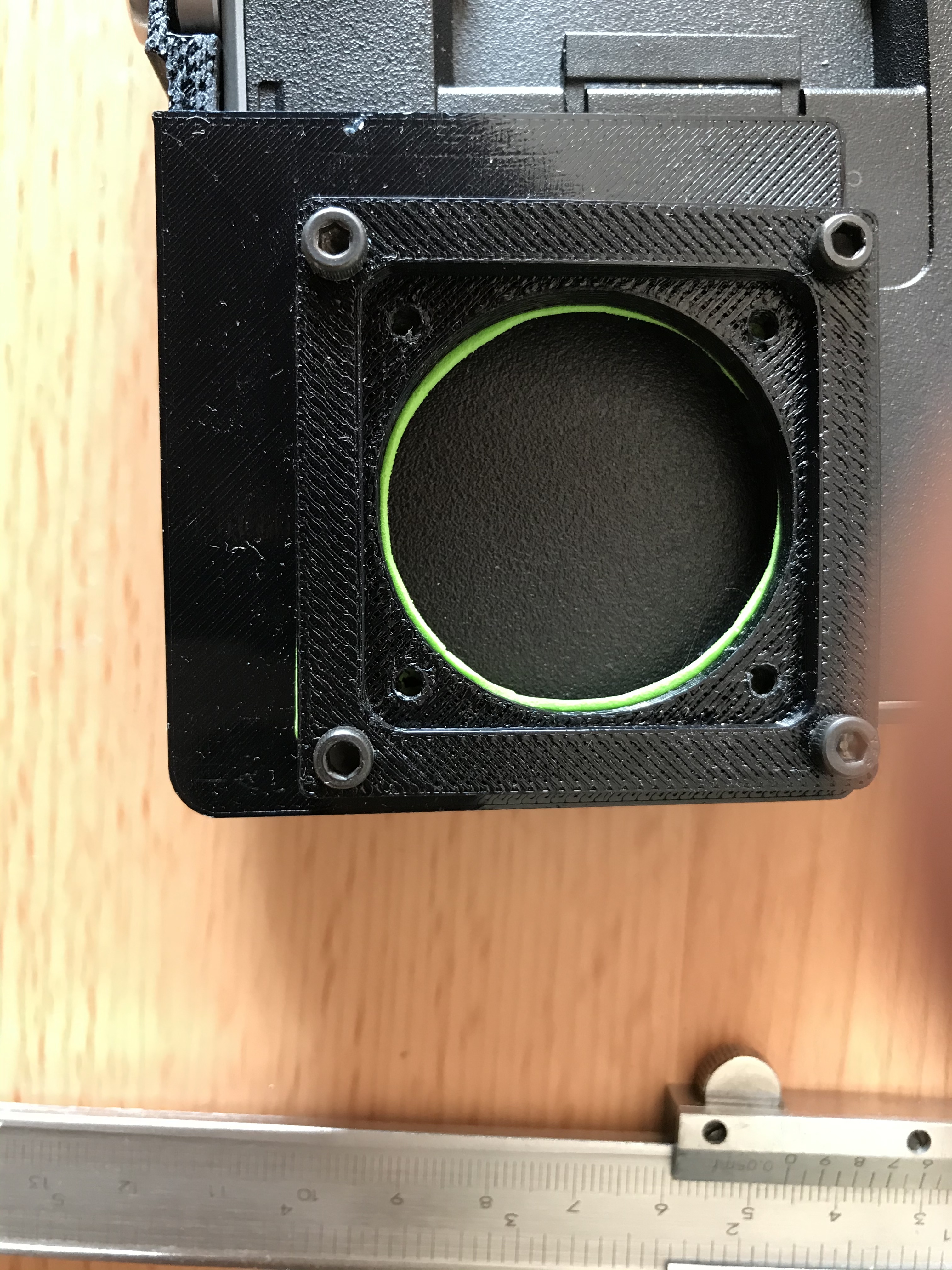

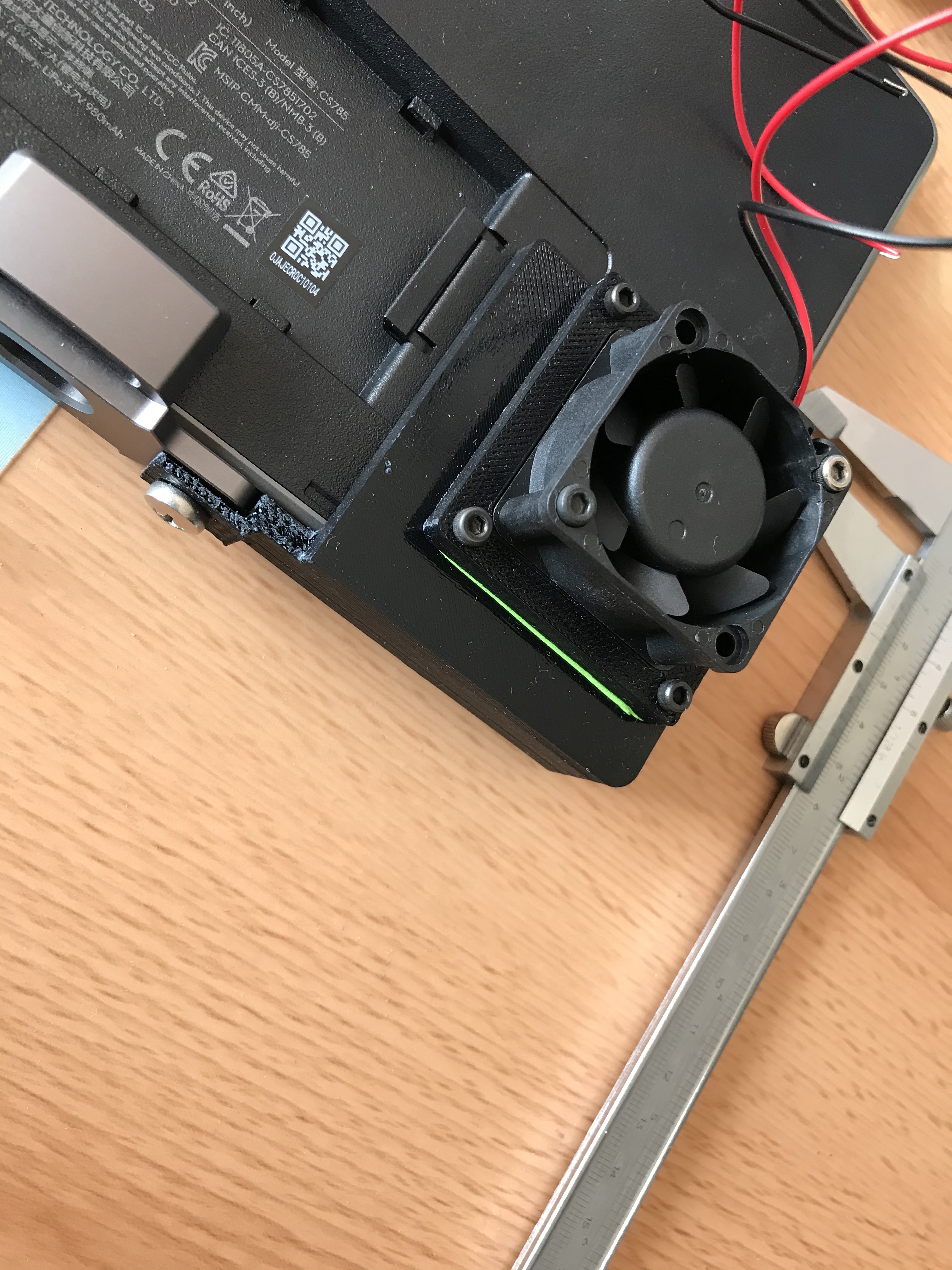

So prototype 1.2 has come off the printer,I’ve inserted M3 thread, raided her cards making stock pile for some foam to make gaskets.
I’m really pleased with the air flow from the ports thanks to the 12V fan running at 16v. I’II setup the monitor to ran an entire battery to see if it more stable.
I’m already planning some slight design changes, mainly to accommodate the thread inserts closest to the edge to move them in a bit.
Only clicked on the wrong size fan on eBay…
Update… blowing through the audio jack has cooled the Crystalsky by 2.5 degrees, to get this average I set up the Inspire for some garden bird watch in order to tax the Crystalsky cpu and electronics.
I then did the DJI update and without the external fan the Crystalsky is running a lot cooler too.
Conclusion is the external fan will be handy on a very hot day, keeping the electronics cool means longer life.

So having taken the Crystalsky apart and drilling some vent holes for the fan to breath better, it has actually ran cooler.
I may have found the culprit causing it to shut down…
Before I write about my latest discovery,I’ll just include the pictures of the butchers version of attempted solution.
