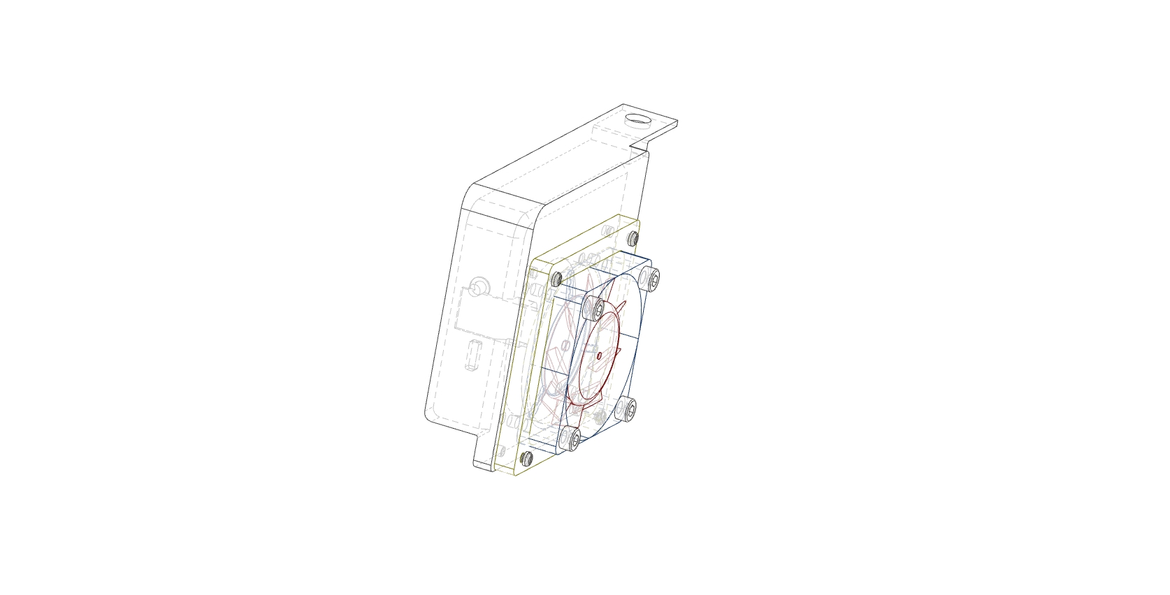

I’ve decided to experiment with an external cooling fan blowing air through the audio jack, I’ll be testing a 12V ball bearing fan.
The fan will ran off a 3 cell lipo which I’ll have in a pocket, I’ve done the 3D drawings all ready for the fan to be delivered some time next week.
Some pictures.

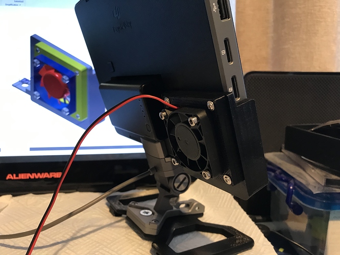

Part 2 completed…
Did you not fancy using a 5v fan powered from one of the usb sockets mate?
Not really, one; I’m not sure how stable the current draw would be with these cheap fans and my 5V fan that I have just doesn’t have the blow needed to push air through the audio jack.

I’m thinking of maybe powering out of the TX charge port, I’ll look for the right jack somewhere in the work shop.
The mount is now complete, just needs fine tuning.
Looks great!
Still flummoxed as to why it’s required though :grimacing:
Is that 12v straight out the back?

I’m not happy it physically overheats, for me I’d rather try to physically cool it down using a fan rather than a DJI firmware update which I believe will only work if they throttle some feature in the Crystalsky.
Here is the size of lipo I’ll be using…
The general idea is this…
