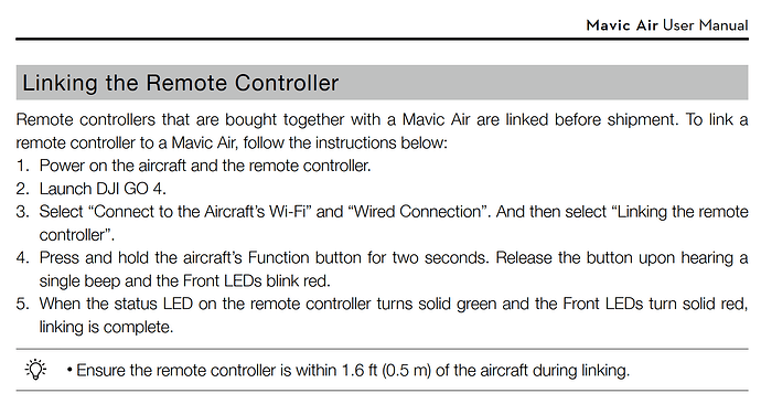

Have you tried the re-pairing procedure?
When you upgrade your firmware on the aircraft did you upgrade the controller too?

Linking the controller and aircraft

Thanks for answering the questions. The controller is connecting now (don’t know why it wouldn’t before). I will probably give Litchi a try.
