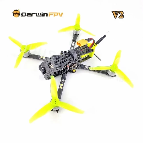

Looking on Ali Express and I see the winter sale starts tomorrow and there will be Darwin BabyApe Pro v2 bnf ELRS for £66. I know they’re cheap for a reason, but at that price is there any reason I should avoid?
Has anyone here got one and upgraded the vtx? If so, what vtx would you recommend?

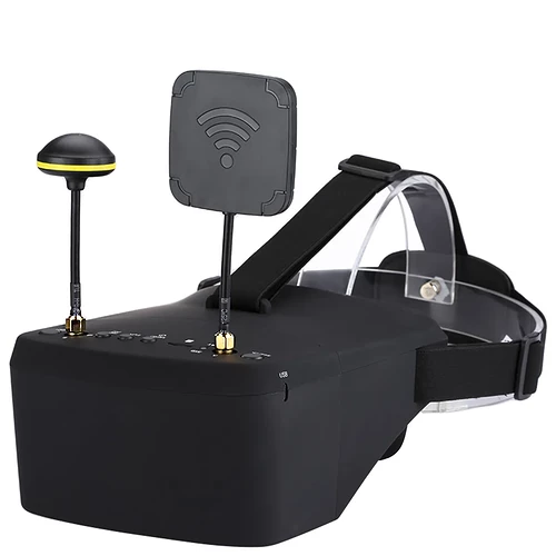

I’ll also be ordering Ev800d goggles in the sale. All in, the whole lot will come in at £175 plus batteries.

Don’t have one myself though do want to grab a 3-3.5" at some stage. Looks like the frame comes apart easily enough so just need to check flight stack to see what VTX compatibility there is; never heard of those goggles either but am sure someone will have some :slightly_smiling_face:

It’s this one here. Whilst it says PNP, there is the option in the order for an ELRS BNF version
DarwinFPV Baby Ape Pro V2 3 Inch 2-3S FPV Racing RC Drone PNP Quadcopter F4 FC 15A AIO ESC 1104 Motor 5.8G VTX Caddx Ant Camera
The goggles are these ones

My main consideration on getting my first drone was trying to pick the right techs that I wouldn’t be starting over when I wanted to upgrade. I don’t know how long those “moggles” will be good for, for example, but again, given how cheap they are, if it gets you out flying quick, :+1:

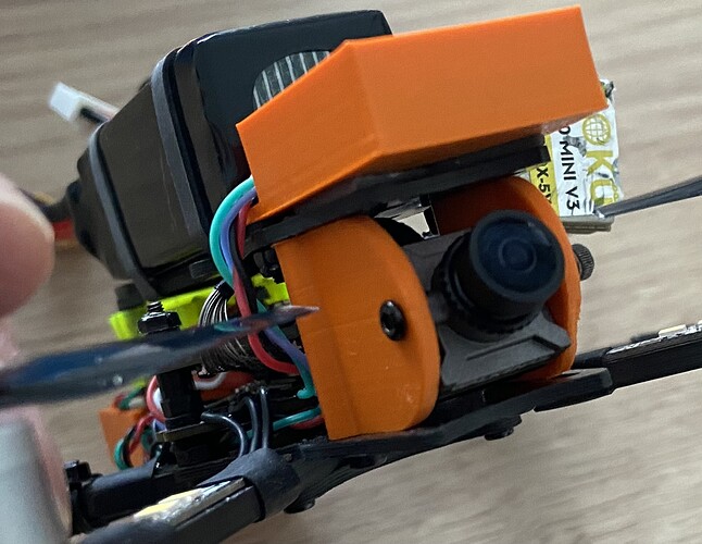

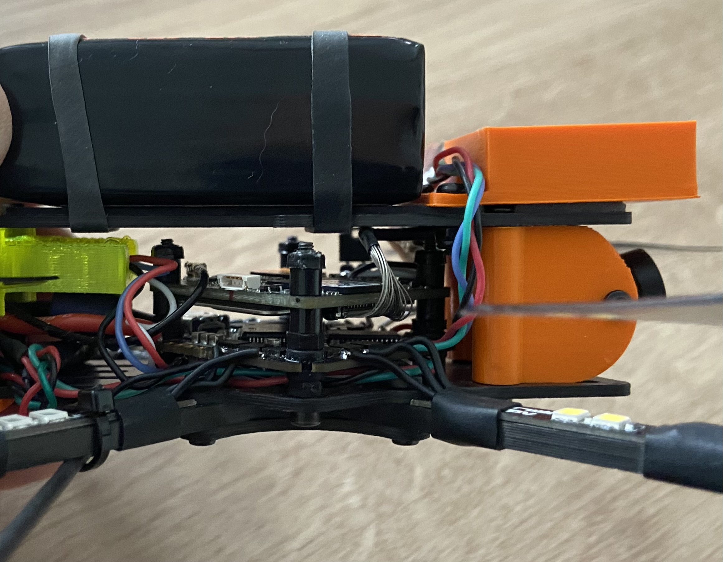

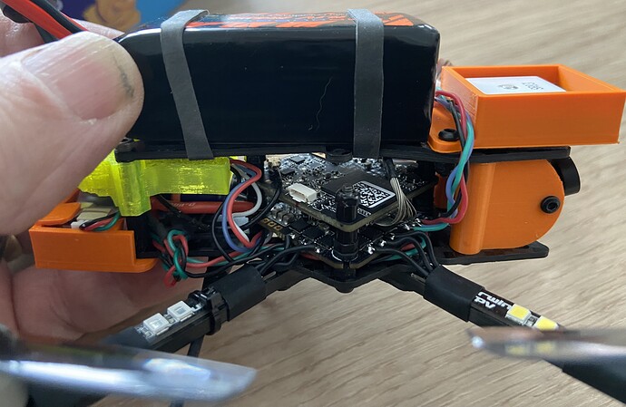

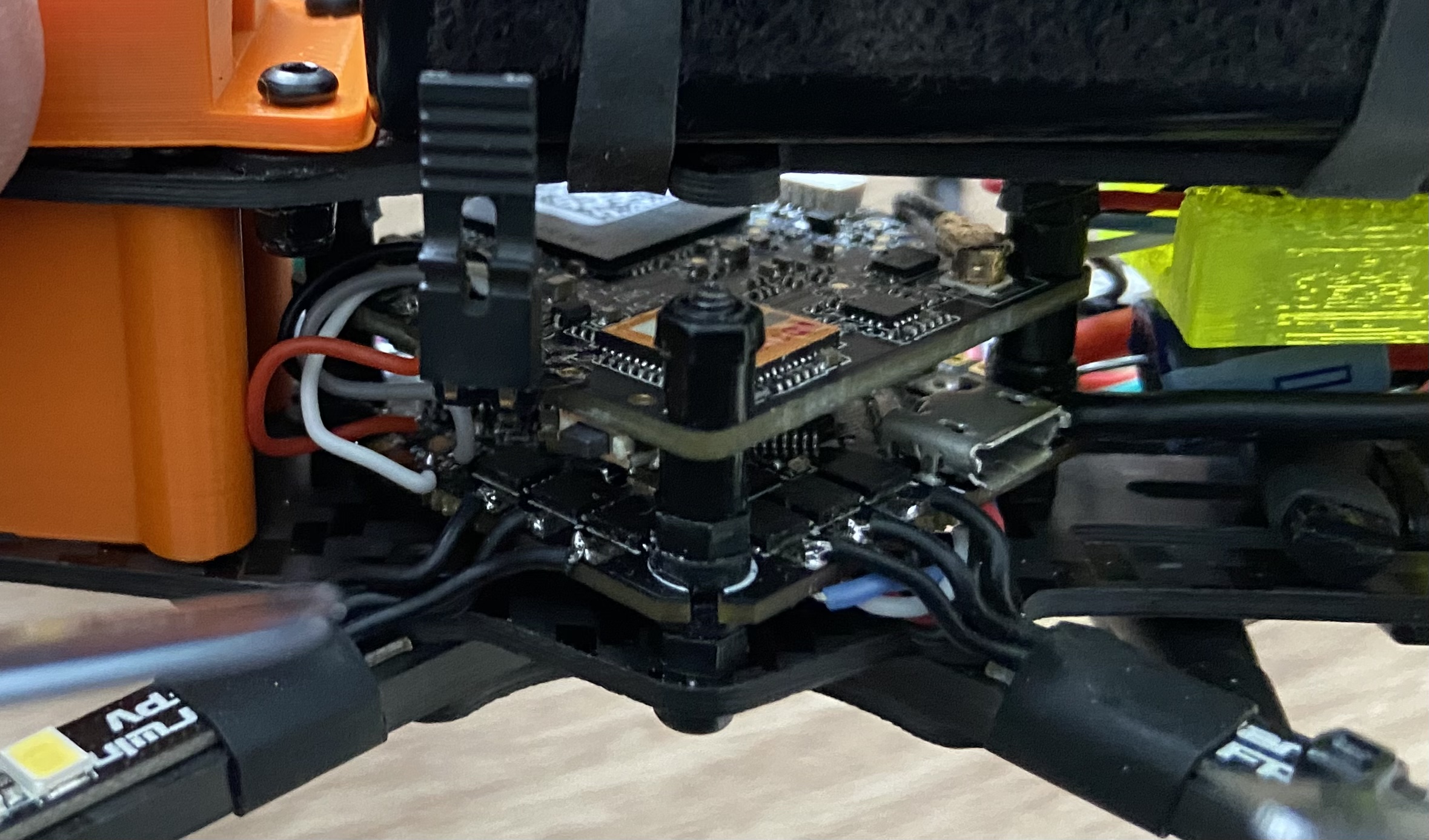

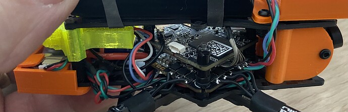

I’m definitely interested in that walksnail conversion. Is it an easy fit in the Darwin frame?
Yes, same mounting hole sizes as the FC.
3D prints in TPU for the camera
Raised the top deck up a few mm’s with longer spacers to create more air gap for cooling
Simple RX/TX and power connections straight on to the FC
I wanted GPS so I changed FC to gain more uarts also added a Vifly buzzer but not essential for the Walksnail mod
I’ll post some photos :grinning:
