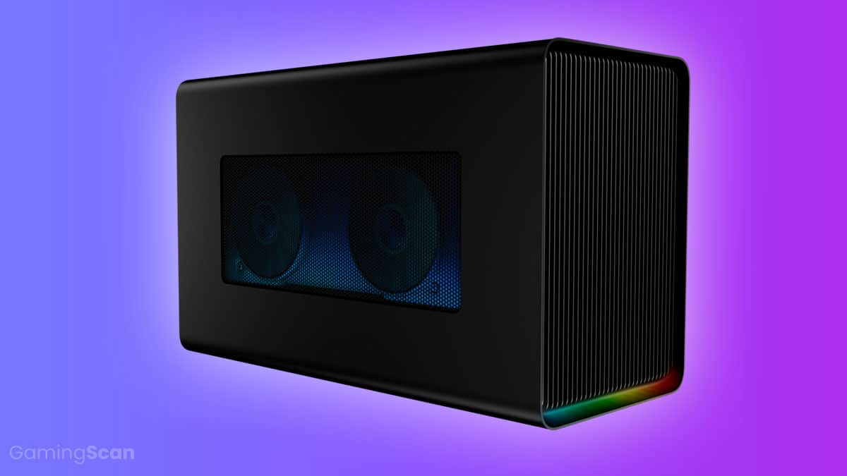

I’ve seen RTX cards external using usb-c ok that was on a MacBook but if you could do that on a laptop that would stop the bottleneck i think
It won’t resolve the CPU/RAM being near limit - just aid them in becoming maxed out without achieving any real benefit.
