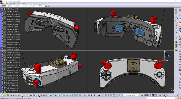

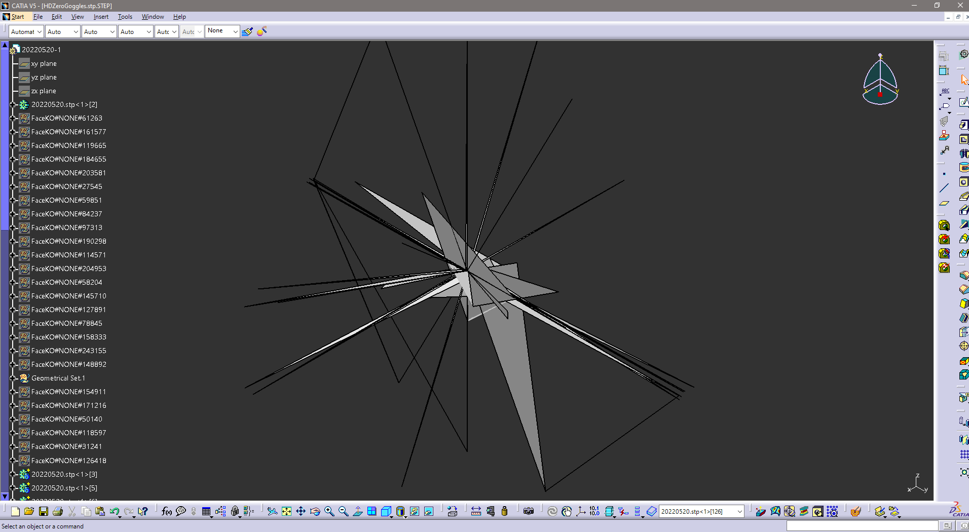

Just opened the STEP file. Hmm…
However, it is hiding in there.
Not sure I’d want to do any serious design work with it, but it’s impressive.

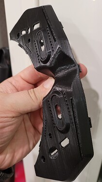

well… I finished printing the first 2 main pieces… and well… it is obvious that a redesign is needed if these are going to be 3d printed - there is just no way these .stl files will work due to the support structures needed and the very slight angles and edges.
The biggest issue is that there isn’t any large area where a 3d printer can build from due to tiny lips and slight angles… so there is a massive raft made underneath the prints to support it… but with the thin walls and delicate features on the inside, well, I’ve already broken some of it just trying to remove the generated supports.
I’m going to re-orient these and see if I can get a less troublesome angle… but I think the original cad file will need to be edited to just make this more 3d printer friendly

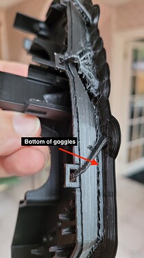

I’ve successfully printed the main bottom half of the goggle by putting it at 45º with tree supports - minimal support points (there was a lot still) but all easily removed - 12 hours to print.
The nose bridge was a key point of support, and I think that will need some tape padding to avoid any… rough rubbing.
I’ve got the top piece printing now with an estimated 14-15 hour print.
Top piece rolled off the printer - again at 45º with tree supports - more stuff to clean up, but still fairly easy to remove.
