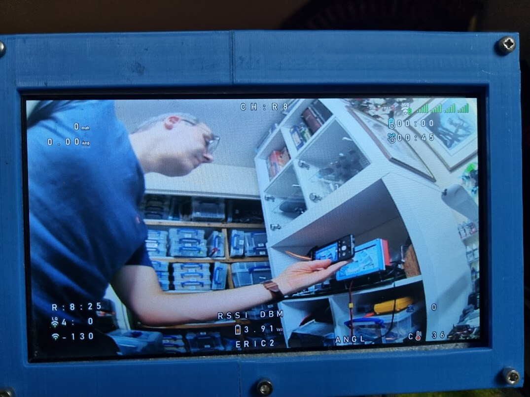

Did you lose the thermometer icon, top left, to indicate VTX overheating?
This was just the old whoop VTX. That icon is only on the Freestyle VTX… I’ll try that later today.

It’s gone from my Freestyle VTX but I’m only using the v1.0.0 at the moment, not yesterday release
I complained about this on GIT… the mismatch over version numbers is a pain in the neck. Who knows…?
It’s there now.
Doesn’t the red ‘RECORDING’ blob indicator cover it in that position? I’ll try mine again
What version are you on?
Rec is next to the signal strength on the right.

Got the thermometer back, it is in it’s usual place (top left) the icon next to my signal strength is the VRX signal strength (I think)
