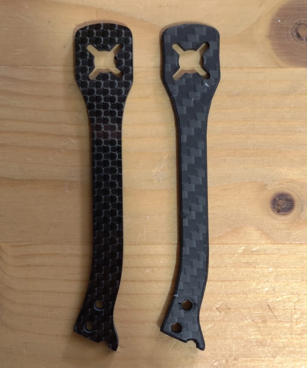

Having just bought a second hand quad to find 2 out of 4 arms delaminated before even flying and no spares in stock anywhere outside the US, I decided to try cutting my own carbon (I already own a small CNC machine but only cut wood before!). Yes the machine lives in a sealed enclosure with dust extraction.
Scanned in and traced the part in CAD and they came out really well. Photo of the new part (glossy) next to the old:

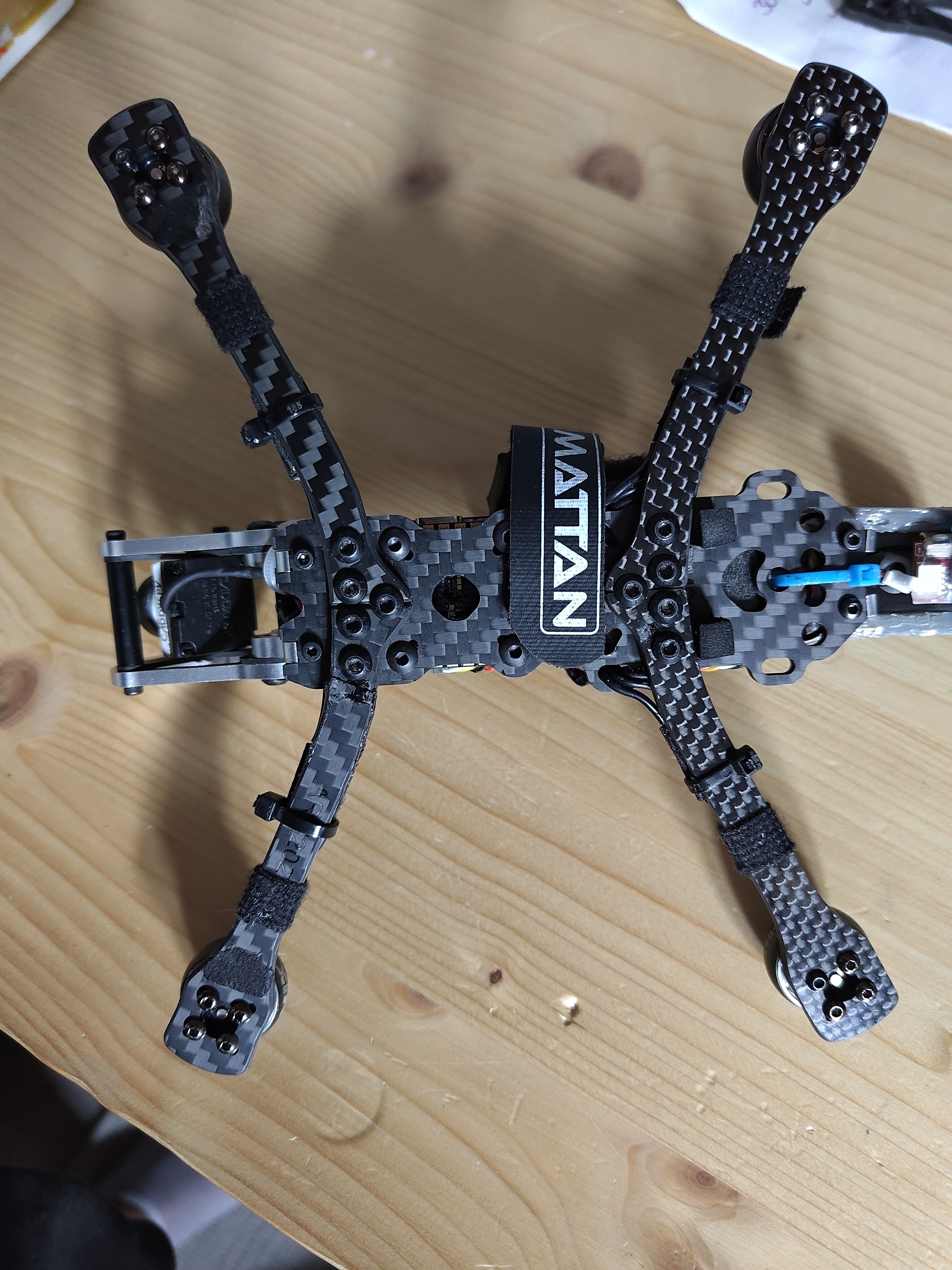

New arms fitted:
A lot less worried about crashing now I can just make a new arm in a few minutes! :laughing: So if anybody needs something specific or hard to find cut from carbon fibre sheet let me know. I may be able to help. :slightly_smiling_face:

It’s probably worth mentioning that the carbon on the original arm is oriented differently to the one you’ve cut, the idea is it’s not in a horizontal/vertical orientation to reduce the risk of snapping along the lines of the carbon. Having said that if it’s just a case of cutting a new one if it does break it’s not exactly the end of the world. I think it’s great that you’re in a position to be able to do this but just thought I’d let you know that the weave alignment is something to consider in future ones.
Fair comment and not something I had considered but certainly makes sense. Easily remedied by just rotating the CF sheet before cutting. Will bear it in mind thanks.
