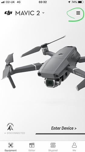

If you see the opening page on the go4 app on your phone, look in the very top right corner of the screen and you will see three horizontal bars, (highlighted in my pic). Click on that and it brings up a menu, one of which is geo zones…
Click on that and it brings up the map of all geo zones, just zoom into your location

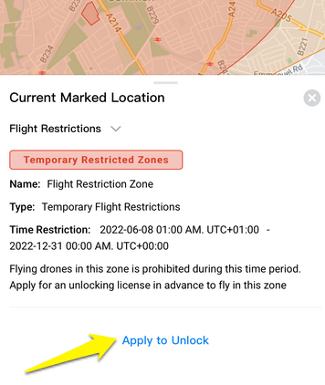

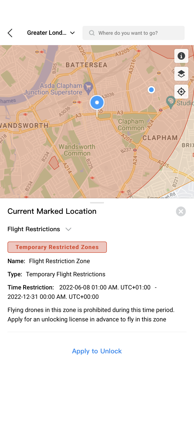

Hmm looks like I’m restarting up an old thread. I can’t get authorisation to fly in a temporary flight restriction zone that I know is not and it doesn’t look temporary any thoughts.
Which zone?
What do you mean
It seems to represent the London Heliport FRZ - which is permanent, not temporary …
As for the DJI unlocking - can’t really help. Might need to contact DJI in case they’ve set it up incorrectly. The benefits of removing DJI zones from the drone … by one of the several methods.
Restricted Zones. In these Zones, which appear red the DJI App, users will be prompted with a warning and flight is prevented. If you believe you have the authorization to operate in a Restricted Zone, please contact flysafe@dji.com or Online Unlocking.
Or this :point_down: :wink: :grinning:
I think the DJI unlock issue may be that they seem to have more than one zone superimposed on the other … and “unlocking” both might be the issue … and this new temporary one (why temporary? :man_shrugging: ) might not really be correct and hence not set up for unlocking correctly.
Yeah I don’t think they have set it up correctly the strange thing is though that I have always been able to fly here using my mavic 2 but now that I have just received my mini 3 I can’t as it’s restricted
Update: so this is really odd and I don’t really get it but if I submit a unlock request through the online system and put a / as the reason for unlock it gets approved

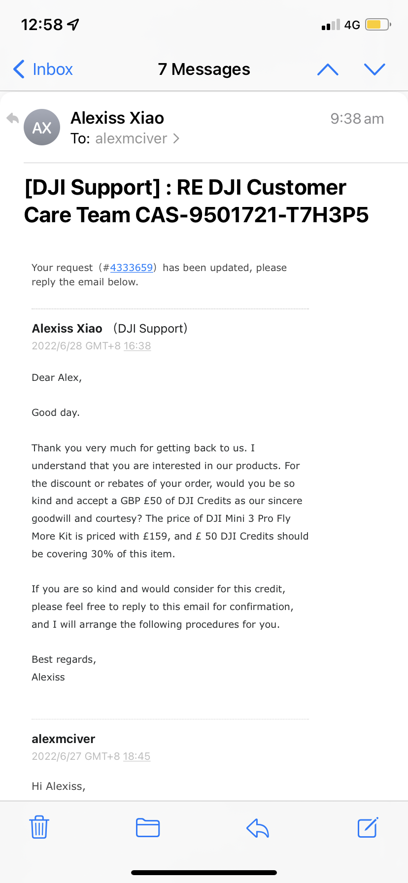

Here’s the email
I received this after DJI made a mistake with the fly zones
