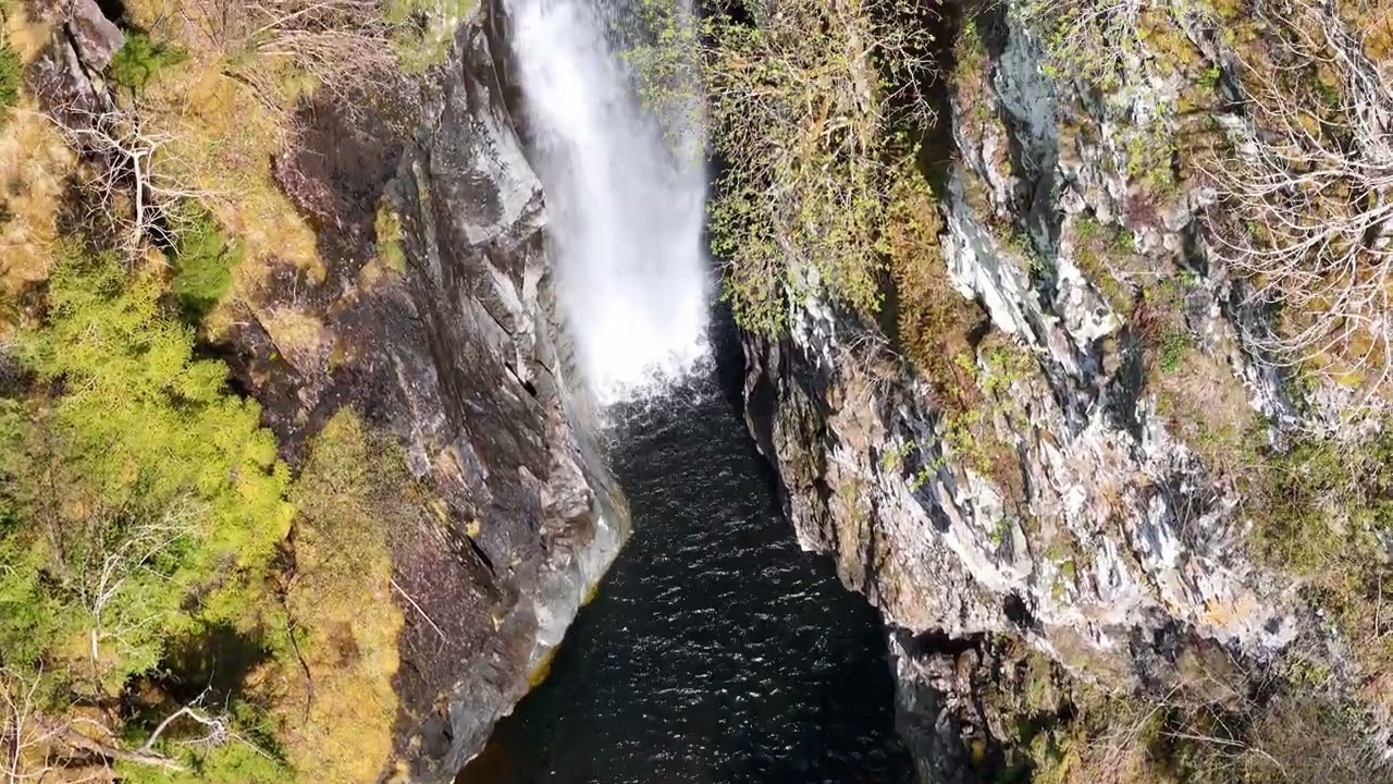

Took my AVATA 1 up to Scotland and got some great footage - still editing it atm - but some of the video has a judder or jellification to it, not sure why?
Its not on every bit of footage, nor at any one speed, but it does come and go, more so at slower speeds, so I am not sure if there is something loose or damaged - I did have a crash in a workshop a few weeks ago, but all seemed to be ok after replacing the props…
Anyhows, its on the footage at this starting point, anyone any ideas, or do I just contact DJI and ask them to sort it using Care Refresh? We are off to Skye again in 7 weeks, and I want to take the AVATA with me for flying in the Quirang and few other places…

Classic jello, FPV drones suffer from this. Usually caused by vibrations resonating through the frame into the camera.
common causes are damaged props/motors, a bent or uneven frame. Something could be loose that is causing the vibration.
Find the vibration, fix the jello. :+1:t2:

Ok, so after a thorough checkover, no issues were found, all nuts tightened - there were no loose ones, but I tweaked them up a bit - and I have removed the orange bumpers… Quick test flight and all seems to be fine…
Result… Now I need to take it out and test it properly… Hmm, where could I go and play at the weekend?
