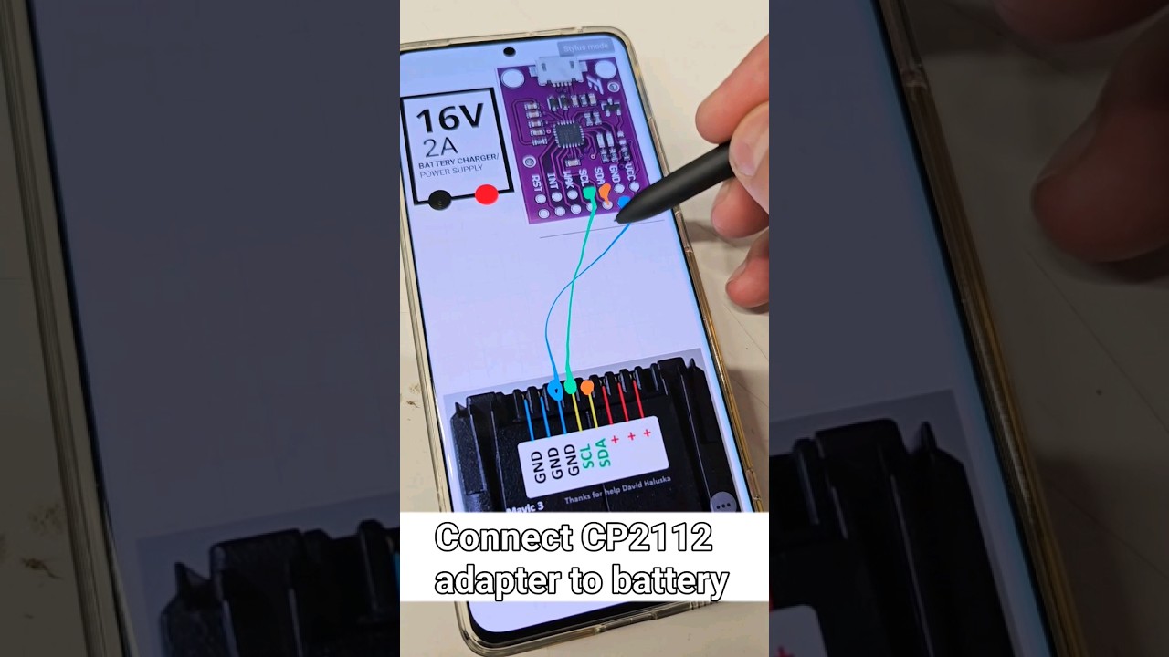

ERROR: Could not perform SMBus read 0x00
this means that there is no response from the BMS and/or the BMS is faulty and/or the battery is very low. First, try connecting the battery to the charger (you can also connect to the BMS data bus at the same time as the charger), then try reading the data from the battery again. If the data cannot be read again, then check what voltage is on each battery cell. The voltage must be at least 3.3 volts on each battery cell. If the voltage on any cell is lower, then charge the battery cells using a laboratory power supply or any suitable power source and then try reading the information from the BMS of the battery again.

Possibly if the cell voltage is to too low
No I,ve ran it on both and on Windows 7
Where are you based?
On the other side of the world in Ramona, California.
Yes, I agree it is likely the cell voltages are too low. I have 5 batteries like this. Most say you must crack the shell open to charge up some. At least one person eluded you could charge without cracking. Haven’t tried that, however.
